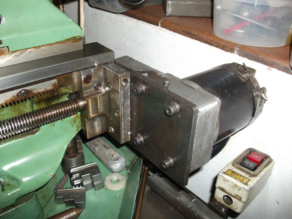

                    It was some time ago back in 2005 when i cnc'd my Myford 7,it took
                    me 4 years to cnc my Dore westbury mill and about 3 weeks to do the
                    Myford .
                    Seen here in the photo the stepper motor is mounted at the back of
                    the machine ,i made a complete new rear bracket for the lead screw with 2
                    preloaded ball races for the lead screw.
                    Rear mounting the stepper motor retains all of the functions of the manual
                    machine.
