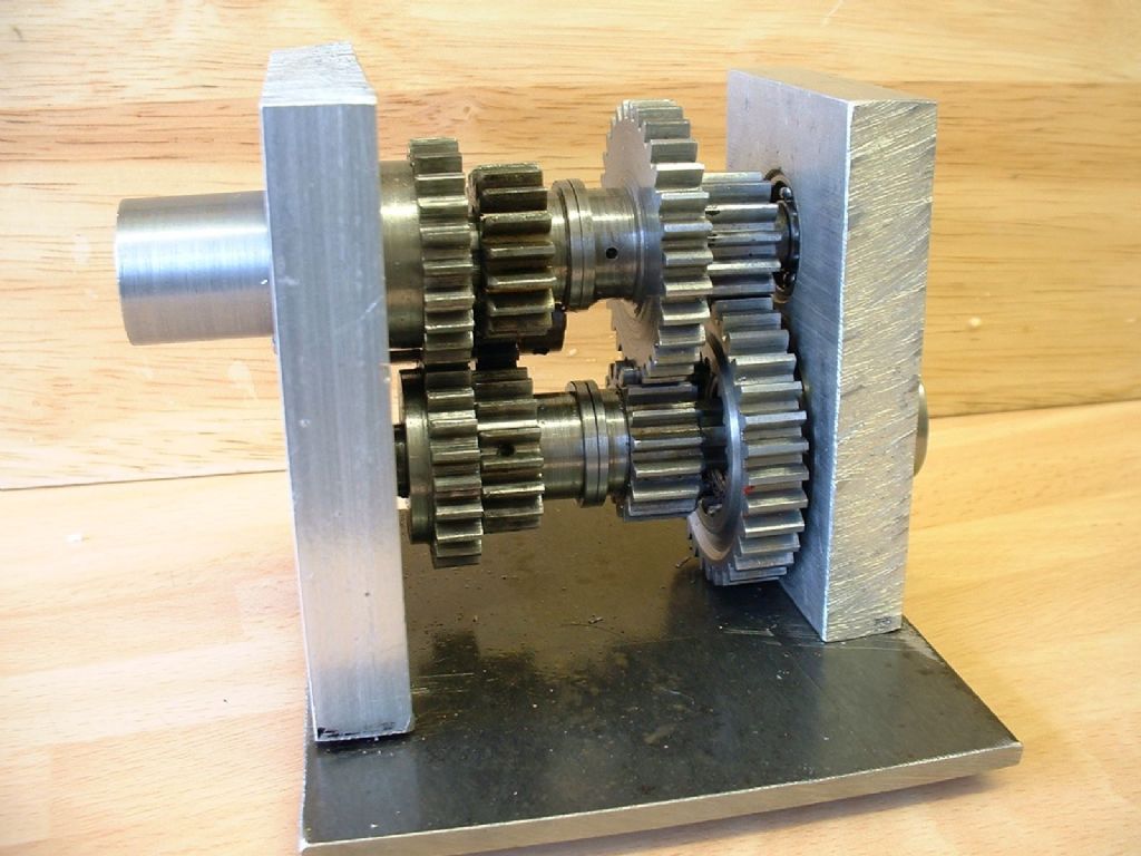

                        #104201
                        Sub Mandrel
                          @submandrel
                          Good question Andrew – how do you turn accurate splines and ensure the gear is a close fit on the shaft?
                          This is how I did it (and I had to have a good look at the gearbox to find out!) The gearbox is for a 1/4 scale Forson Model F tractor, that has never got beyond the gearbox, some patterns and a lot of dreaming and drawing.
                          I turned the gear blanks so that each has a decent boss (needed for the shifter to engage with in any case). with the boss outwards and bored right though at the diameter of the inside of the splines. I bored the boss (but not the gear (the gears are 1/4" thick, the bosses either 1/4" or 5/16" (I didn't check) over size to be a light force fit for bronze bushes made to be a close sliding fit on the gearshaft.
                          I parted off the gears and mounted them on a mandrel to cut the gears.
                          reversed them and cut the splines so that the grooves were a wider diameter than the shaft, but still smaller than the outside of the bush.
                          Finally, I inserted the bushes so they butted up against the splines. The gears now slide freely aliong the shaft using the bush as a guide on the original outside diameter of the PGMS shaft. The splines only act to stop rotation.
                          I also bushed the other gears which slide but do not have splines.
                          Internal gears (which act as dog clutches as other gears slide into them) were not cut as proper gears, just milled-out semicircular notches.
                          The layshafts run in ball races but all the gears just have PB bushes except the input and output gears which run in ball races and have.internal races for the ends of the layshafts. Layout and dimensions are as near the original as I could get, aside that I think the original may use a stub-tooth form.
                          Fordson Gearbox, right side
                          Fordson Gearbox, left side
                          Two home-cut gears for Fordson Gearbox
                          Edited By Stub Mandrel on 20/11/2012 10:41:01
