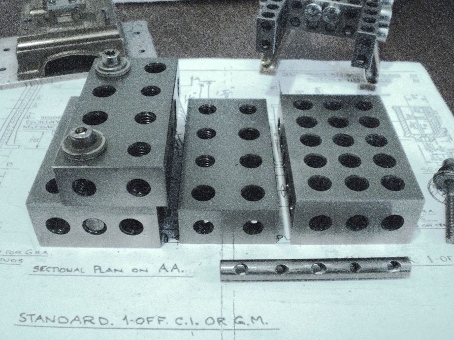

              Just put "dowel nuts" into google and you will find loads if you can't make your own. Also better choice of threads as the ones in the hardware kit are likley to be UNC.
              Or contrary to what he says you don't need to spend a fortune to get blocks that will screw together, the ARC ones are correctly drilled and tapped

                    The company's web site (which doesn't work on my computer so I had to resort to my iPad) states that the threads of the dowel nuts are 5/16 8 – 32
                    Screwfix sell Dowel nuts very reasonably (their cost for 50 is around the same as B&Q's price for five!
                    The Screwfix nuts are 10mm in diameter so they probably would NOT fit in Arc's blocks.

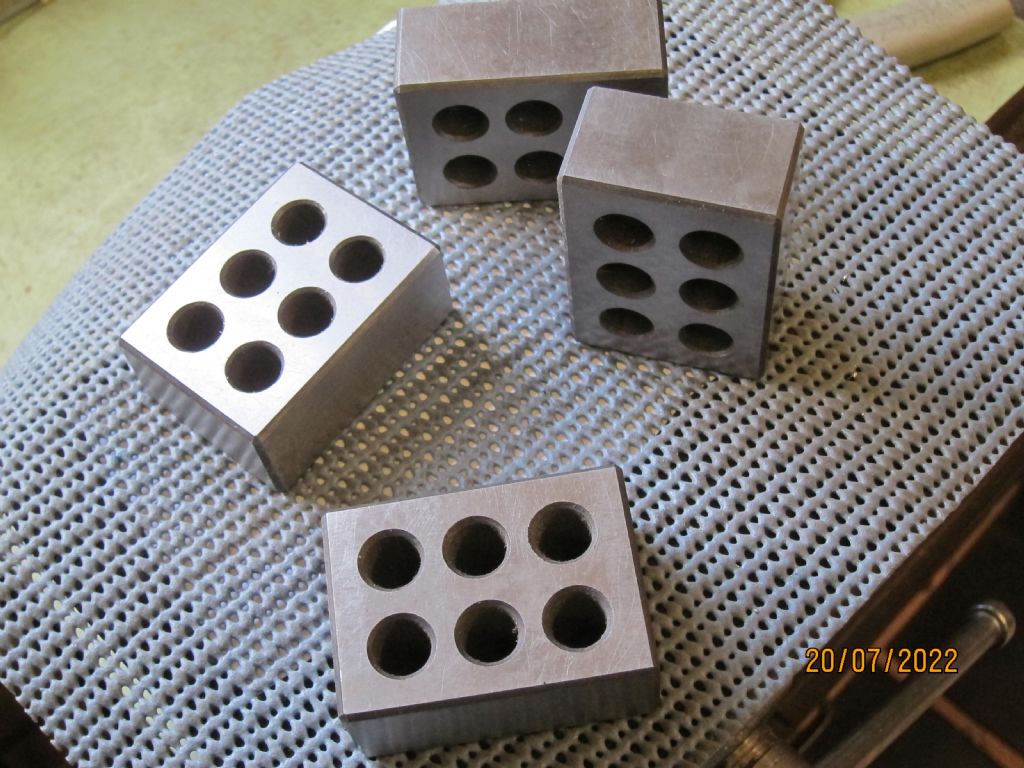

                          I have two pairs of 123 blocks in my stock which I have never had much use for largely beacuse 1) they are not obviously 1-2-3 by design (metric or imperial), 2) they only have holes drilled through from the front face and not from the edge and 3) None of the through holes are threaded. Do they have any potential use as 1-2-3 blocks?
                          #606618
                          Nicholas Farr
                            @nicholasfarr14254
                            Hi Greensands, the 1-2-3 is the ratio, they don't have to have an exact measurement of 1 2 & 3 in either metric or imperial and they don't have to have any holes in them at all, let alone be threaded, but it does help. I guess your blocks have a use for something all the same though.

                              Posted by Dr. MC Black on 20/07/2022 10:46:12:
                              You missed the point that ARC's ones are correctly drilled clearance size and tapped not drilled tapping size so bolts screw in without the need for dowel nuts
                              Just buy dowel nuts to fit 8mm OD would be closest to the 5/16" American ones and fit the larger ARC blocks, 6mm OD for the smallest

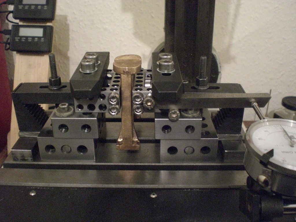

                                I made my own adapters, both barrel nut type and threaded bush type. All have a variety of threads
                                Having 246, 123 and all of Arc's offerings, i needed to be able to join various size blocks.
                                Only a few hours work, but well worthwhile!

                                    I've not yet found that the heads of cap head screws have gotten in the way so far when I have joined mine together but can see using smaller screws could be handy in which case I'd just cross drill a couple of bits of rod to suit should the need arise
                                    The expensive Starret etc ones all use 3/8" x 16 threads for screws with heads.

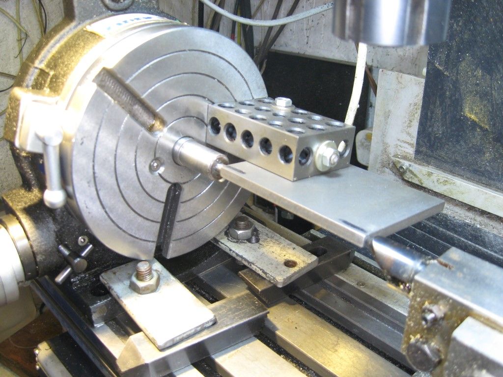

                                                  I use mine a lot but seldom screw them together so would not want to bin any of mine even if the holes were wonky. This week I have.
                                                  Used two 20-40-80 block stood to give me 100mm and then used my usual 10-20-40 block to set the height of various cutters and drill bits on the CNC relative to the 98mm ctr height of the rotary table, just enter +22mm off the 100mm stack rather than the usual 20mm off the top of the work.
                                                  Used two 1-2-3 blocks to pack a chuck that had 3 studs sticking out the back up off the mill table so it could be clamped down.
                                                  Used two 10-20-40 blocks to pack up some work that had a spigot sticking out the bottom, again so it could be clamped down to the mill table
                                                  Use two as paperweights to support a background for a photo
                                                  Used another to prop my phone up to video a bit of filing in the lathe.
                                                  And there is still Sunday to go.
