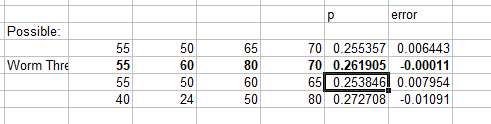

                                            The other tale of two troubles was how to turn a worm – encouraged on this thread(!) by Julie.
                                            I calculated the gearing for my Harrison L5 lathe supposedly giving a pitch within a few thou of right. Then a stock-take this afternoon revealed I don’t have 3 of those 4 change-wheels as I had thought, so back to the PC, wind up ‘Excel’ and start again.
                                            This time, I found a sensible combination even closer, using the wheels I do have!
                                            worm p = 0.2618″. leadscrew 0.25″
                                            0.25 X 55/60 X 80/70 = 0.2619″.
                                            Can’t really argue with that.
                                            This snippet gives part of the operation. The spreadsheet is not as elegant as it might be, but it works. The working is actually on another part of the page, and I copy the values to this little table which derives the error as [0.2618-(formula result)].
                                            Screenshot 2025-12-22 182539
                                            (I learnt to drive ‘Excel’, ‘Word’ and MS-Win-assorted at work, where I became quite familiar with making arithmetical spreadsheets complete with graphs, to a modest level of maths. There is nothing magic with the method here though, just plugging estimated tooth-counts from the list into the ‘Excel-ese’ version of the standard change-wheel formula, until hitting the best selection. )
