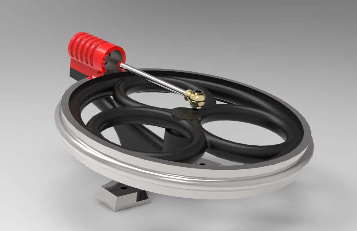

      If we take my Orbital design that Paul quite likes then that too uses thick wall tube 115 OD x 100 ID for the rim which not only allows a bit more freedom with what the spoke/hub is made from it also hides the steam passage holes that need to be drilled from the hub out to the ports and there are no worried acout casting flaws in the bright rim.
      It obviously depends on who is beholding it but to my eye a barstock one like you suggest does not look as nice as one that is a bit more shapely.

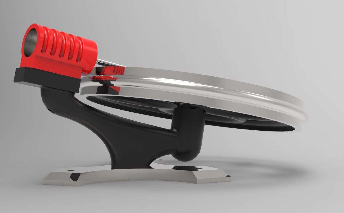

        Having said in the Orbital thread that you could not really see what was going on when it was running I had a quick play with some of the original parts and added a couple of new ones. It would need a bit more work but this could be the second offering or it may even be a better first one?
        No2A
        No2B

        paul1956
          @paul1956
          Do you think this sort of design is what model engineering novices want in kit form ?
          It seems a bit ‘out there’ to me.
          #858650

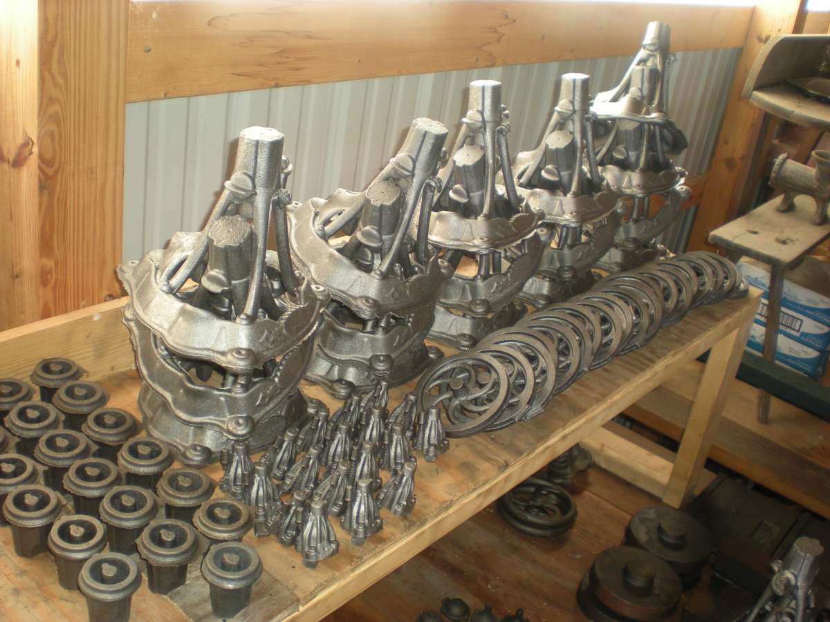

            Well I suppose that is down to the other Paul to find out. Of the models shown in this thread he liked mine and the RMC ones from Nick Rowland which are all non-traditional subjects so that would make two of us that like that sort of thing. Nicks engines were very popular when in production and fetch a premium now on the rare occasion that an unbuilt kit shows up , so there must be other people who also like that style.
            This was Nicks beginners kit that could be made with just a lathe and drill press, he also built ready to run ones in batches of 20 or so at a time
            DSCN7618 castings 12-10-2016
            Certainly there will be those who want to make a traditional steam engine like a Stuart but that market is well covered except for the metric aspect so Paul seems to be looking for a part of the market that is not catered for. I’m sure if the likes of Bohm sold material and laser/cnc cut parts in a kit then those would sell well as not everyone wants tradition.

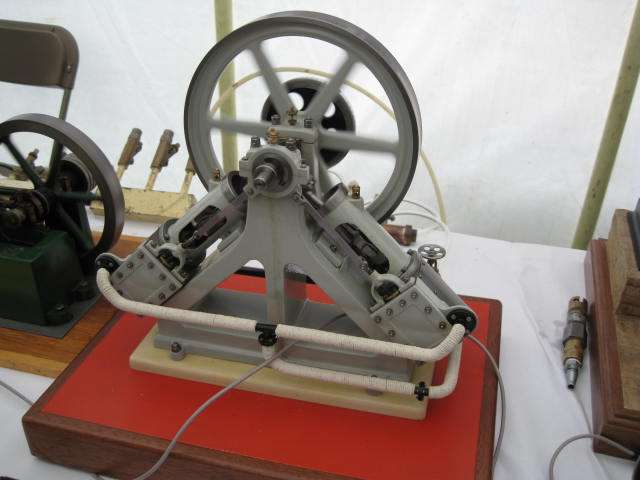

                That would be the Lang Bridge Engine that Helix Engineering did the drawings and castings for back in the 90s. and more recently sold by Brunell. It builds into a nice engine, this is by occasional visitor to the forum Ramon.
                IMG_7272[1]
                At 1/8th scale it is a managable size with a flywheel of 7 3/8″ (187mm) though maybe just a bit big for a minilathe it would fit a 210 size machine and larger. Nothing too complex that I can see on the drawings and I would put it on a par with building a Stuart Beam/Victoria, JC, etc
                There have also been barstock versions in ME over the years Morgens Klind did one and Bob Middleton another

                    That Bolton engine does indeed look like a very nice project.
                    Unfortunately, as Jason notes, 7 3/8″ is just too large a diameter for my mini-lathe.  Maximum flywheel diameter might be something worth noting by Paul for his kit.

                      #858747
                        Ches
                        It is an ideal candidate for the convesion factor that I sometimes use, that is 1/16″ = 1mm which would give a flywheel of 118mm dia, bore of 12mm and stroke of 26mm. I expect the original did not have such a small bore but teh way teh cylinders are shown on the Helix drawings does reduce the available boor as they sleeve it to allow the exhaust to flow around the cylinder, I have done similar without th eneed for a sleeve so 15 or 16mm would be possible.
