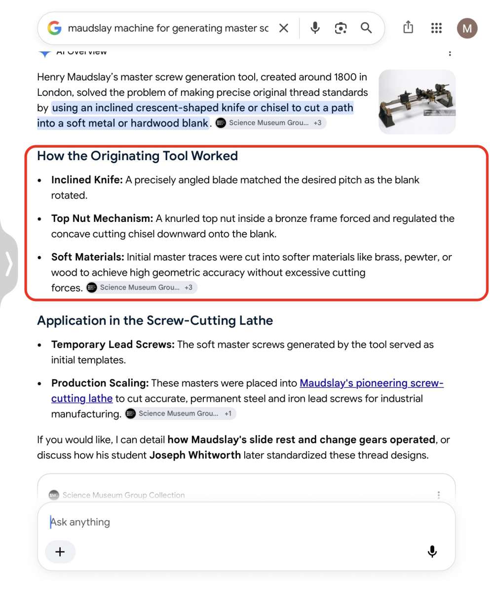

                                      #858981
                                        IMG_1898

                                          On Michael Gilligan Said:
                                          P.S. …would anyone care to explain the caption on this:
                                          https://collection.sciencemuseumgroup.org.uk/objects/co46546/machine-screw-thread-making-tool-by-henry-maudslay
                                          MichaelG:
                                          Is your point that the photo of the rotab-like exhibit is mis-captioned?

                                            #859016
                                              MichaelG:
                                              My point is that I was unable to reconcile the text with the image .. and yet [a little later] Google AI gave a broadly similar description.
                                              At first sight the device looks like a compact version of Jesse Ramsden’s circular dividing engine, but the text states otherwise.
                                              I am seeking enlightenment.
                                              #859022
                                              peak4
                                                @peak4
                                                Does this Getty photo provide any assistance?
                                                I’m not attempting to explain how it works
                                                https://www.gettyimages.co.uk/detail/news-photo/tool-for-originating-screw-threads-this-tool-was-made-by-news-photo/90742045
                                                It shows a nascent master screw thread poking out of the large hole.
                                                Just found this old thread on here, showing the same photo
                                                Linear division in early 20th century
                                                This doesn’t provide an explanation , but I still found it interesting; Opera browser’s built in translator made it readable for me
                                                https://stanki-expo.ru/novosti/tpost/pxzoib0eu1-stanok-dlya-promishlennoi-revolyutsii
                                                Bill
