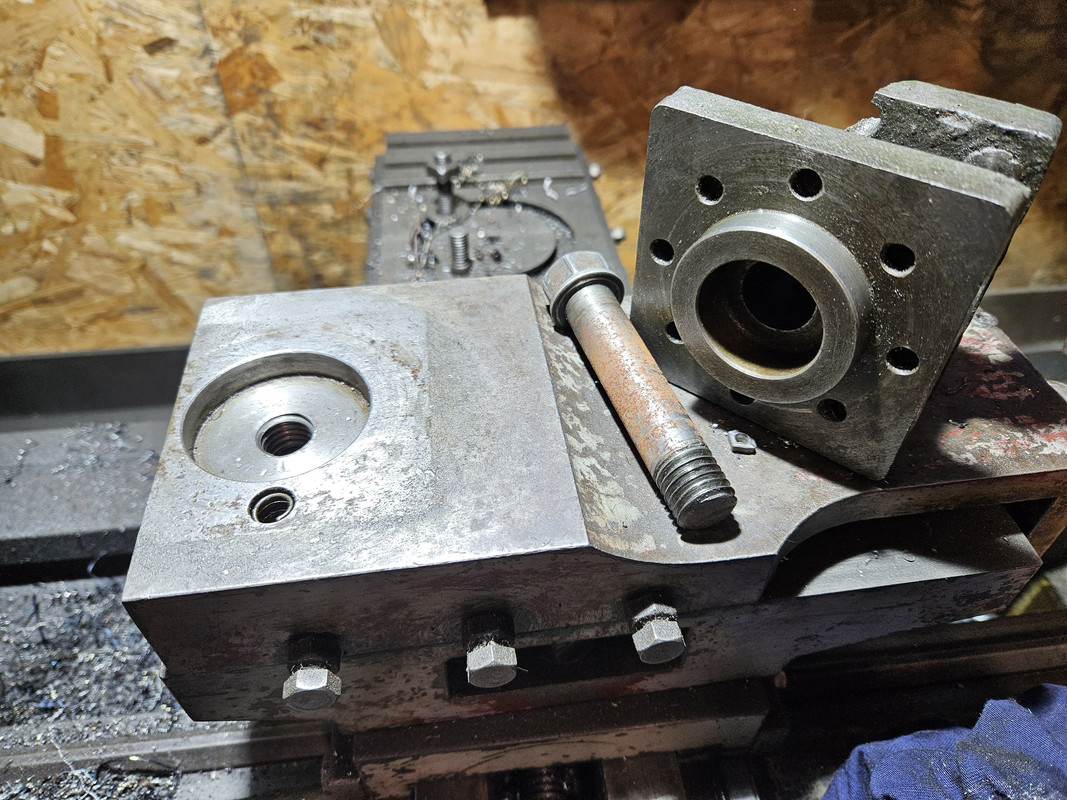

      Hi again all.
      A couple things i want to make to start off. Being a new tool post as i broke this one
      Easiest to make a copy of this one, just a billet needed.
      Or get a Hemingway kit and make a quick change one. Only thing is this is my first project. I have looked at a few other tool holders but this seems good.
      https://www.hemingwaykits.com/HK1100
      Just unsure about machining it to fit my lathe as in enough to get the the lower part that sits in the bed for the pivoting of the tool post.
      Or do i make a ring that can fix to the bottom of the Hemingway tool post?

        Hemingway kit is very good generally. As you mention ‘first project ‘ do I assume limited experience? If so, you might find the qctp a bit difficult, personally I would get the basic toolpost copied first so you can get more experience. QCTP need to be machined very accurately, if not you may end up with all manner of problems.
        For basic machining you wouldn’t normally be changing tools often anyway.

          I think i agree. Go for same holder. been reading up. I am confident with the machining, but as you say, can be difficult and i dont want to mess up with first main project.
          And i see an excuse to buy this £60 Rotary table which i will need for the bearing locator. Altough just lost the bloody ball bearing.
          So £20 for a billet for the tool post and then £60 for the Rotary table. not bad to get two bits in one.

                    For the time being I would remove the broken setscrew and replace and then use the 2 sides you have for now, plan B would be to make a new steel top. The missing ball can be easily replaced, any bearing specialist keeps them, might even give you one. Good luck. Noel.
