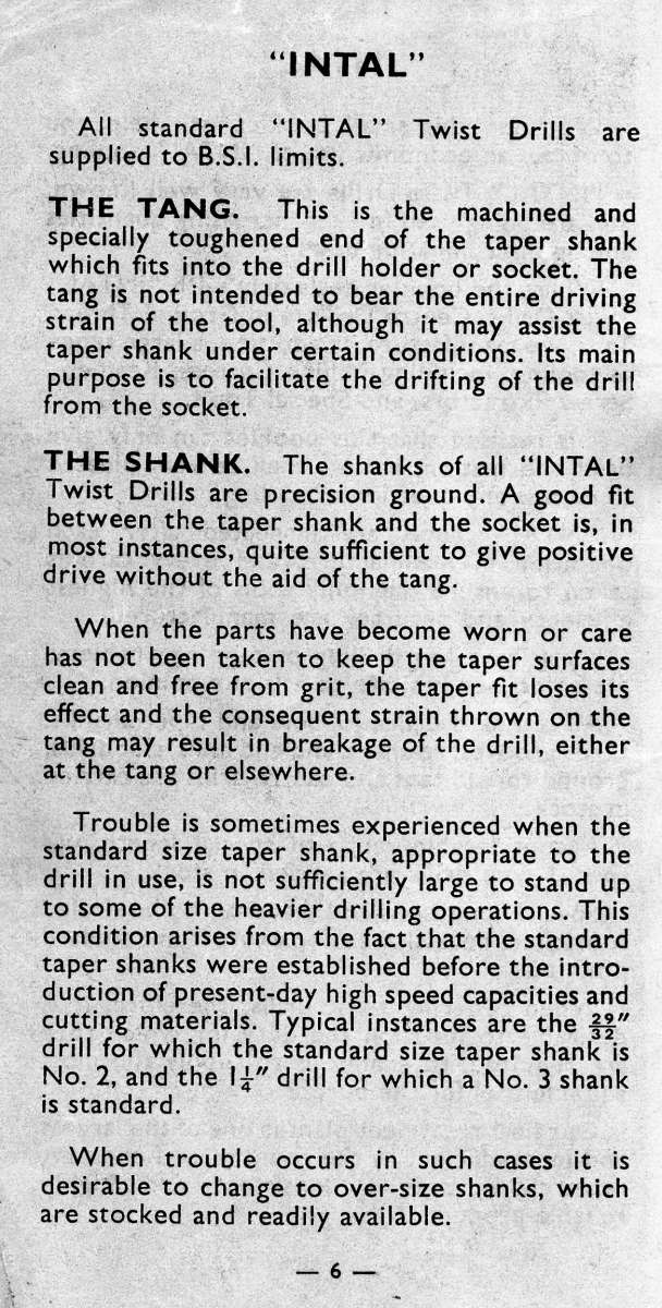

                Hi, I guess this argument could go on forever, in the Presto Counsellor booklet, it says “The tang is for ejection purposes only. Allowing torque to be taken by the tang will result in breakage” paragraph 4 page 22. However, below is a scan from my INTAL information booklet, (The International Twist Drill Co. Ltd.), which might be a compromise, to this saga.
                INTAL
                Regards Nick.
