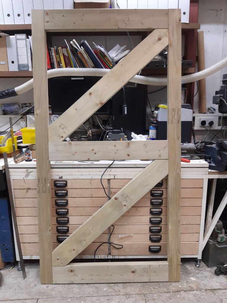

          SWMBO has ordered me to make a new garden gate after its predecessor lasted less than 25 years.
          I'm ashamed to say that I spent some of today cutting tennons in allegedly 150x47mm C24 timber on the milling machine. Mortices will be cut when the 16mm long series cutter arrives from Ketan at Arc Eurotrate…

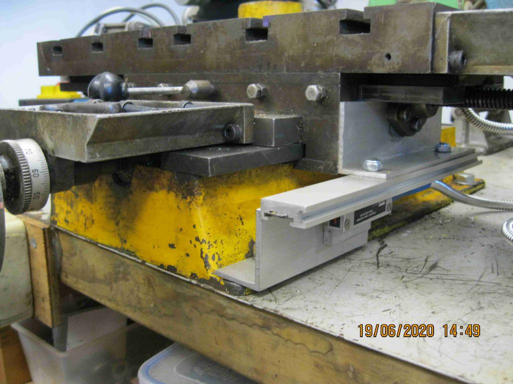

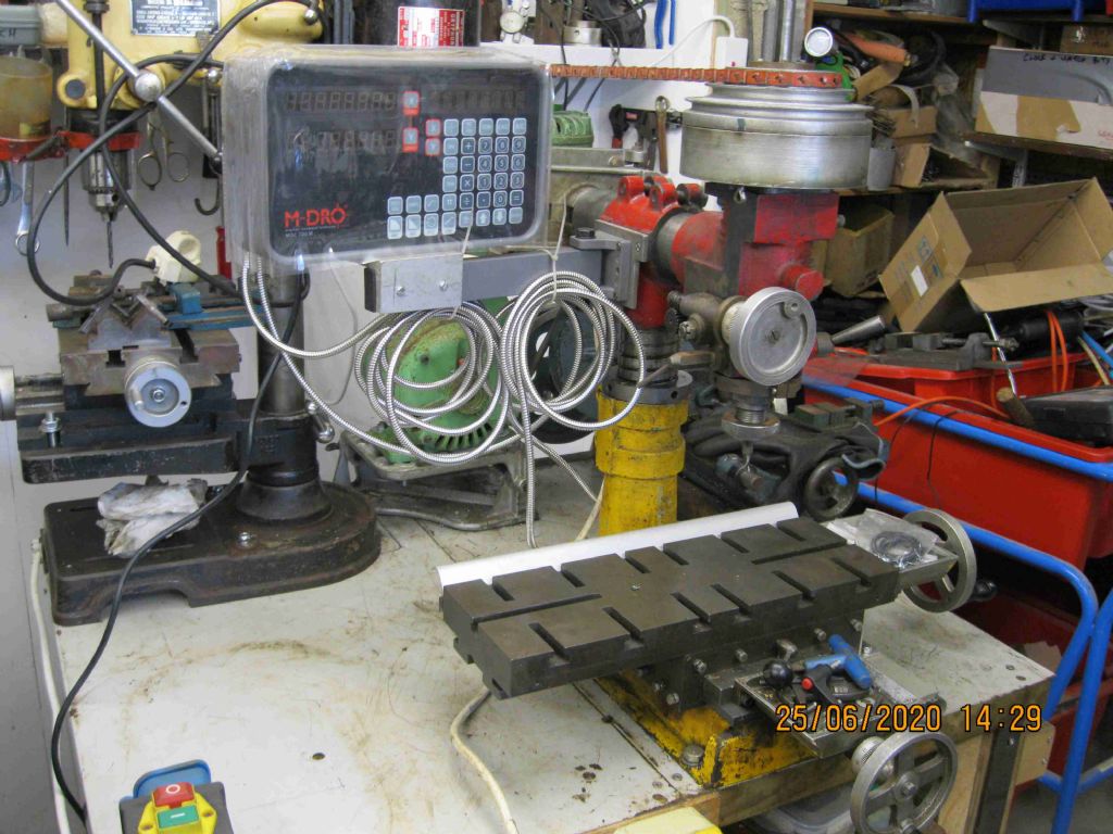

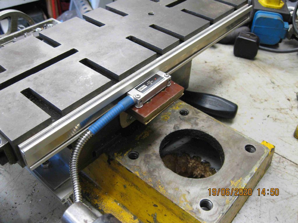

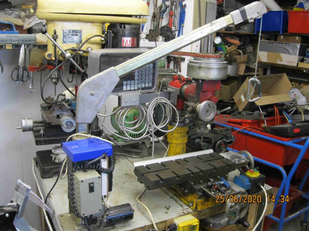

                Definitely not today, but over much too long a period, finally fitted a 2 axis DRO to my D-W mill. Thanks are due to all the members who provided hints, tips and suggestions plus the customer support at Allendale for sorting the digital bit! I'm posting a couple of pics which, if you can ignore the crap workmanship, may be useful for other D-W owners. The last pic is of the repair to the motor/head support tbe which was broken and which several members offered suggestions for repair. For logistical (proximity) reasons, I tool Pgk's advice and went agri-engineer. The repair has been deliberately left 'as-is' on mutual agreement that it would probably be stronger and the 'looks' suit my 'style'!!blush
                Thanks to all who helped.

                        Low precision machining and fitting of non-isotropic material has proceeded nicely in the shed. Tomorrow I hope to weld it together,,,

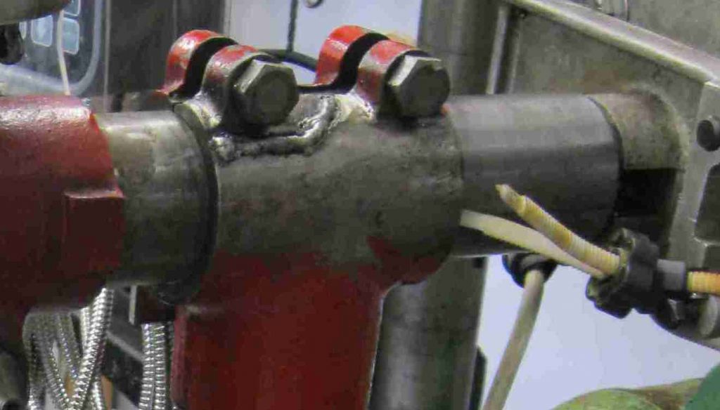

                          Bill,
                          One of the photos about your DRO installation has a small crane for lifting jobs onto the mill. Can you please post some details about it. (About a month or so ago there was some posts about lifting devices in the workshop)

                            Hi Paul – thanks for the query. The 'crane' started life as a mobility scooter or wheelchair car lift. Capacity about 160 kgs? I bought the basic, non-working motor, base and jib. It's mounted on a 6 mm steel rectangular tube welded to a 170mm, 6mm thick sqare base plate. I 'fixed' the motor and wired in a vari-speed RS transformer to give the 12volt power. The jib is about 50mm long, slightly extendable and swings through 270 degrees. I use g-clamps to secure it so that I can use it on other caster-based benches. I'll take a few more piccies and put them up here.
                            Let me know if any further needed.

                                Too late now to edit my post re. the 'crane' but, as no doubt realised, the quoted jib length of 50mm should have been 50 cm!! … (Bloody new-fangled meaurements! What was wrong with the groat and bushel?)

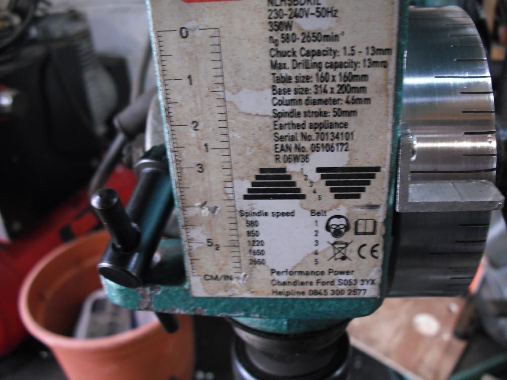

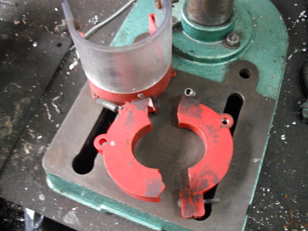

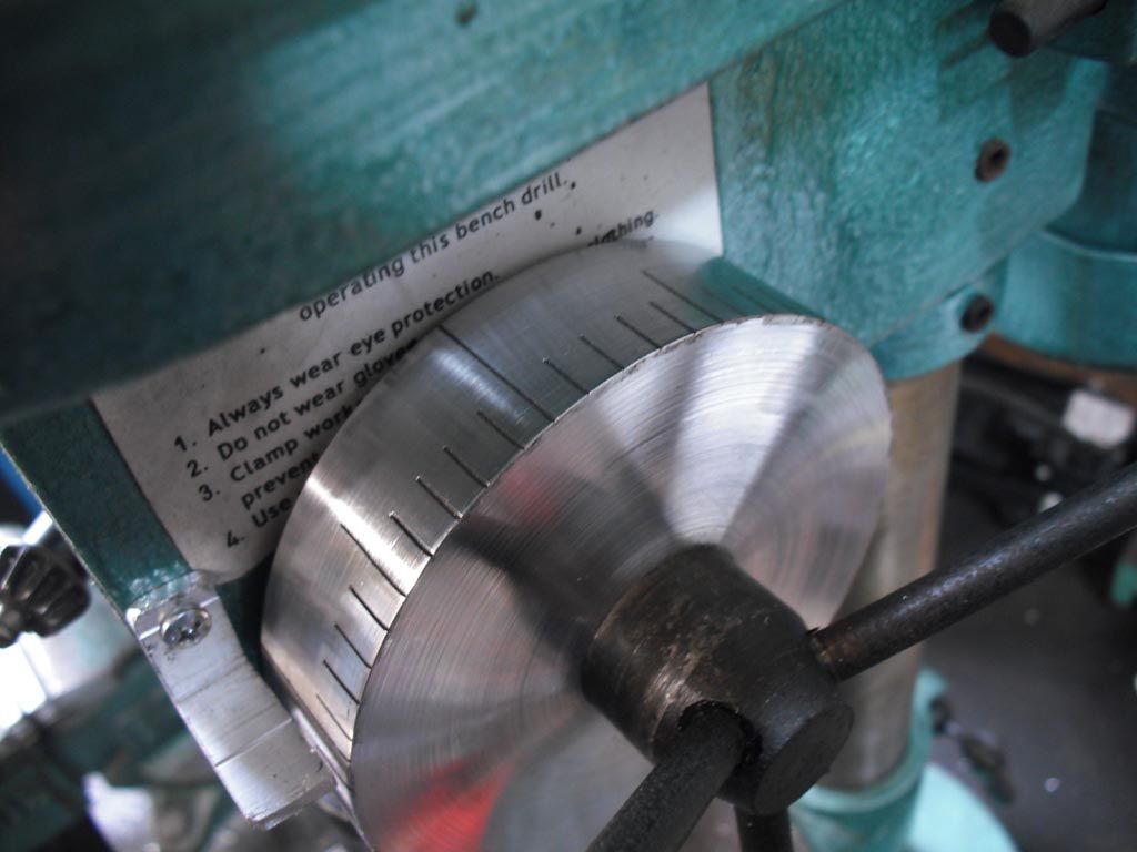

                                  Yesterday the guard on my bench pillar drill finally disintergrated. I has been a PIA for sometime, constantly coming loose and to be honest, was more dangerous than not having one.guard_broke.jpg
                                  It also supported a primitive depth gauge/stop. (those of you with a similar model drill will know what I mean). I decided not to re-instate this as the hole it was in makes a convenient chuck key storage point.
                                  I decided that I would make a large graduated wheel to fit the operating spindle and finally finished and fitted it this morning. I do have some 2.5mm number punches, so the next job is to make a jig to accurately mark the dial. I will have to check how they perform on a curved surface first. It is perfectly useable as it is.

                                    Hi Anthony, I've got the same model, but different "badge" don't use it much now, but looks as if you've gone the right way forward, very good.
