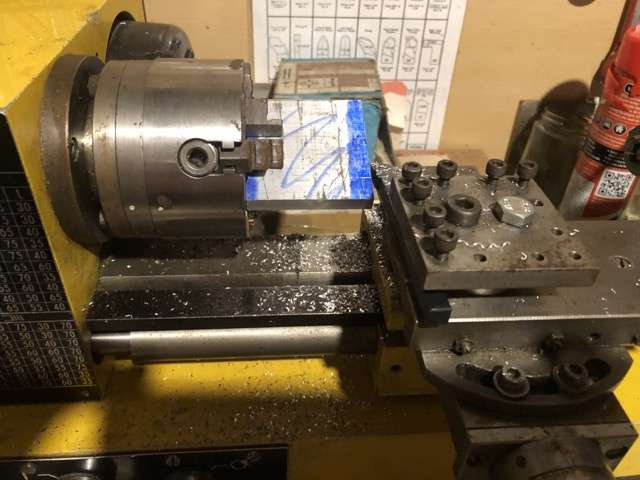

      Anyway – with various bits of 6082T6 aluminium from Droitwitch Aluminim I’ve started with the basics of milling some flat plate, to make the baseplate and side plates which will support the crank; and against which the ‘cylinder head’ will bolt.
      Just this has been a learning curve in terms of mounting on the mill table and in the vice; and how hard it is to manually mark out with full accuracy to the nearest thou’ whilst using a vernier caliper and a small t-square… It’s clear I need to adjust some of my expectations – which I ‘expect’ I will do is not necessarily the same as what I ‘will’ do!

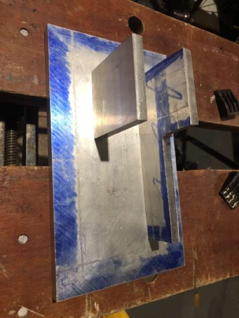

                            A couple of photos to show the (limited!) progress so far.
                            1) the base and side plates I have cut so far, none are to the finished dimensions yet but this does show roughly how they will be laid out. IMG_4472 Medium
                            <p style=”text-align: left;”>2) The rough cuts for the 10mm and 8mm plate I’ve done with a Bosch jigsaw (with an aluminium specific blade) and until today all the fine trimming had been on the mill at my model engineering club. At home I just have hand tools, and a small Hobbymat lathe. But I thought I’d try mounting up the smaller side plate in my lathe and see if I could square off one of the edges which I hadn’t milled yet. I ended up doing both and they are pretty square. The finish across the faces is consistent to  within 0.08mm so not bad I guess but not as good as the milled faces (which are within 0.02)…</p>
                            IMG_4471 Medium
                            Advice on how to clean up / polish the surfaces much appreciated!!

                              If you’ll pardon me saying so that’s not an ideal set-up in terms of the size/thickness ratio of the aluminium – too much unsupported metal at the working edges..
                              – a better way would be to clamp the metal on the cross-slide at a suitable height and mill the edges with a fly-cutter or small face mill mounted in the (2MT) headstock spindle.
                              Hobbymat used to supply a T-slotted boring table / ‘pallet’ to fit on the cross-slide for this purpose – I can dig mine out later and measure up..
                              Cleaning up the surfaces of the plates can be done by working down through grades of wet/dry paper, with a sander or with paper taped to a ‘flat’ surface, if that is what’s required – be sure to remove all scratches and blemishes left from the previous sheet before going down to the next..
                              #828357
                                Although not the ideal setup there are two ways you could improve the finish so it needs little or no clean up.
                                1. It looks like you are using a a general puropse insert which typically have a golden colour. Change to an insert meant specifically for non ferrous metals which are bright and polished.
                                2. Use a small amount of cutting lubricant in the form of paraffin or WD40, this will stop th emetal sticking tho the insert and allow it to cut cleanly.
                                At the moment I would leave any polishing until the engine has been tested. When all is running then yoy can bling it up as you which. To start with a fine file and “drawfiling” will remove the machining marks far quicker than abrasives. To do this you hold the file across the edge of the work but move it along the edge. Make sure not to rock the file and round over flat surfaces and you can also rub chalk onto the file to stop bits of metal sticking to it which can gauge the surface. You can then wrap some emery around the file and work down to the grit you want.

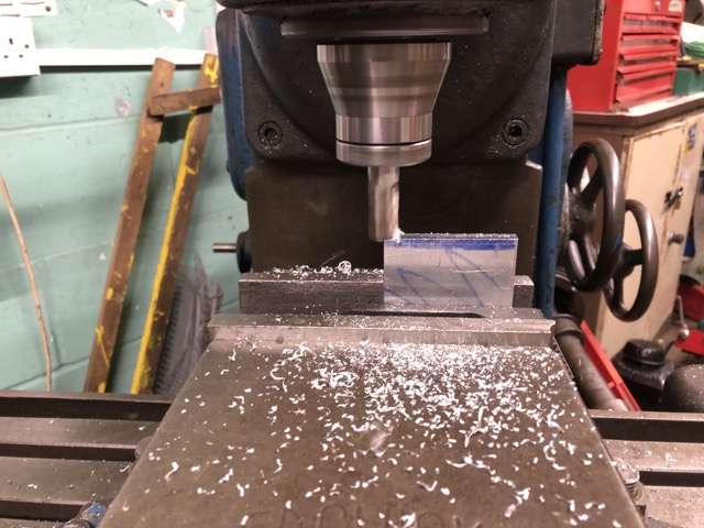

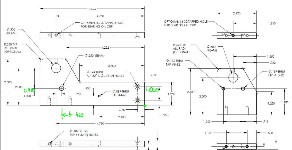

                                            Thanks for the guidance everyone. It occurred to me I could consider the width of a nut to try and gauge how much width of material I need for a given tapped hole size. Looking up M4 I see a nut is 7mm across the flats so assume I should be confident tapping an M4 into the side of an 8mm thick piece of plate (as long as I am in the middle!).
                                            Yesterday evening I was back on the mill at the club workshop and the smaller of the two side plates is to  dimensions I am happy with.
                                            IMG_4476 Medium
                                            Attempts to square up the longer, L shaped, side plate were less successful. I had it clamped horizontally in the vice but think I have failed to clean the vice properly and introduced so swarf that pushed it slightly off square. Next time I’ll clamp the workpiece to the table and clock it with my DTI to see if I can do better.
                                            Various taps and drills are on the way from eBay but I need to get some sort of edge finder so I can try plotting out my holes on the mill as discussed above.

                                              As you have found out, always clean the vice surfaces including the one any parallels sit on. As well as deburr any cut edges before reorientating a piece.
                                              Yes as a novice myself I learnt the hard way so now do both of these things as a matter of habit. An paint brush is handy to remove the bulk and a paper towel for a quick wipe over.

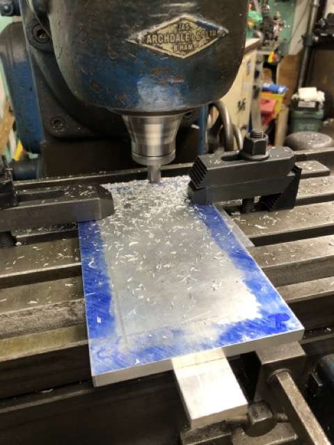

                                                Managed to get the baseplate milled down to size this Friday evening, before a bit of a disaster…
                                                First up, I clamped the baseplate to the table and was shown the technique of using a square to align the workpiece off the vertical face of the mill. Then I took off close to 300 thou to get down to the right dimension, using the power feed and the moveable end stops to save lots of winding the table.
                                                IMG_4487 Medium

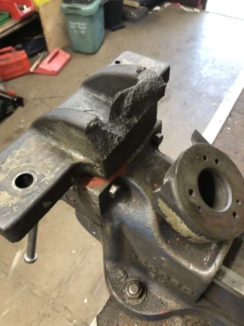

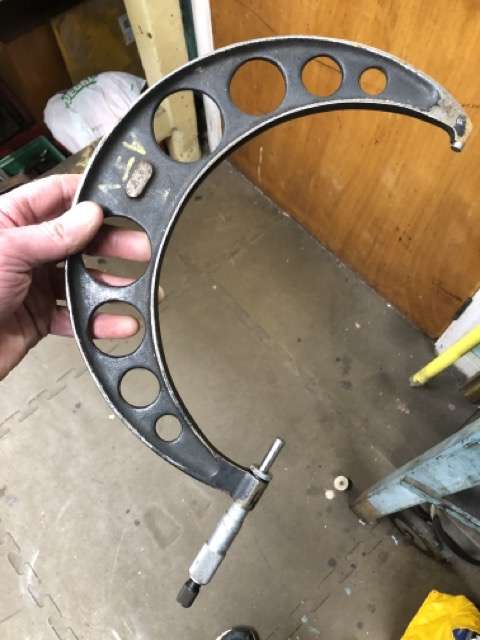

                                                I’d picked up a 8-9” vernier caliper for only a few pounds at one of the club auctions at the start of the year, so finally got to put it to use.
                                                IMG_4488 Medium
                                                Next time I’ll definitely be less cautious with the rough cutting I do (I used my jigsaw, with an alu specific blade) and clearly left a much greater room for error than needed.
                                                This done I then mounted the longer of the slide plates to see if I could mill the end squarer. Measuring up showed me I had about 6 thou to play with before I started to go undersize, so I setup the piece as before and started with a very light cut, again using the power feed. Concentrating on the depth of cut being taken this is where it all went wrong, I ran the mill table into the knee and jammed everything solid. The hand wheel hangs from the table on a cast iron bracket and it was tight up against the body of the mill, with a crack evident…
                                                The other club members present on Friday tried to free things up,  this Sunday morning we were successful in getting things disassembled. Thankfully it looks like a taper pin in the power feed drive snapped, saving the power feed gears. It was apparent the crack I’d opened up was an old one, but whilst stripping the casting down (it needed repairing regardless so a brass bush had to be driven out ) it cracked completely. So I am now putting out feelers for somewhere local that can repair broken cast iron!

                                                  Your clamp studs on the plate will work a lot better if the studs are closer to the workpiece, more pressure on the workpiece for less spanner torque. Hope this helps.
