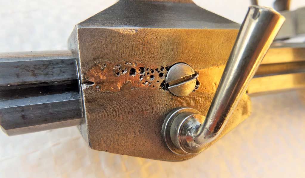

        I am getting on OK with my new AC/DC tig machine from RTech but really only on mild steel angle and flat bar in the 3-5mm thickness. Practice does seem to be the key here!
        I have successfully built up a chipped corner of a Cast Iron vice with SiBronze brazing and repaired a small watchmakers lathe in a similar fashion. Neither looked that pretty but they came out OK after machining. Both items showed porosity which I suspect was from the carbon in the cast iron and the fact that it was difficult to get the joint REALLY clean.
        Also with SiF one is not supposed to melt the cast only the rod; I found this really difficult when striking the arc as can be seen at the RHS of the joint.
        Very difficult to guess the current also, this was at 85A with 2.4 tungsten and 1.6mm rod. Perhaps should have been less with such a small part?
        Quite surprised at how quickly the Argon goes down even with only a 5sec post flow. Another expense to be costed in at £50 a pop from Hobbyweld!
