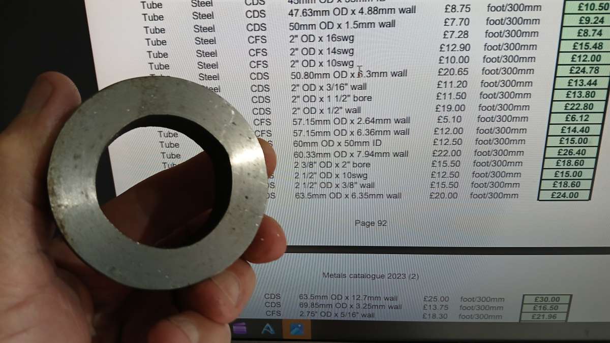

      I have some machined castings for a ‘Potts type’ milling spindle, minus the column. Everything else is there including the spindle cartridge and other bits of hardware etc.
      I would like to get it up and running, but I need to make a column for ir. It needs to be 45mm O/D and either tube, or solid bar drilled through.
      I have some 44.5mm mild steel tube with a 3.5mm wall, which would be perfect, but it’s just a shade sloppy with the fit. It needs to be a good sliding fit in the cast iron part that clamps around it (that part that the angle-adjustable spindle holder can be attached to) so I think 45mm would be ideal. The part mentioned above has a keyseat already machined into the bore, so my idea was to attach a key to the new column, rather than milling a keyseat in the column as well, which would be difficult as I don’t have a milling machine. (I can mill in my lathe but it wouldn’t have the necessary capacity).
      My question is, what is the best material to use for this column?
      I have a material stockist very local to me (M-Machine is 10 miles away).
      Thanks
      Stew.

        If M-Machine is close to you, ask them if they have stock of 45 mm dia centreless ground carbon steel shafting.
        Ask them what dimensional limit it is produced to – ie h6 or h7 is common.
        Better than just using ordinary bright drawn bar.
        I wouldn’t drill it through, possible risk of distortion if it’s for a machine tool application.

                    Can’t really see any need to lighten it. If it were needed then just start with a bit of thick wall seamless tube, M-Machine has plenty of choice. I’ve used that several times and even turning OD and ID to final size not seen any movement

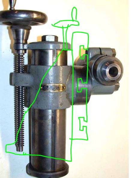

                      I thought they have a location groove down the side of the column, so would need really thick tube.
                      Is the design still copyright or patent? Would have expected castings to be still available from one of our regular suppliers. Sure it would be popular.

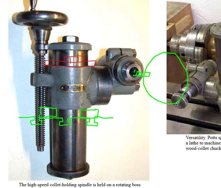

                        Once I purchase some suitable material for the new column, I was going to simply screw on a long key to the column. This key would then sit into the existing keyway that is cut into the casting that goes around the column. (The part that moves up and down the Y axis). This would save me the hassle of cutting a keyseat into my new column, and I can then keep the internal diameter a little thinner. Can anyone check me on this and suggest why this method wouldn’t work well? I understand the need for mass and rigidity though.
                        I’ve also seen versions where the casting has a short key the width of the casting screwed into the keyway in the casting, and this then slides in a keyseat in the column. It seems there are a few ways of skinning this particular cat. All it’s doing is stopping the casting from rotating, and keeping it aligned in the Y axis.

                            <p style=”text-align: left;”>A bit of mild steel should do the job for the column. It is not under super high stress.</p>
                             Key screwed onto the column might not be rigid enough under side loading though. It would put all the load onto the small mounting screws which by nature will have clearance in their holes. Maybe some dowel pins for location might help, maybe. And concave radius the key to sit firmly on the column.
                            It really would be better to mill the proper keyway though. Could be done clamped to the cross slide with a slot drill held in the lathe chuck. I  do a lot of milling like that quite successfully.

                              That is why I said thick wall tube
                              2″ OD x 1/2″ wall would still leave about 9mm wall once the OD had been turned and the keyway is only 1/8 or 5/32 by the looks of things so only half that depth for the keyway. This sort of stuff

                                Yes that’s thick walled! I think the original idea was a triangular groove keyway so the key can be arranged to be pushed in for positive lock on both sides against turning.

                                  Just looks like a regular rectangular one to my eye
                                  https://www.lathes.co.uk/potts/

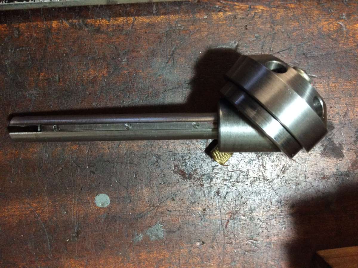

                                      Stewart if you look carefully on the lathes site there is one with the screwed on key you can see the screws in the picture its the one after the red one.

                                        Hi. Yes, I didn’t notice that. I think it may still be sunk into a keyseat though, and the screws are just holding it in place.

                                          You could well be right I did that on my tailstock turret for a taig and seems to work well.The key slot was done on the aforementioned cross drilling jig.IMG_3997

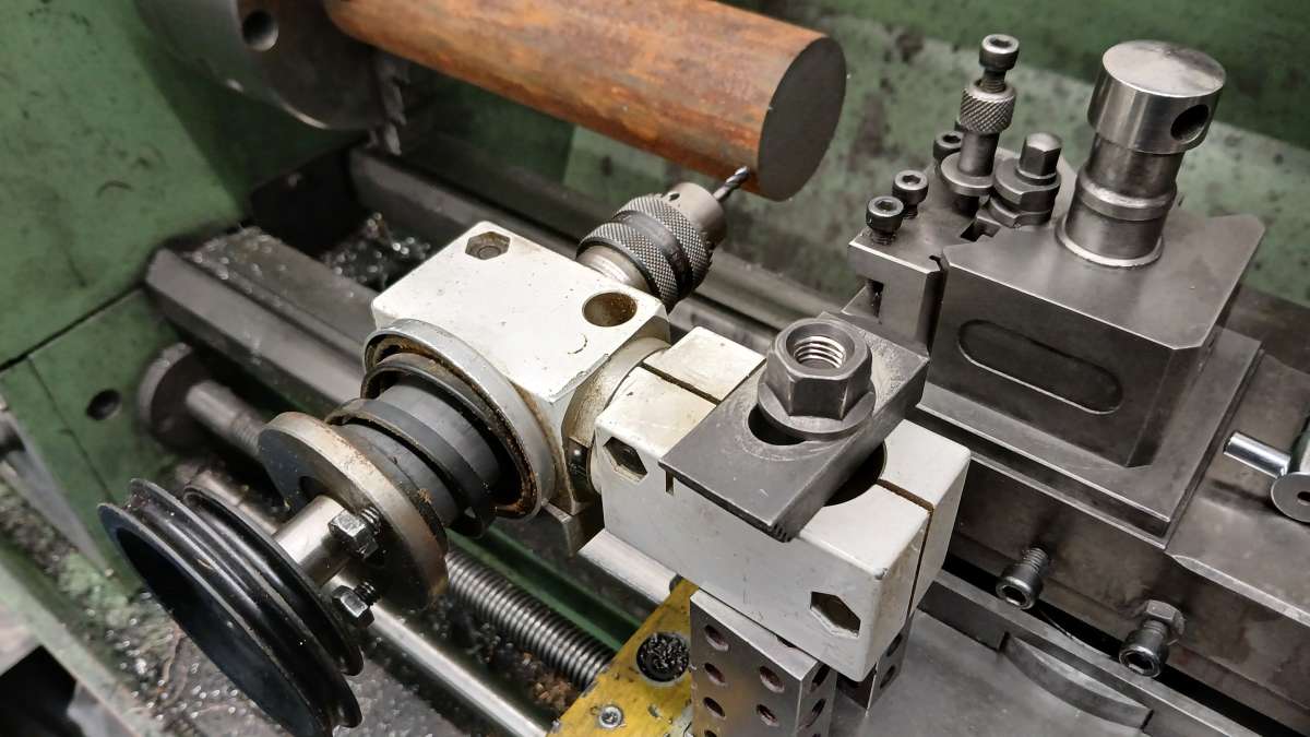

                                                I just mocked this up while the kettle was boiling. The Unimat 3 head usually mounts on a 28mm column but with some blocks packing it up and a bolt through the middle down to a tee slot it is set up to mill a slot along a length of bar.
