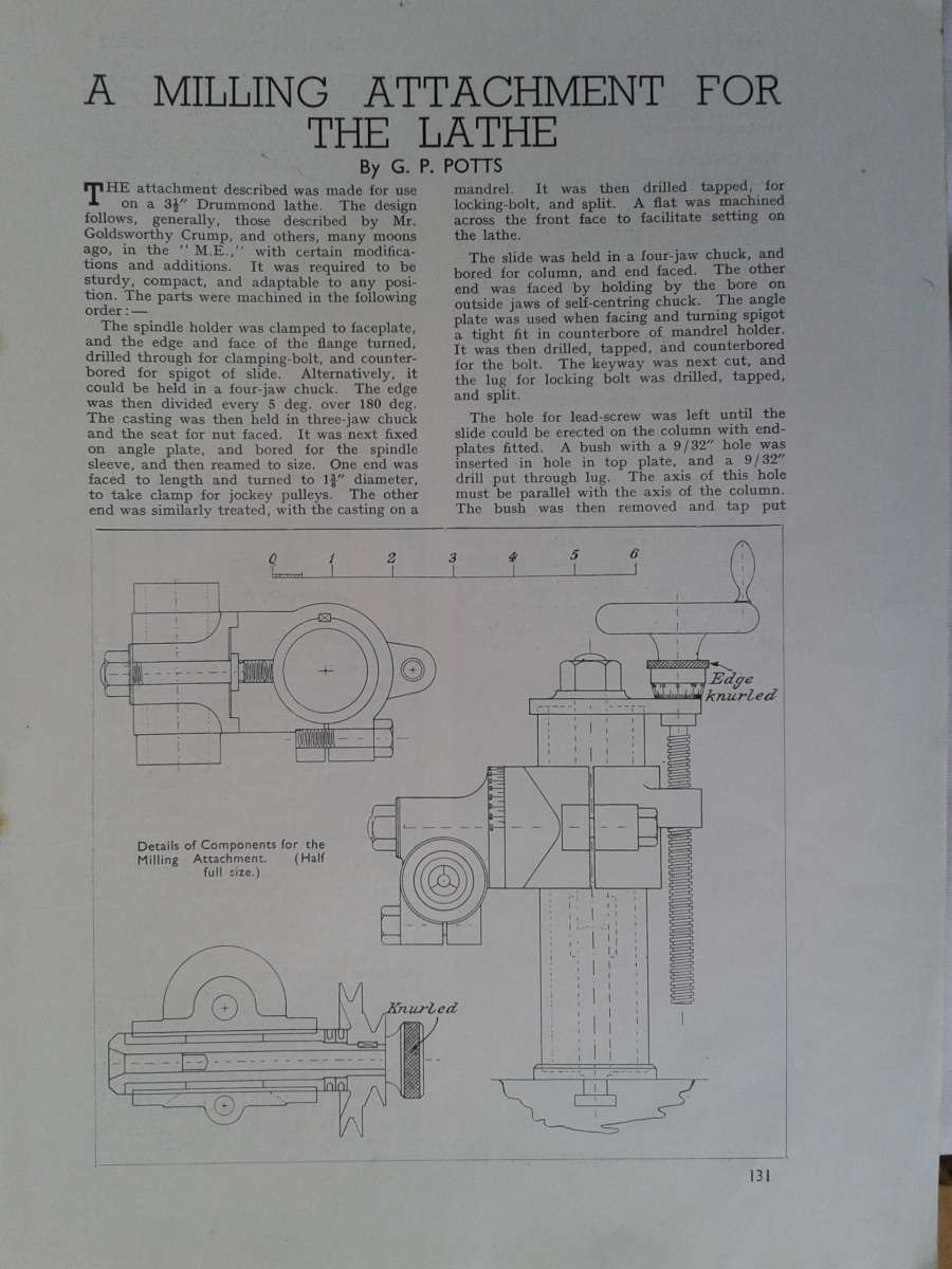

              I did some drawings from the potts drawings, one of which the column casting is included here. May be of interest to you. I also have a similar drawing of the spindle casting.
              Jason the castings are still available. I don’t have my patterns no more, but I know where they are and the chap who has them was and probably still is doing trips to a local foundry.
              Geoff ………. sorry Stew drawings are pdf and can’t be uploaded, p.m. me if you would like copies.

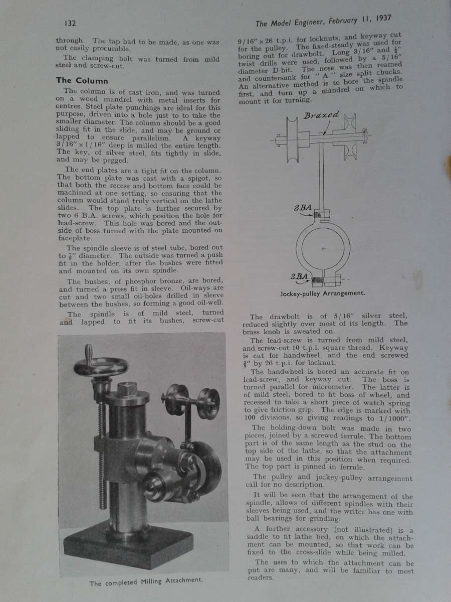

                    In the meantime after much searching I found some jpeg images of the 1937 Potts article.
                    Just two pages, but lots of info which I’m sure will be of interest.
                    Simple design really.
                    Geoffpotts article2potts article
