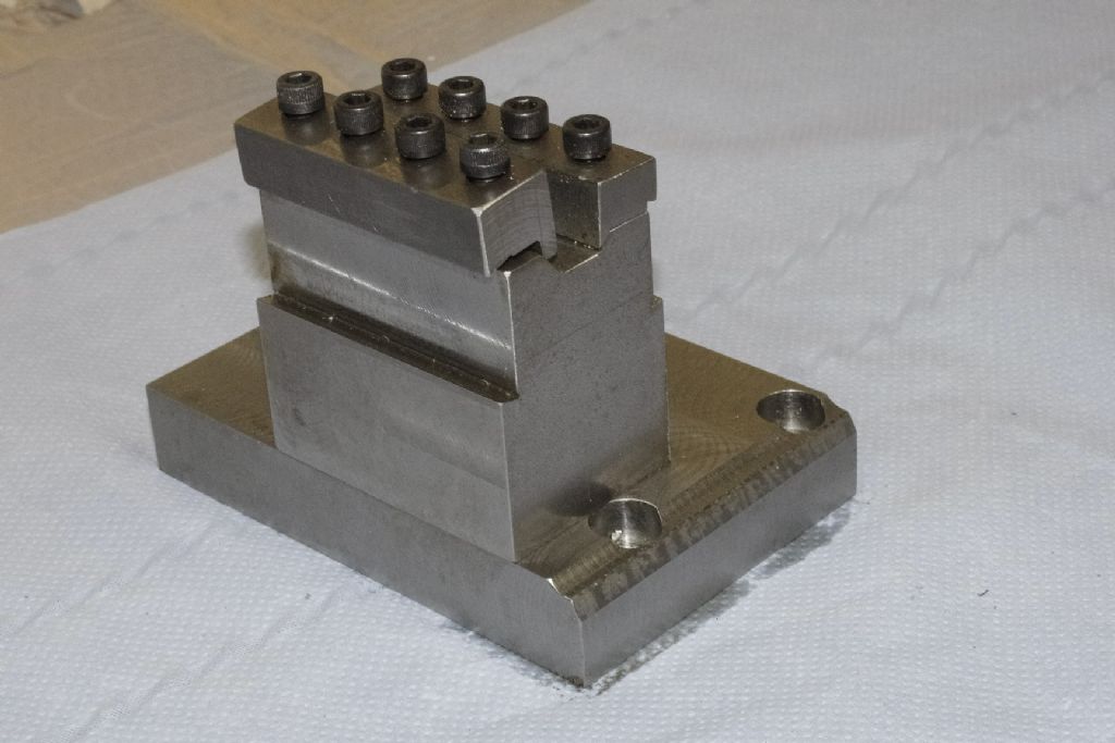

                      _igp2502.jpg_igp2497.jpg_igp2498.jpg_igp2495.jpgHere is my version of a rear parting off toolpost for inverted blades. It has a top half which can be turned round for using either 26 or 32mm blades.The edges just have to be aligned parallel to the cross slide by eye or feel when tightening the SHCS for the blade to be at right angles to the axis. I added a rear saddle lock at the same time, using two helps the rigidity._igp2494.jpg

                        As for tool height, if you use industrial type blades, I read the manuals of both Kennametal and Kyocera and both companies recommended 0.004" high if parting off solid stock. This would have been arrived at after the extensive testing that they do with their products.
