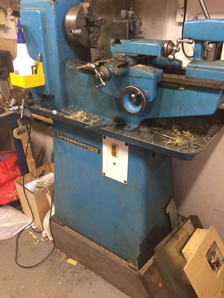

        norman valentine
          @normanvalentine78682
          What to do? I wish to move my loughborough training lathe through 90 degrees. I have tried but I cannot move it an inch. I don't have any friends to asksad, also I am impecunious. Any suggestions?

                      #550829
                      norman valentine
                        a91c34d1-0b3b-482d-81c4-e28abd26fac8.jpegMy Loughborough is on a wooden floor but it is standing on a wooden box to raise it to a sensible height. It is not fixed down but I am not able to move it with my strength. I like the idea of a pinch bar. I had been thinking of complicated ideas like jacking it up and inserting rollers but I have neither jack or large enough steel for rollers.

                        not done it yet
                          @notdoneityet
                          From that pic, you are presumably wanting the tailstock end moving in an arc (removal of the tailstock would otherwise be impossible). If the headstock is adjacent to the wall, using a drawbar, or poking long stock through the spindle, will be severely restricted.
                          Removal of tailstock (and carriage) would lighten that end for lifting purposes. Even chuck removal would help but to a lesser extent.
                          The lathe stand should be securely fixed to that box, if considering moving it by shifting the box.
                          Does the box either have a solid base or at least thick side elements?
                          You are out of luck if no means of lifting, I think (particularly if damaging the floor surface is to be avoided) unless you can find some funds to do the job (safely) or some free assistance from a reliable/responsible source.

                            Posted by norman valentine on 22/06/2021 07:41:48:
                            Edited By norman valentine on 22/06/2021 07:42:25
                            If you are confident in the strength of the box and the floor < that may be a big IF > and can find a convenient anchor point … I would look at using a ratchet strap to drag it.
                            Anchor one end of the strap, wrap the other end around the box … suitably arranged, this could rotate it in-situ.

                              #550867
                              norman valentine
                                The box and the floor are 20mm osb. The box has 3×2 corner posts and the floor is fully supported so I am confident it would be strong enough. Ratchet strap sounds a good idea, I could screw the anchor point(s) directly into the floor wherever needed, and a ratchet strap would have other uses, a pinch bar would unlikely to be needed again. Thanks for the suggestions.

                                Howard Lewis
                                  @howardlewis46836
                                  FWIW,
                                  FIRSTLY, take care not to have the lathe topple oiver! It won't do the lathe or you any good whatsoever!
                                  Use pinch bar to raise one end of the box, until a length of round bar can be placed underneath.
                                  Move to the other end and repeat.
                                  Roll box, with lathe on top, to and fro, moving the Tailstock end sideways, as far as possible each time, until the box and lathe have been rotated through 90 degrees.
                                  Use pinch bar again to retrieve the bits of bar. Job done.
                                  Remember to leave clearance behind the Headstock, so that longer pieces of can pass through the Mandrel.
                                  Being a Loughborough, long work pieces through Mandrel will, be small diameter, so can't be too long, or they will "whip"..
                                  HTH

                                  #550877
                                  norman valentine
                                    Howard, thanks for your suggestion. I had planned to have the tailstock end towards the wall. As I said earlier I don't have any round bar, to use as rollers, of a suitable size and to buy some would be a waste as I have little call for it, plus the cost of a pinch bar that would probably never get used again. If I had the headstock against the wall I could cut a hole in the wall to pass long stock through, with a flap to keep the draughts out. All my stock isl less than 600mm so whip wont be a problem, I made that mistake once and it is not something that I wish to repeat. I will be buying a ratchet strap as suggested by Michael, I can see further uses for that.

                                    Howard Lewis
                                      @howardlewis46836
                                      Pieces of broom handle, or pipe may serve as rollers., once you have found a means of levering the box and lathe off the ground.
                                      You may, at some future time want to remove the Tailstock, do don't have it too close to the wall.
                                      Good Luck with the rearrangement!
