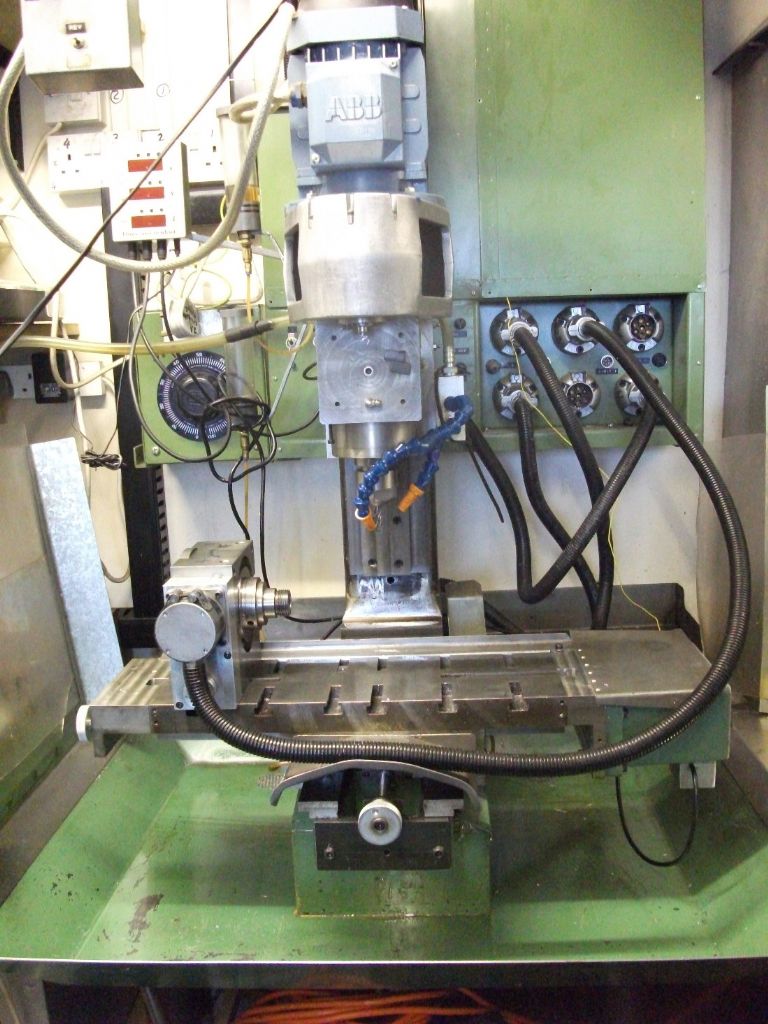

              John P
                @johnp77052
                Hi,
                The photo's here shows the completely new head and spindle that
                i made for my Dore Westbury mill when i cnc'd it ,there are three
                speed ranges using 4 L type 3/8" belts and pulleys with the inverter
                the speed range is from 100 rpm to 10,000 rpm .
                Lot of work to do ,i doubt you would be able to fit something like
                this on the standard Dore quill assembly.

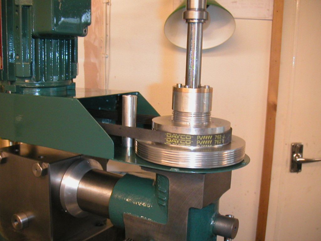

                Alan Jackson
                  @alanjackson47790
                  This what I did
                  Alan
