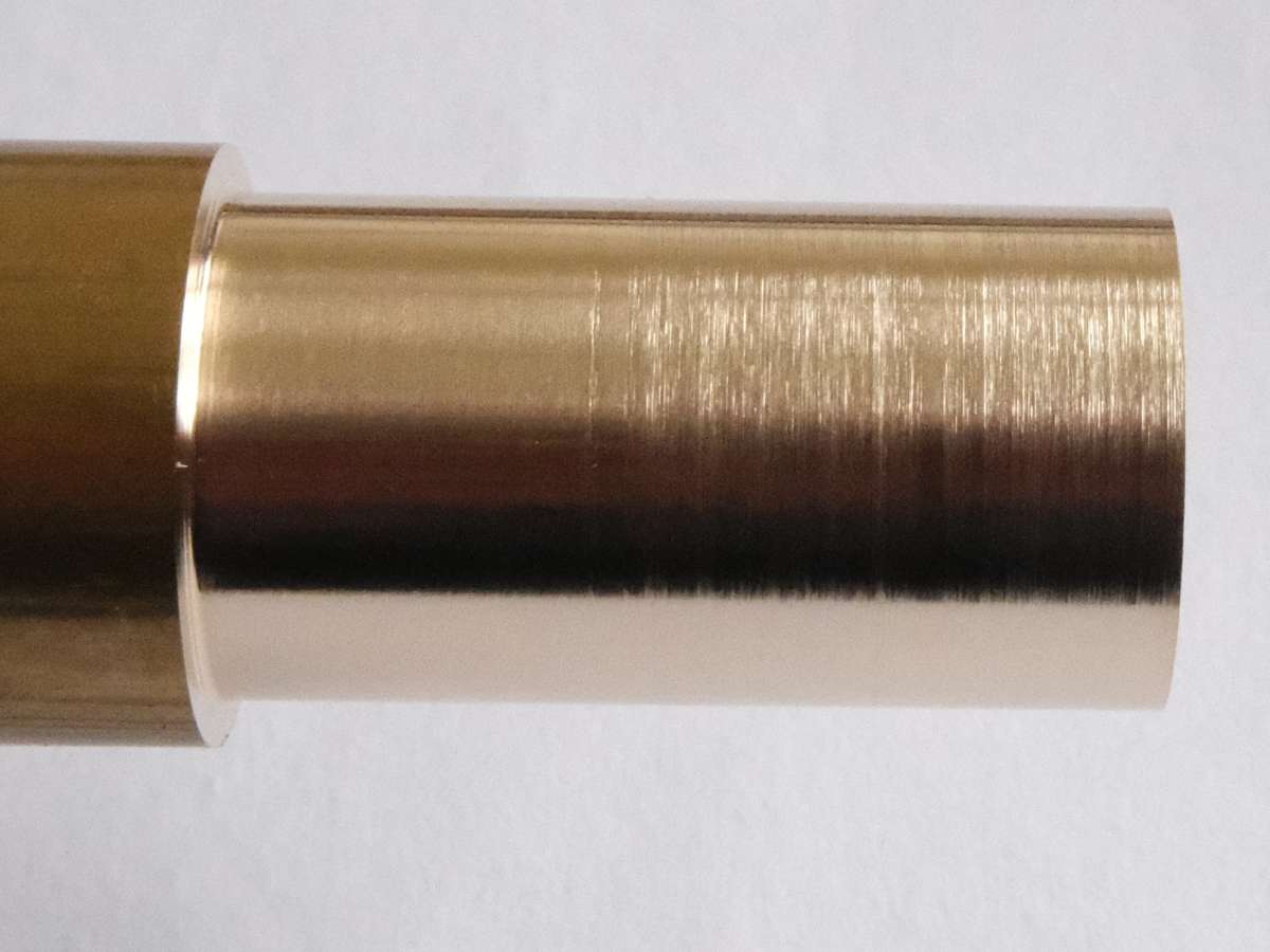

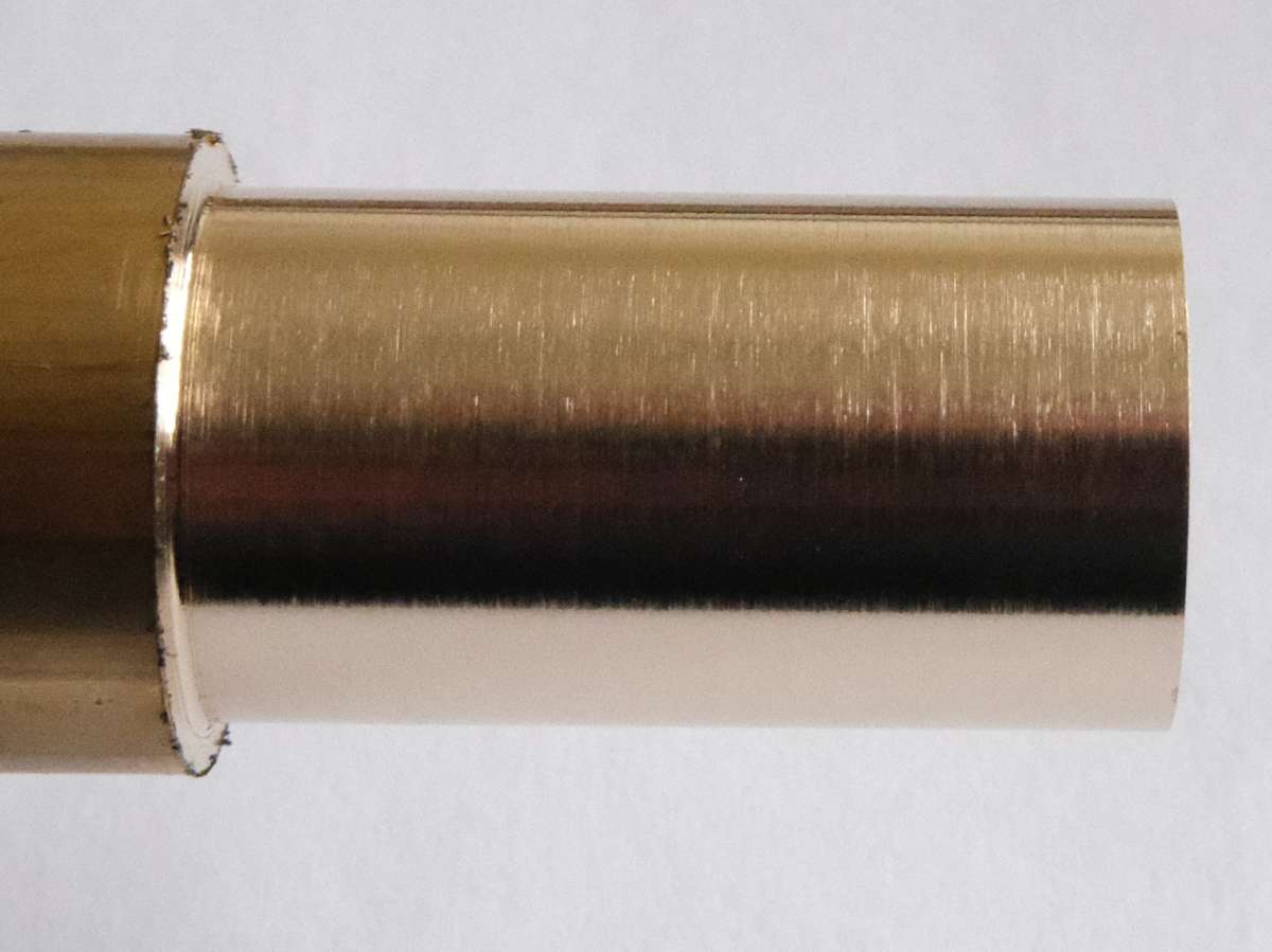

            Julie Ann
              @julieann
              Here are some pictures of the machined surfaces after the second test. The CCMT Insert:
              CCMT Insert
              The CCGT Insert:
              CCGT Insert
              The finish with the CCGT insert is significantly rougher over just half the length of the cut. Looking at the recommended DOC and feedrates on the back of the packets the CCGT is running just within parameters whereas the CCMT is just outside on both parameters.
              I don’t know why the CCGT should be so bad at the beginning of the cut. Could be because the cutting process can’t make its mind up as to how the swarf is going to break. Or possibly inconsistent material?
              Julie
