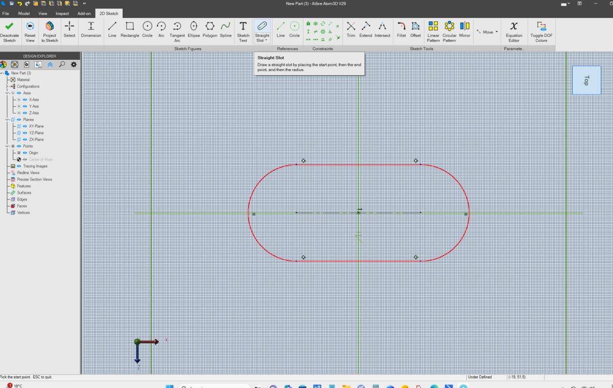

                .. … I cannot model rectangles with semicircular ends in CAD properly, nor make real ones neatly, so drew a nice circular hole instead … ..
                Nigel, there’s a ‘Slot’ tool/template available in the Atom sketching space that does it for you.. (.and more besides..)

                  I’m not sure if Nigel has the slot tool as I think he is not on yearly updates and the slot ha sonly been available for  acouple of years.
                  Sevaral ways to do rectangles with rounded ends if you don’t have the slot tool.
                  1.  Sketch a rectangle, exit the sketch once just the rectangle has been drawn. Then use the fillet feature which is a quicker way and better should you decide you want to alter the radius at a later date. Enter the length of the short side/2 and alibre will work out the radius from that.
                  2. Draw a rectangle and while still in sketch mode use the fillet tool entering the length of the short side / 2 as the fillet radius. Click each pair of lines that form a corner and it will round them.
                  3. Sketch two circles, sketch two lines and then make the lines tangent to the circles. Trim lines and the inner halve sof te hcircles to complete your sketch

                      Thankyou Diogenes and Jason.
                      No, my edition does not have that tool.
                      I did look at the Arc and Tangent tools but couldn’t see how that would apply.
                      I didn’t think of Fillet, which I have not used often.
                      I think I’m forgetting more than I’ve learnt about CAD! So I don’t use it very often.

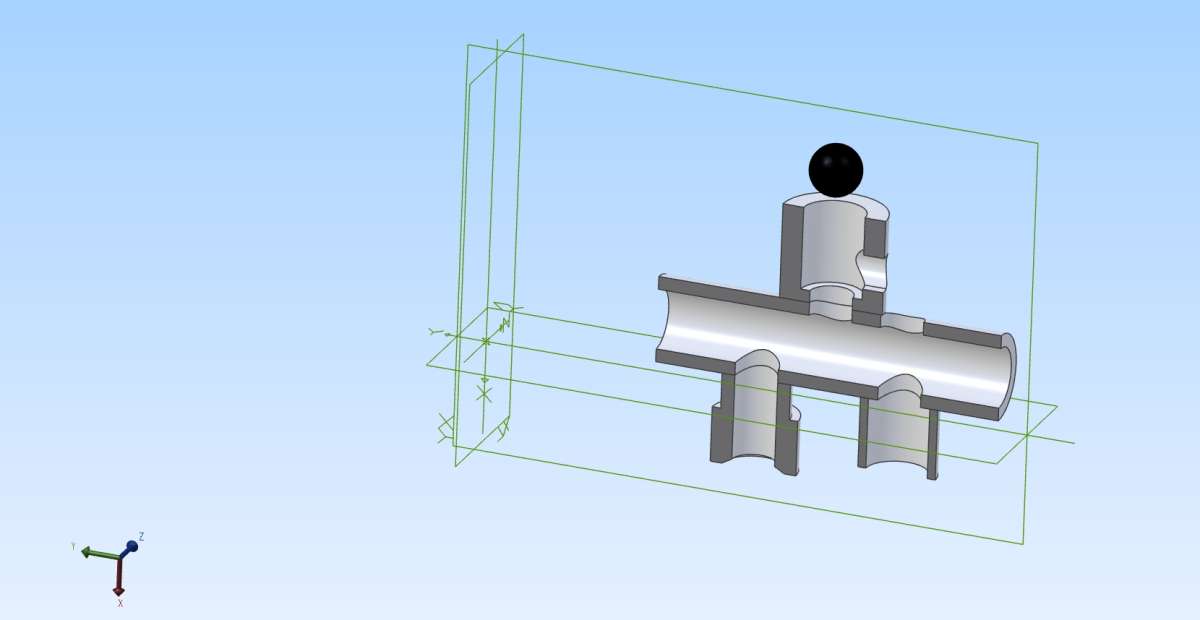

                        Yer ‘tiz.
                        Just the basic body.
                        There is an “Overflow Cover” that links the outlet from the valve to the port into the cavity taking water round the delivery cone to the overflow connection. This is a peculiar thing to make, but worse the book’s drawing is not at all clear and it proved impossible to transcribe. I don’t believe it can be made it from that drawing, too.
                        I have omitted the cap. It’s not as simple as it would seem. Similarly with the cones; four of them as the combining-cone is in two parts. Each of these five would take me an evening to draw!
                        I’ve also omitted all the threads: I can’t find a way to show them sensibly. ( I don’t understand how to ask Alibre to generate them, but anyway they apparently take vast computing reserves for what they are.)

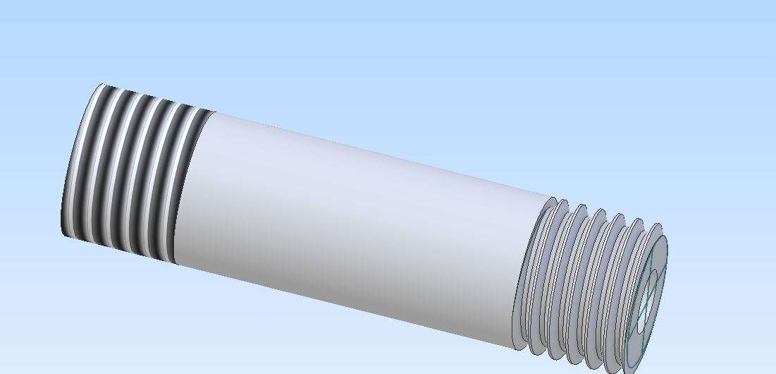

                          It depends how you show them.
                          One option is too make them “look” threaded on the screen which will also carry through to 2D drawings, this doe snot use up much memory. Left end
                          The other is to actually have alibre ” cut” the thread which does take up a lot of memory and is aimed more at those using CAD for 3D printed finished parts. Right end.
                          Having said that again I don’t think your version is up to date enough to have the “hole” tool which is used for both internal and external threads.
                          A similar thing can be done manually by drawing a triangle and using helical cut but not worth it for your puropse.

                              Thank you Jason. I recall trying that thread-generating with one of the published exercises. It was never normal to depict threads in more detail even on manual drawings.
                              I’ve not tried it but I wonder if it could be done in Alibre by modelling the core as a basic Part feature, then overlaying it with a thin cylinder made translucent. An analogy to drawing a thread as a pair of concentric rectangles.
                              I take it what you show there on the left-hand end is a series of grooves that are actually parallel? That would suffice for many threads.
                              BTW: to create the ball I sketched a semicircle on the axis then revolved it by 360º.
                              What this exercise does suggest is there may be slightly easier ways to fabricate such an injector physically.

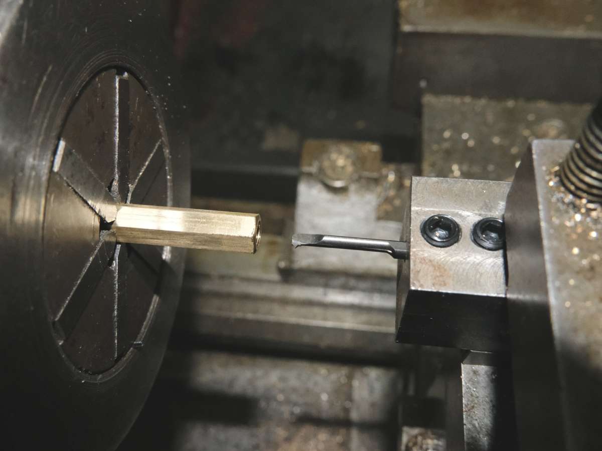

                                Made a couple of brass union nuts this evening:
                                Union Nuts
                                Nothing particularly special about that, except it gave me the chance to try out my new Carmex theading tool to cut the 3/16″ x 40tpi internal thread:

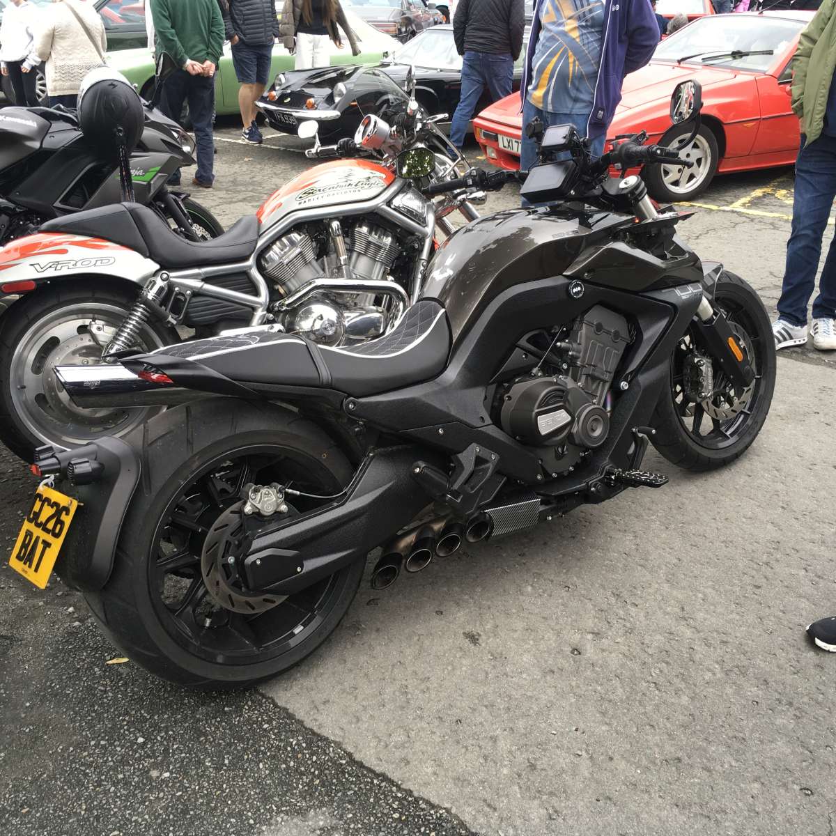

                                        We don’t appear to have the old topic any more, so I’ll post it here …
                                        Rather impressive Chinese motorcycle, exhibited at Prestatyn today, by George:
                                        He’s very happy with it, and says it handles well.

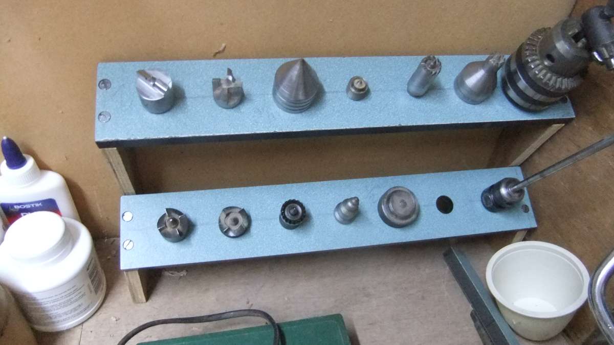

                                                      Apart from working on the Rob Roy lubricator I have managed to do a couple of jobs I keep putting off.
                                                      One being somewhere to store my chuck keys for the various lathe chucks (surprised by how many you can accumulate) It is only something simple, but it saves having them all in a pile on a shelf.
