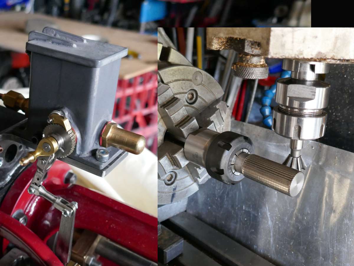

              To make the ratchet wheel for my lubricator, I held a piece of round steel in a collet in a rotary table and used a dovetail cutter in the mill to cut the teeth. The teeth in the round steel were much wider than what was needed and a slice cut off to suit the width required for the lubricator. (I now have enough spare material to make many more lubricators). The material used was silver steel but I did not harden it. The pawl is made from brass and both have not worn after 8 years use.

                I cannot believe the support I have been given in less than an hour of the original post.  I have ordered a few Ratchet cogs from Reeves 2000 but I like the challenge of the dovetail cutter in rotary table on the mill.
                your lubricator looks outstanding Paul.  Far more robust than the one called out for the Doris.  Can I ask what locco it is for?

                    just ordered dovetail cutters from RDG.  Did not know if I needed 45 or 60 degree so ordered both.  Can you remember which you may have used?
                    Kevin
                    #857641
                    Paul Lousick
                      @paullousick59116
                      60 degrees but either should work
