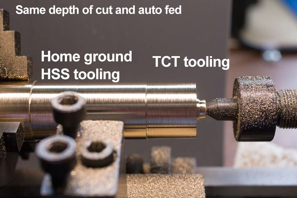

                                              Thanks John, an email now sent.
                                              Thanks to everyone for their help and encouragement. I’ve finally been able to put tool to metal and got everything working pretty much as I think it should.
                                              An initial trial with some brass suggests the HSS tool I ground (pictured earlier) works well, possibly better than the TCT tooling I’ve got. Although that might be due to the TCT tip’s bult in rake being less suitable for brass.
                                              Certainly it’s an encouragement to grind more of my own HSS tooling.
                                              cut test
                                              #836555
                                                On paul1956 Said:
                                                …An initial trial with some brass suggests the HSS tool I ground (pictured earlier) works well, possibly better than the TCT tooling I’ve got. …
                                                Good start, the HSS tool is cutting well.  You have aptitude!
                                                By TCT do you mean these?
                                                tct
                                                If so, I’m wary of brazed Tungsten Carbine Tipped tools after experience exposed problems.
                                                • I suspect they cover a use-case I don’t have, which is rapidly roughing out tons of difficult materials like chilled cast-iron, hardened steel, work hardening stainless, and abrasive composites such as fibre-glass.   As these nasties rapidly blunt HSS and are liable to chip expensive inserts, a resharpenable carbide tip makes sense.  No point in using them on Brass or Steel.
                                                • Not always supplied sharp,  guess what I bought. Not obviously wrong, but left a poor finish no matter what.  Check before using.
                                                • An advantage is they can be sharpened and shaped on a grinder, but only if it has a green wheel.   The grey wheels used to sharpen HSS are too soft for carbide.  I’m not rushing to waste money on a green wheel to just grind TCT.
                                                • For what I do, inserts do 90% of what I need with no fuss.  Advantages: identical, precision made, with 3 or 4 cutting edges / points, that can be rotated or exchanged in the holder without disturbing the set-up.  Convenient, fast and easy.  Industry love inserts because carbide also cuts metal up to 15 times faster than HSS, and they reduce reset times dramaticallu.  There is a catch!  Carbide can be more fussy, especially when the rake and other angles are optimised for industry to remove metal flat-out and get a good finish in one pass.  The optimum speed, depth of cut and feed-rate recommended for industrial cutting are rarely available in our workshops, so not all inserts are suitable. That said, many perform well at hobby rates, and so would TCT if the angles were ground right.  But the machinist may have to experiment to find carbide’s sweet spot.  It’s not difficult.
                                                • HSS does everything else!
                                                Comparing HSS with carbide at the same speed as shown isn’t conclusive.  HSS gets a good finish across a wide range of cut depths and feed rates.  Carbide is fussier, and probably does better going in harder and faster than HSS.  Finding out what works is done at the lathe and doesn’t require a grinder.
                                                I can do either HSS or carbide.  I find they perform equivalently, but inserts are more convenient, especially when the material is tough or hard.   HSS is mostly kept for form tools and specials.  And no need for a QCTP – all that’s necessary to set insert tooling to height is a pre-cut shim and a bog-standard tool-post.
                                                My advice, try stuff and see what works for you. Much depends on the type of work done.

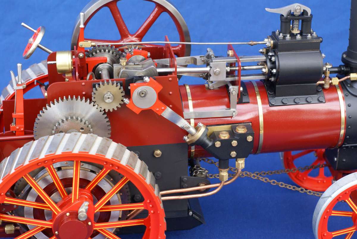

                                                #836564
                                                  90% of the turning on this was done with brazed carbide, works fine on all common model engineering metals and not just roughing cuts. Though I think Paul mentioned having an insert tool holder.
