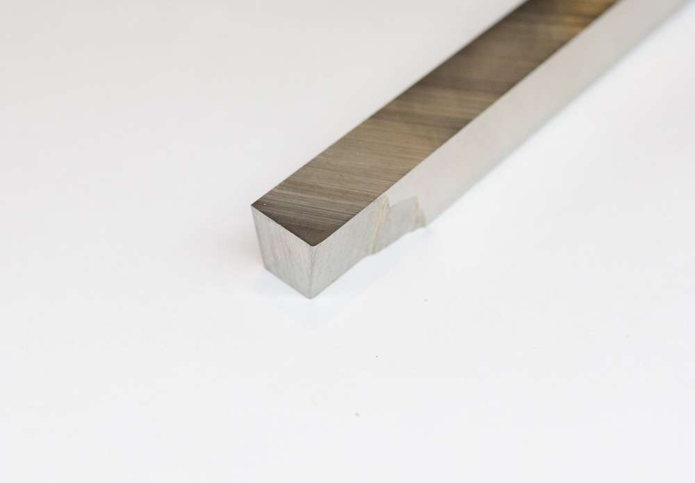

      My error, I picked up the wrong bar, it’s 8mm square not 10. But definitely 8mm from bottom of tool post to centre. I’ve found a cheap TCT set on Ali, so they should arrive with some other bits in about 10 days. I won’t get chance to actually get turning for a couple of weeks, so that time delay should be fine.
      I’ll also have a go at grinding some of the HSS bar into lathe tools. From all I’ve read and watched it seems a pretty simple task compared to grinding the complex compound curves on woodturning gouges.

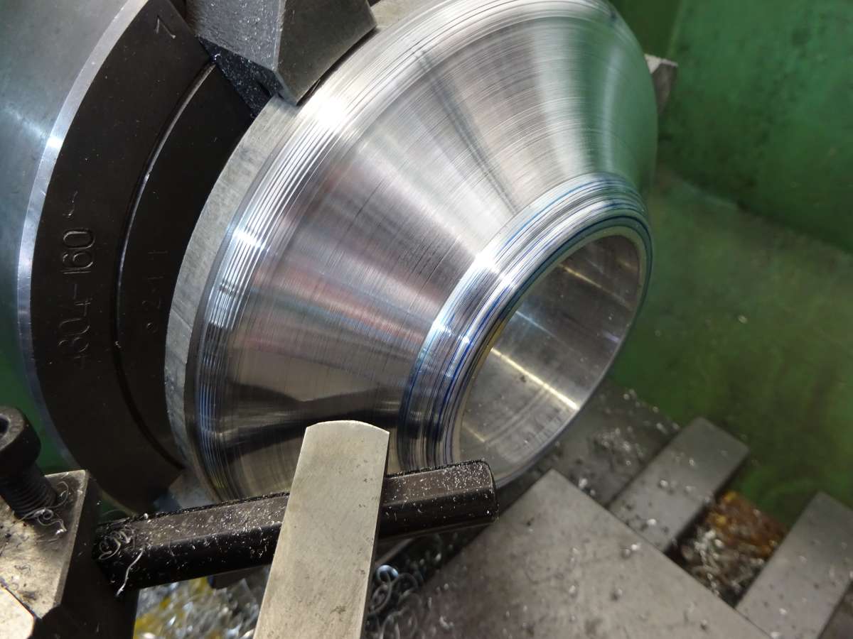

        If all else fails a woodturning scraper will cut metal rather well, I use mine for the odd freeform curved surface. They wil be ideal for things like smokebox doors, chimneys and steam domes on your small loco after roughing out the shape with conventional lathe tools.

          Blimey Jason resorting to hand turning!!!!

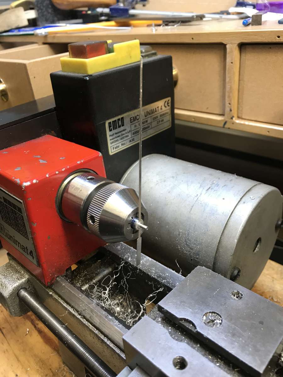

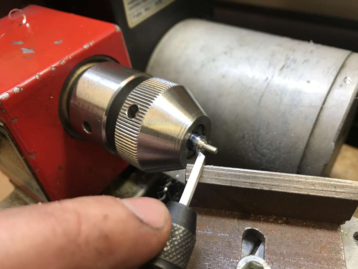

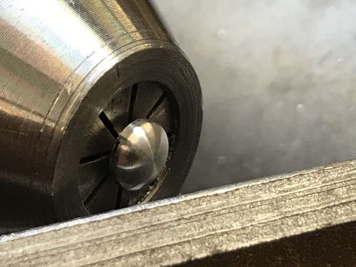

                  With a very simple rest and ER16 collets the Unimat is quite good for hand turning
                  IMG_7181IMG_7173IMG_7177

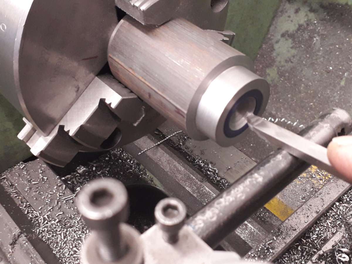

                                              I’ve had a quick go and really don’t see why some people think it’s so difficult. With the right kit grinding straight lines is pretty easy.

                                                On paul1956 Said:
                                                ….I’ve had a quick go and really don’t see why some people think it’s so difficult.
                                                It isn’t difficult; tool looks fine for brass, for steel will need some top rake.
