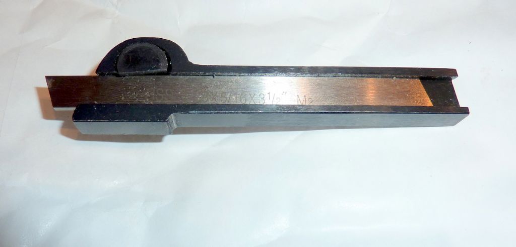

      PS I found this type of 5/16 x 1/16 (or 8mm x 1.5mm) parting tool holder works better than the side mount types. Holds the blade more verttical and does not move. Its all I use for general parting of small jobs. Less faff than fitting the rear post.
      #532689
        Thanks Hopper. I only fished out the rear post because I heard it was a much better method for parting. Sparey seemed to think they were invaluable according to the two books I’ve got. Anyway I’ve fished it out of the bin. Got this far, and I hate giving up. Another lost evening wont make any difference I guess.

          Yes the rear tool post is well worth pursuing. Sounds like you have the best idea with bolting a slab of steel on top of your machined down cast iron.
