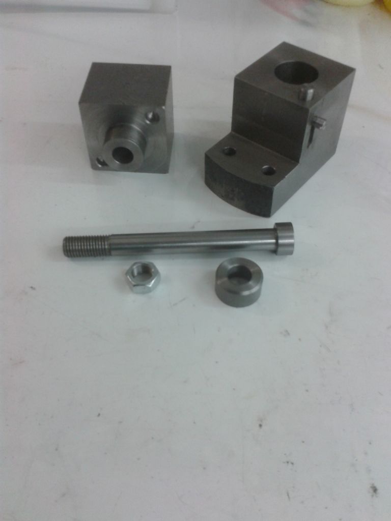

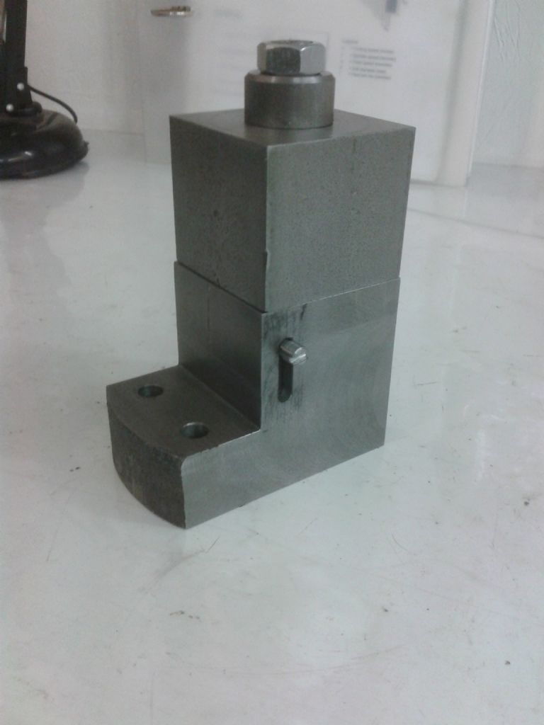

                          I made mine from the Hemmingway kit; one side has an angled slot , but I found that this created too much overhang & altering it moved the centre height out of position so I used the horizontal slotted side with a different holder which allows me to alter the over hang without losing centre height..
                          Part assembly
                          Main parts
                          Leaving the centre height as shown produces too much over hang..
                          Assembled tool holder
                          George.

                                Mechman48:
                                Your last photo shows the angled slot; is the angle actually more than the 7 degrees in the original GHT design?
                                #531239
                                mechman48
                                  @mechman48
                                  It was made to the drawing supplied with kit & as I recall it was 7*. It may not look it on the pic but it was propped up at the rear so there's probably some parallax error in there… thinking.
                                  George.
