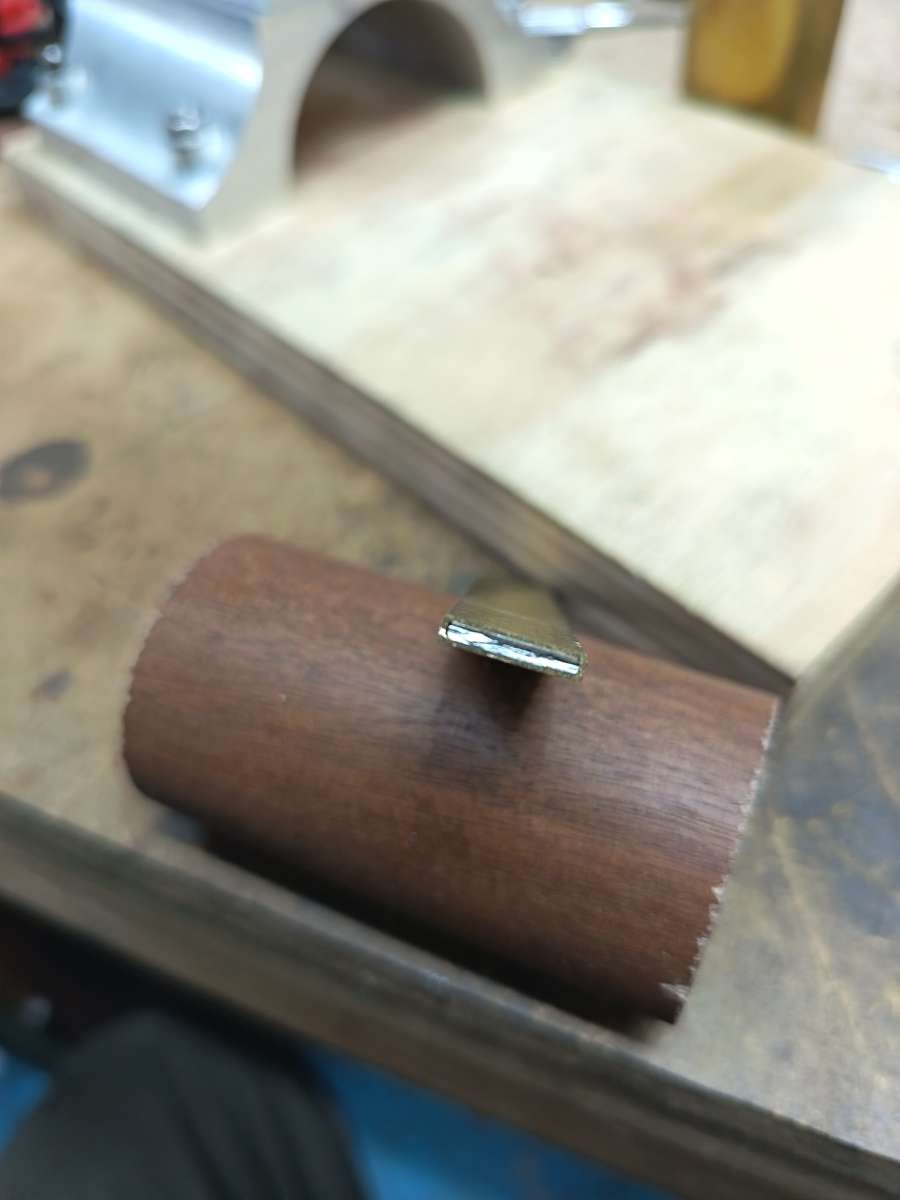

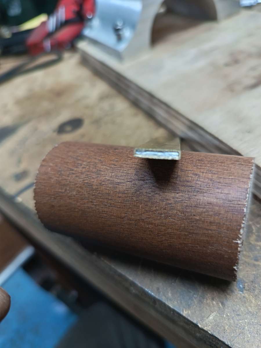

      Hi
      I had what I thought was a brass flat bar, 1/16 x 1/12″
      I I cut a couple of pieces and tried to drill them, my drill went through the brass no problem then stopped, the steel? inside is hard as glass
      Anybody any idea what is or for?
      Dougie IMG_20260702_103522IMG_20260702_103434

                        I think Ian P hit it dead on, after stripping the brass it was indeed spring steel inside
                        As to its use I have no idea but the spring steel might come in useful
