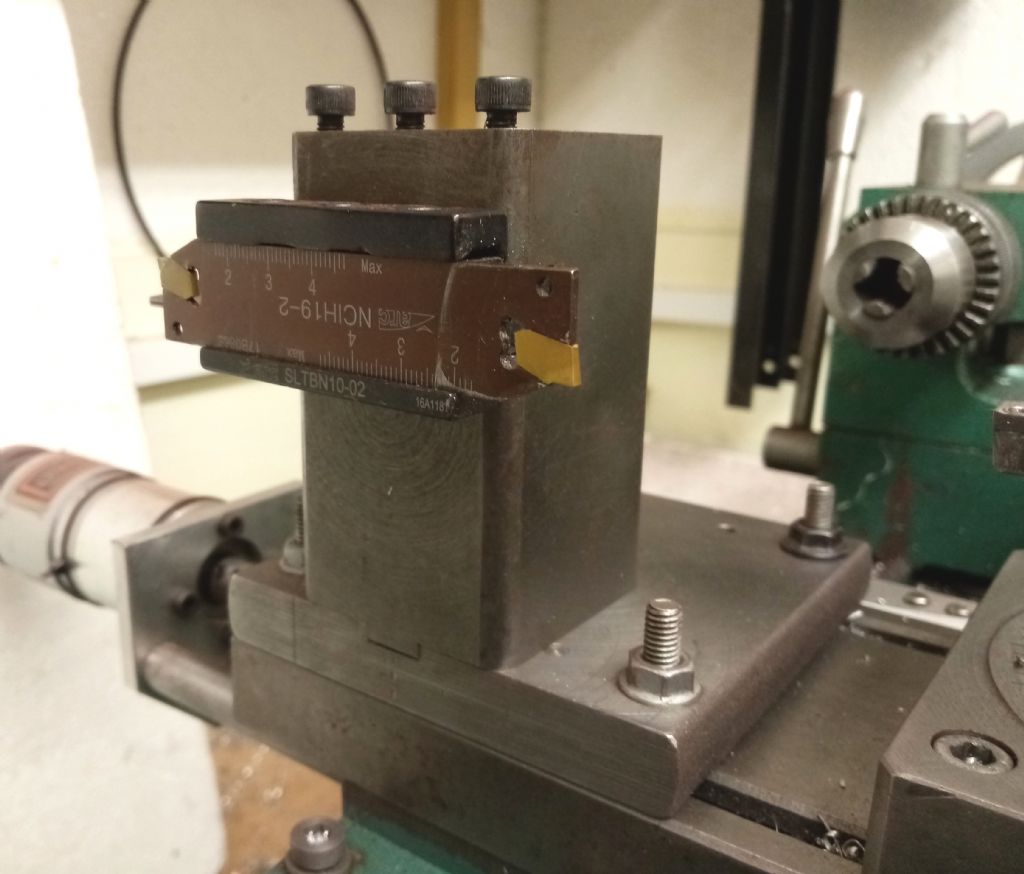

      I've been reading about the benefits of a rear toolpost for parting off. I remembered I'd got a home made rear post with some stuff I got with the lathe:
      With a bit of modification, I can use my Sandvik parting tool in it:
      Should the upside-down tool be dead on centre height, or whould it be a bit above or below? I thought I'd read that one or the other was good.
      The real issue is that it is this crappy single bolt for securing to the topslide:
      When I tried to tighten it down, it just pulled the peened over bolt through the plate. Shame because the brass nut is the same size as the toolpost nut.
      I suppose I could relpace the plate with a T-nut, but it would be very small compared with the size of the block. I guess it could really do with two bolts, but I don't fancy drilling through all that steel.
      Any suggestions as to how to make this work? Thread another bit of plate and screw it into the bolt? Would that alone give enough force?

        Emgee
          @emgee
          You could add another 20mm thick block to the front of the existing block to convert it to an L shape when viewed from the chuck, that would allow you to use another 1 or 2 Tee nuts in the 2nd Tee slot and provide much needed security.

          Maurice Taylor
            @mauricetaylor82093
            Hi ,I use a single bolt rear toolpost with my Myford,it works alright .Try a proper tee bolt ,before doing anything complicated. There are plenty on Ebay.

              Posted by Dr_GMJN on 01/03/2021 22:29:14:
              …. but I don't fancy drilling through all that steel.
              Why? Other things being equal, I'd just go ahead and do it. 10 or 15 min later you'd have what you want.
              The bigger problem though is that it doesn't look like you actually have room for the second bolt.
              Hmmm … just musing … if you could raise the blade holder a bit (thick"shim" under it?) you could then cut a key on the bottom of the block to drop into the t-slot. That should give quite a benefit in rigidity (and alignment) and two bolts wouldn't be an issue.

              Dr_GMJN
                @dr_gmjn
                Thanks all.
                Re. Milling a key – Id have to check, but I think it could be done, or I suppose I could bolt a strip underneath which would have the same effect?
                I guess I could mill a gap above the T-nut (If necessary), to give a bit of clearance, ie have two blocks?
                That would address any rotation issue, and presumably one bolt would provide enough clamp force? Maybe worth facing the base as well, just to ensue maximum contact?

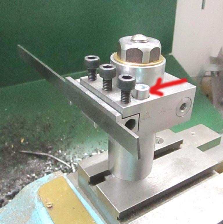

                                        Hi Guys,
                                        This is a picture of my rear parting tool post on my Myford. It is set dead square to the chuck jaws and dead on centre height. It uses a single through bolt into a 4 mm thick flat plate located in the "T" slot. Notice that it is also set a little inboard to avoid the twisting effect that you get when the cutting tool is over the edge of the slide.
                                        That blade is 2 mm thick by 12 mm wide and 200 mm long ! £2 from Bangood.

                                                John Baron:
                                                Your RTP seems very nicely made. What is the purpose of the small cylindrical bit just behind and to the right of the front cap screw, please?
                                                I take it that the main cylindrical column is intended to allow the tool tip height to be adjusted. There is always a trade off between features but, instinctively, I favour the GHT style with its relatively large base and triple retaining bolt/screws.
                                                #531160
                                                John Baron
                                                  @johnbaron31275
                                                  Hi Ega,
                                                  It is the back end of the split collet securing the tool block to the post !
                                                  This is a picture of my front tool block. You can see the head of the M6 cap screw that is used to tighten the split collet. The rear tool block is identical. In fact both were made to be interchangeable so that either could be used on the front or back.
                                                  In fact the only thing that is missing on the rear one is a block for the adjuster screw to bear on. I have a loose block that I use. I keep promising myself that I will make a bracket to do the same job. I need a round toit !

                                                    ega
                                                      @ega
                                                      John Baron:
                                                      Thanks for your reply and photo.
                                                      I may be having a senior moment but this was the feature I was interested in:
                                                      I'm guessing that it may be the adjuster screw head?
                                                      I happily used a simpler version of your front tool post for many years, IIRC a Len Mason design from ME.
