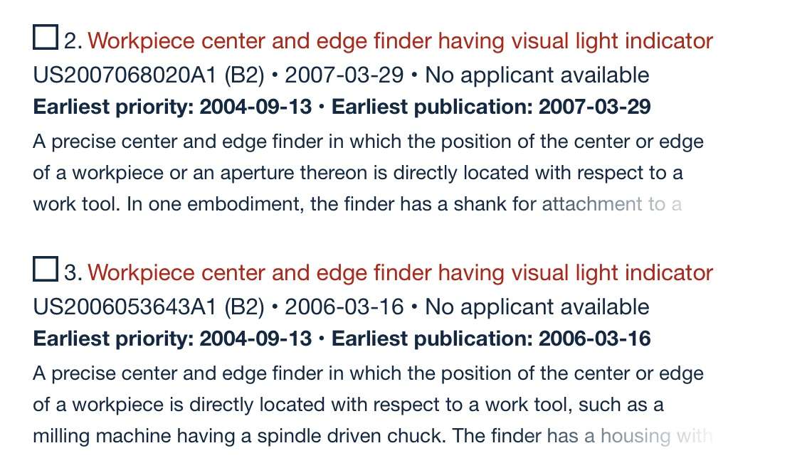

            #854795
              On Michael Gilligan Said:
              Now to work-out why theirs is better than the rest.
              With a little help from AI
              US Patent No. 7,464,478: Granted on 16 December 2008 for a “Workpiece center and edge finder having visual light indicator”.
              US Patent No. 7,137,208: Granted in November/December 2006 covering the core operational components of the alignment tool. [1, 2, 3, 4]
              Both patents were filed by inventor Merle “Skip” Adrian, the founder of SDA Manufacturing, LLC based out of Piedra, California.
              #854797
                [ UPDATE ]
                We all know that AI can make mistakes …
                Here are the patent references, as per Espacenet
                IMG_1811
