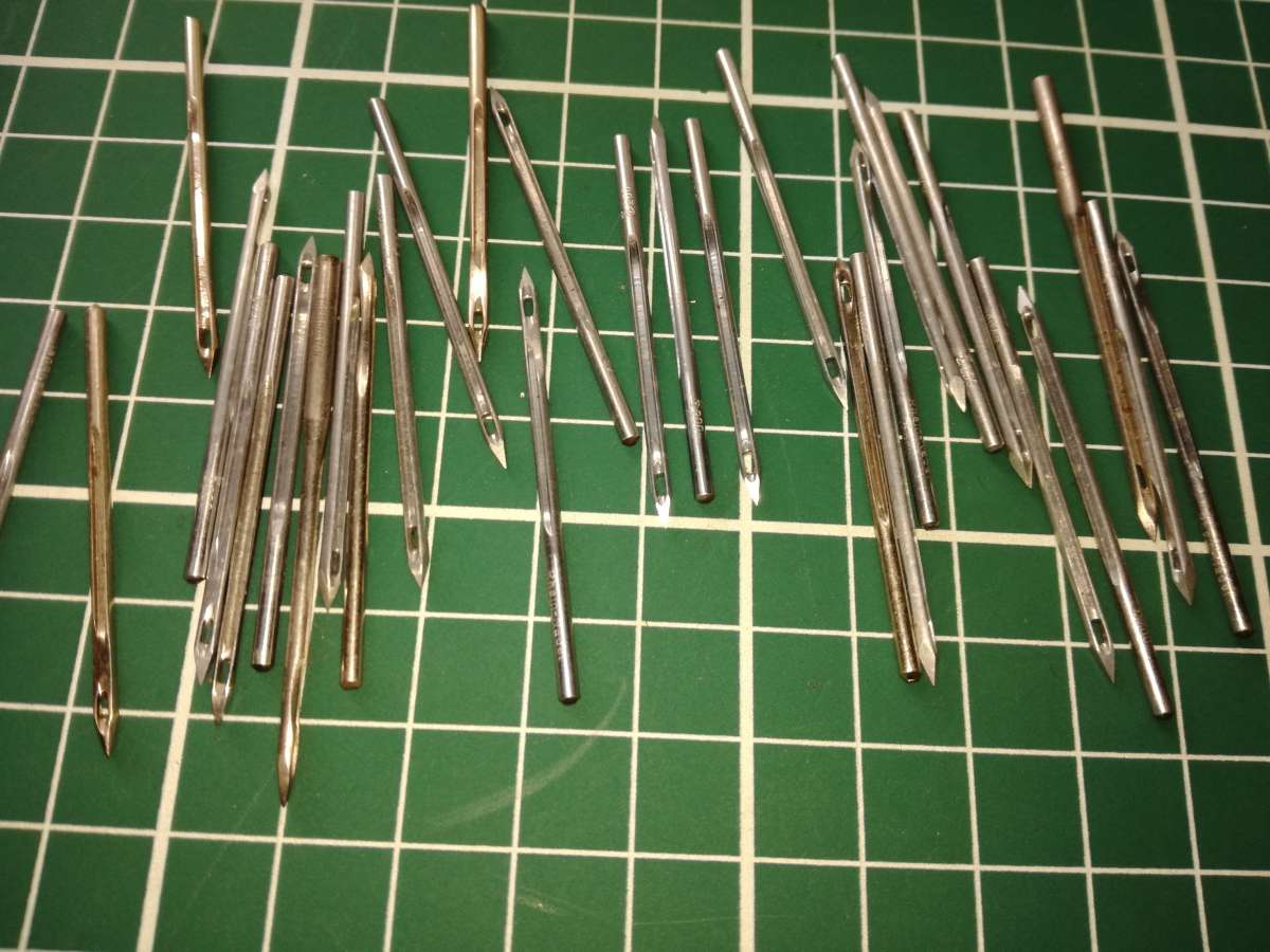

                                Hi, did someone mention needles.
                                IMG_20260704_160735
                                These are a few I saved from being scraped, they were used in industrial hand sowing machines, that stitched up open ended paper bags after they were filled, the machines fell largely out of use, once self sealing bags became the norm, and soon never got used again a while afterwards. I think I’ve got one of the old machines somewhere, but don’t know if it is of any use now though, but I often use one of the needles to line things up on my mini milling machine.

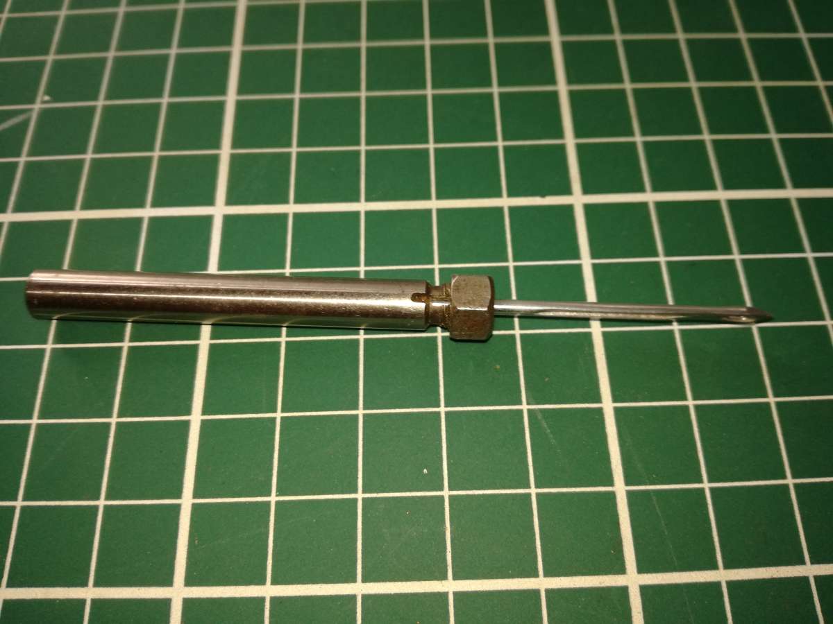

                                I’ve even got cut down rod that held them, with a needle fixed in it, which can be held in a three jaw chuck or a collet chuck.
                                IMG_20260704_164558
                                Regards Nick.

                                            Hi Robert, yes many paper bags are still sewn up, but the ones that the company I worked for, were filling 1cwt bags, which were hand filled and sewn, but when it all changed to 25kg bags, relatively a short period later, new plant was installed, and the filling process became semi-automatic, and using self-sealing bags, and hence sewing machines were no longer needed. these bags contained a total industrial product. The plants that produced the product, no longer exists in the UK, it all went, you’ve probably guess it, to China.
                                            Regards Nick.
