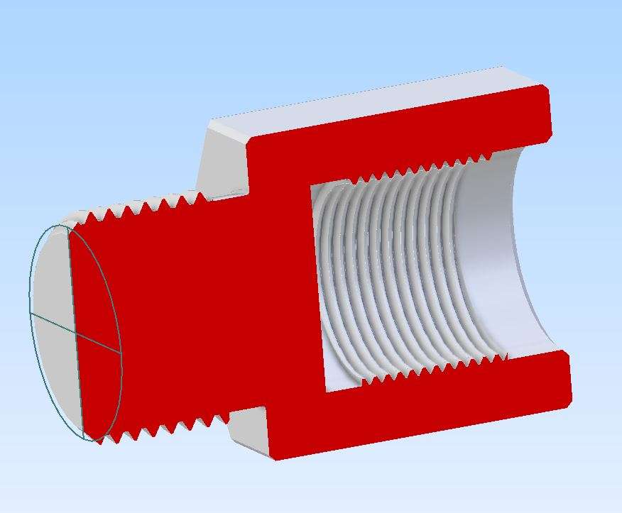

      Hello Everyone, I hope I’m not over-stepping here but I wonder if anyone with the correct equipment would be able and willing to make me a female…no wait there’s more…a female M16x1.0 to male M18x1.5 reducing bush. I can find for sale female M16x1.5 to male M18x1.5, or female M16x1.0 to male M20x1.5 but not my unicorn…
      Can anyone help, please, it’s for a proxxon db250 (wood lathe) so that I can use a ring mandrel that is perfect for what I need?
      Rob

            On JasonB Said:
            Unless you want quite a bit of overhang then trying to tap M16x1 into a M18x1.5 thread will leave a very weak part.
            I though something like the attached image, the female thread only needs to be about ~8-10mm and then solid thereafter as you go out to the male threaded portion.
            Hex Bush M16x1.5 Male to M18x1.5 Female

                    Threaded inserts do work like that But the ones I have used have a bigger difference between inside and outside threads
                    If it were just a bush eg fits into a M18 x 1.5 hole and had a M16 x 1. you will only have less than 0.25mm thickness in places.
                    The longer male/female adaptor shown would be OK as the threads are on different lengths of the part, if the added overhang is OK then all is well.

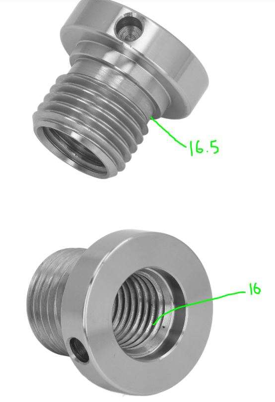

                          #819033
                            This is what I would regard as a chuck reducing bush, short as possible to keep overhang down.
                            bush
                            Crests of the internal thread would be 16mm , runout groove at the end of the larger thread 16.5mm max. Ok the Proxxon is a small lathe but I would not want to hang some of the bits of wood I have turned on what in effect would be a 0.25mm wall thickness tube

                              #819040
                                Fully agree with Jason, but I do  think we need to be designing the appropriate item.
                                Wild guess: OP wants to use something like this:
                                https://www.ringsupplies.co.uk/collections/chucks-expanding-ring-mandrels

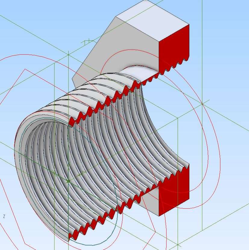

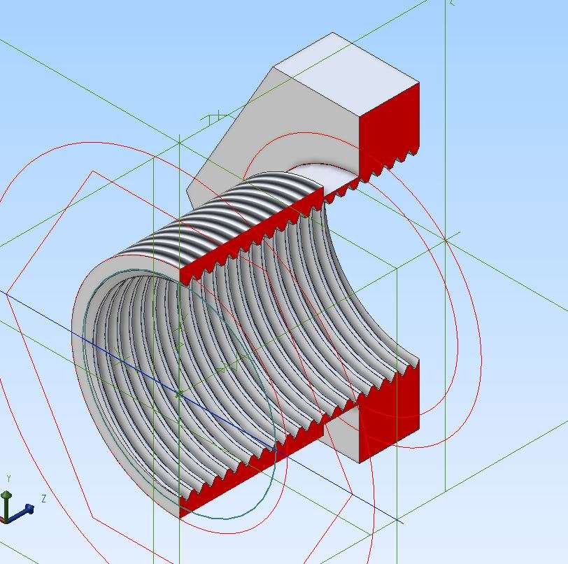

                                #819043
                                  Looking at some tables of the minor diameter for M18x 1.5 it can be less than 16mm!! This is it at 16.4 so I personally would not want a bush. And that is without the plain section of the internal thread.
                                  thin
                                  #819046
                                    Beautifully demonstrated, as usual, Jason.
                                    #819049
                                      Ops, did not have a physical M18 thread on the image above
                                      thin 2
