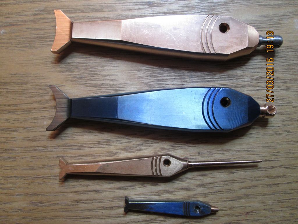

                        Mick B1
                          @mickb1
                          Sharp tooling also minimises the generation of heat on cutting, which I think may be due to its toughness and the reluctance with which the chip parts from the parent material.
                          Given sharp tooling, it's quite straightforward to machine much as you would medium-carbon steel as far as speeds and feeds go.
                          I'm interested to hear about the Damascus grades – I didn't know of these and have generally used grade 2. It blues nicely:-

                            #552568
                            old mart
                              @oldmart
                              Titanium is naturally silver colour, but can be anodised at different voltages to give lots of different colours.
