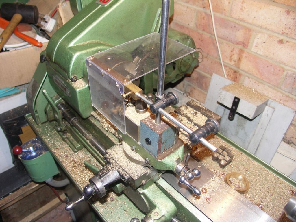

          Mike Poole
            @mikepoole82104
            A perspex screen fitted to one of the cheap magnetic bases make a useful screen for the lathe or mill to control nuisance chips.
            Mike

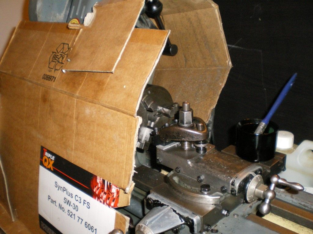

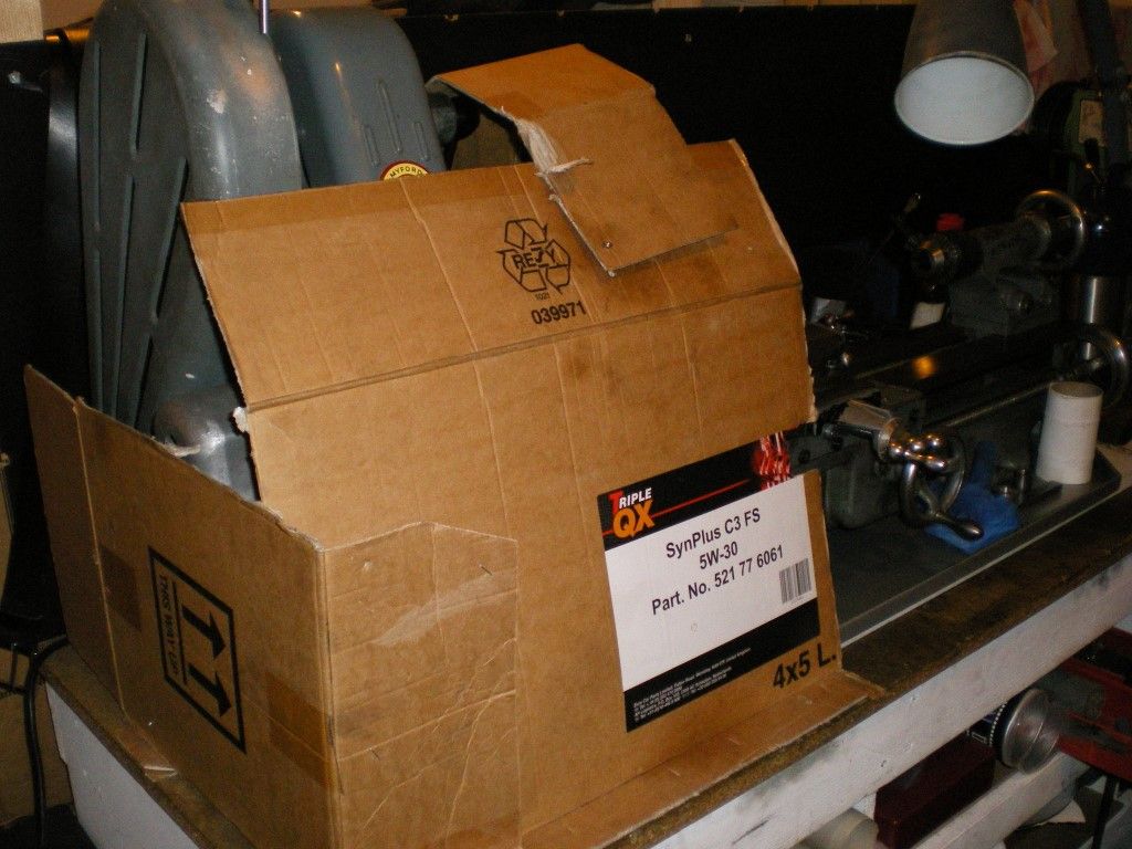

                  Steven Vine
                    @stevenvine79904
                    If you are in a rush, a cardboard box comes in handy (purists please look away now).
                    Steve

                    Harry Wilkes
                      @harrywilkes58467
                      Luigi
                      I like it may go that route, smiley
                      Steven is that someone's house you have around your lathe wink
                      H
