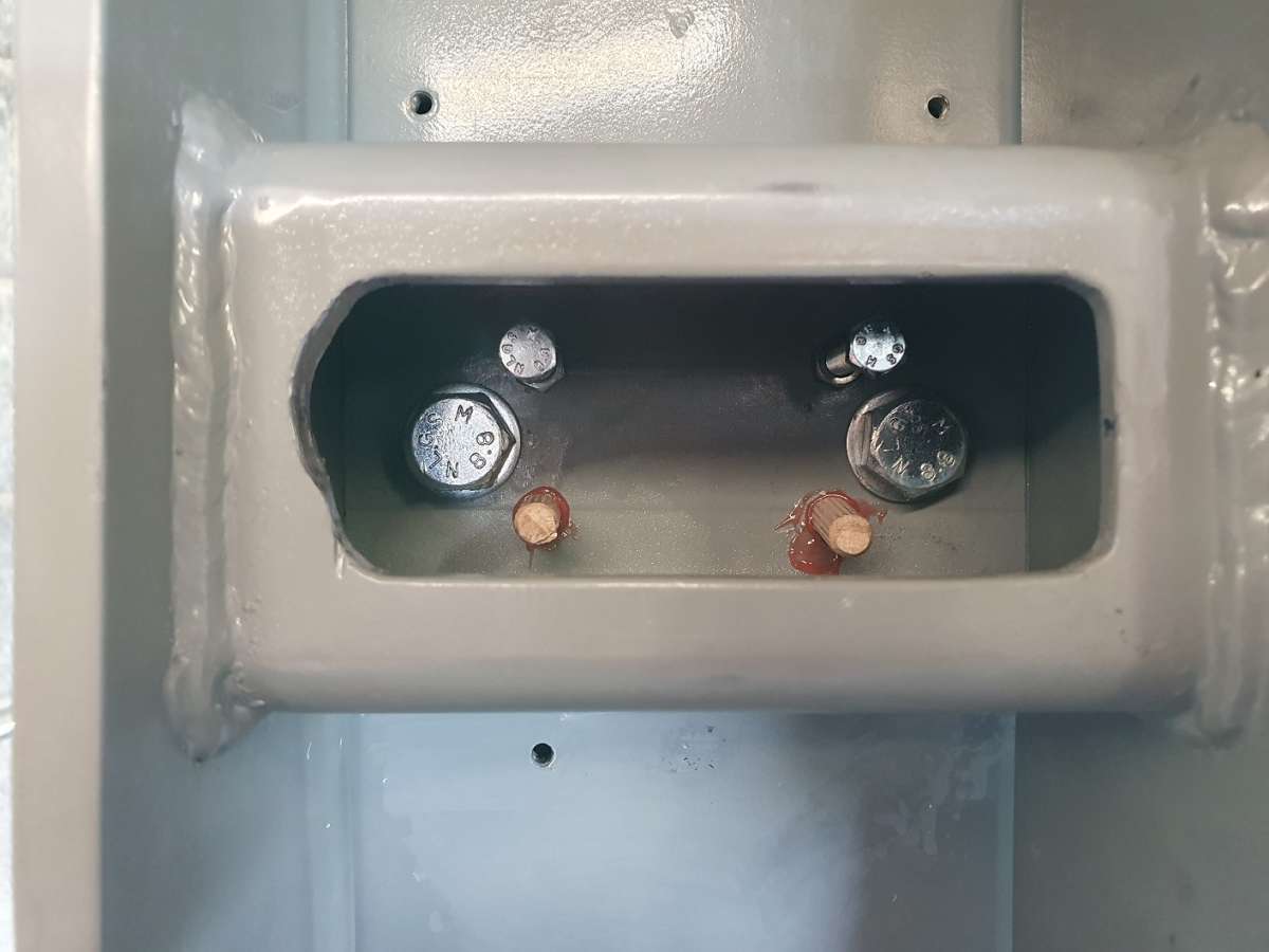

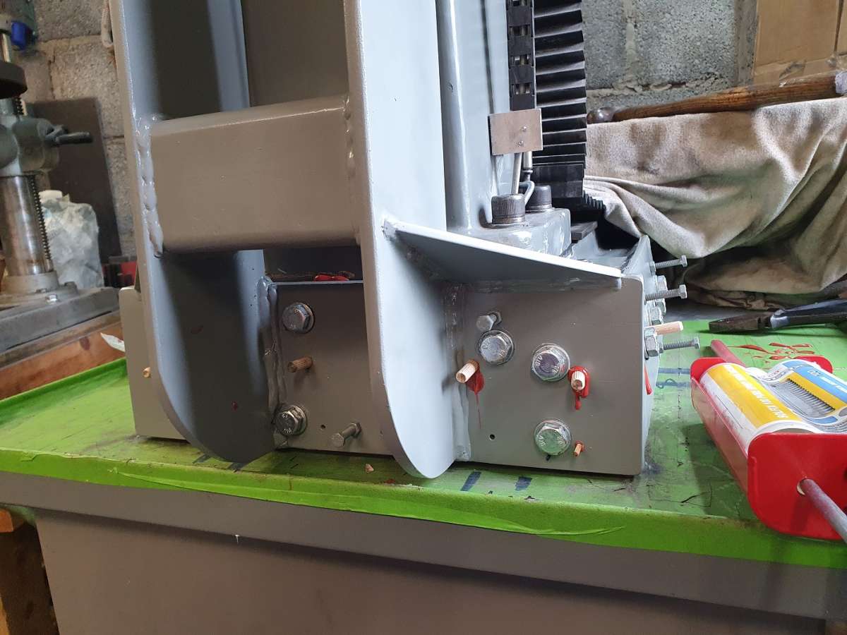

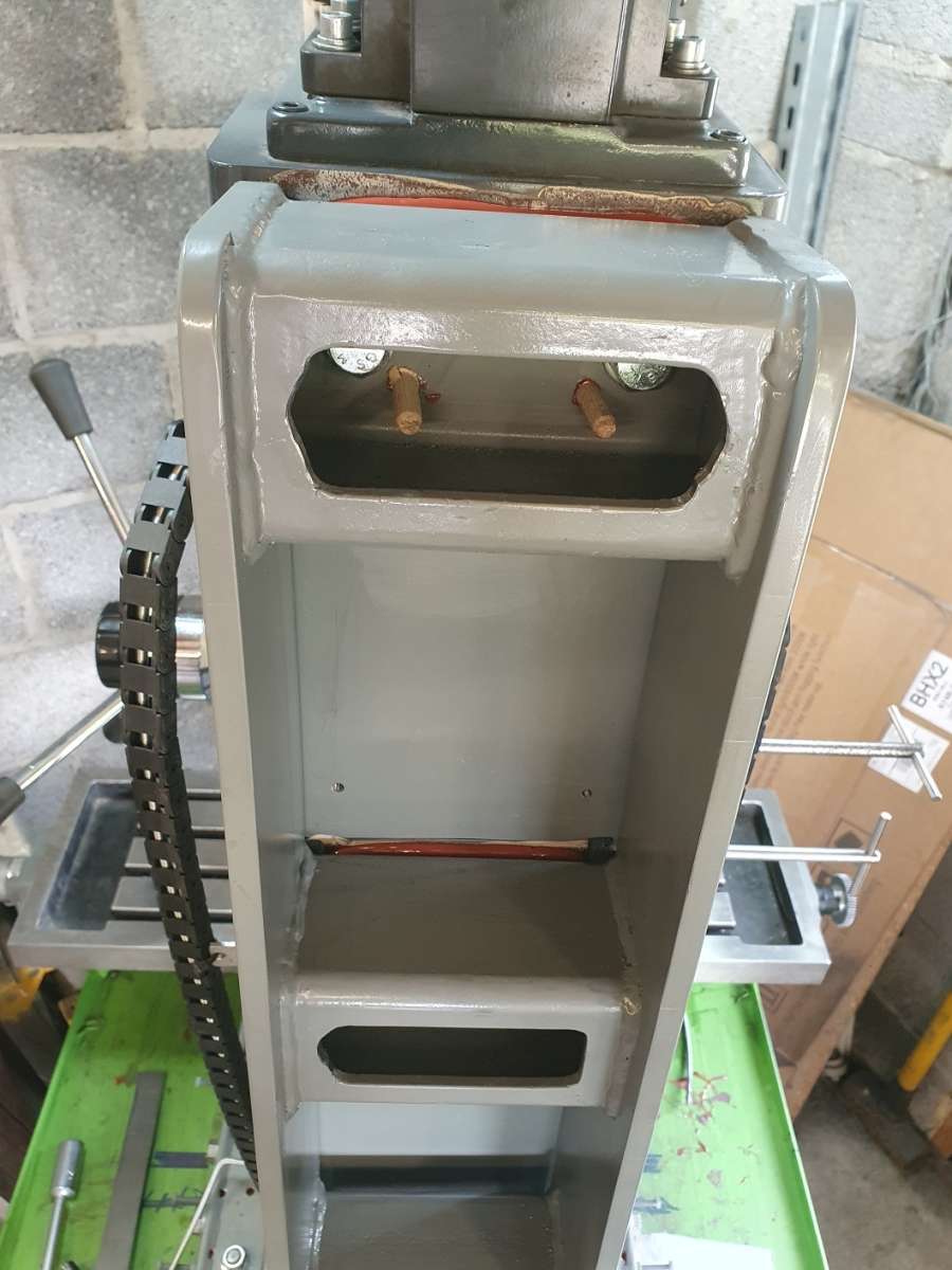

      With the whole thing now painted (other than the bonding surfaces obviously!), skimmed over with a very coarse grinding wheel to better key the bonding areas and thoroughly cleaned it is time for final fit.
      Once fitted I torqued all the bolts up to a pretty low torque of 10Nm just to make sure they were all the same.

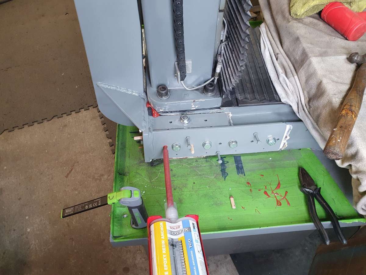

      I then set to injecting the epoxy.. not as messy as I was expecting but none the less it still get to places you haven’t even been near as is usual for anything like this stuff !
      ExSkel_Fitting_1
      ExSkel_Fitting_2

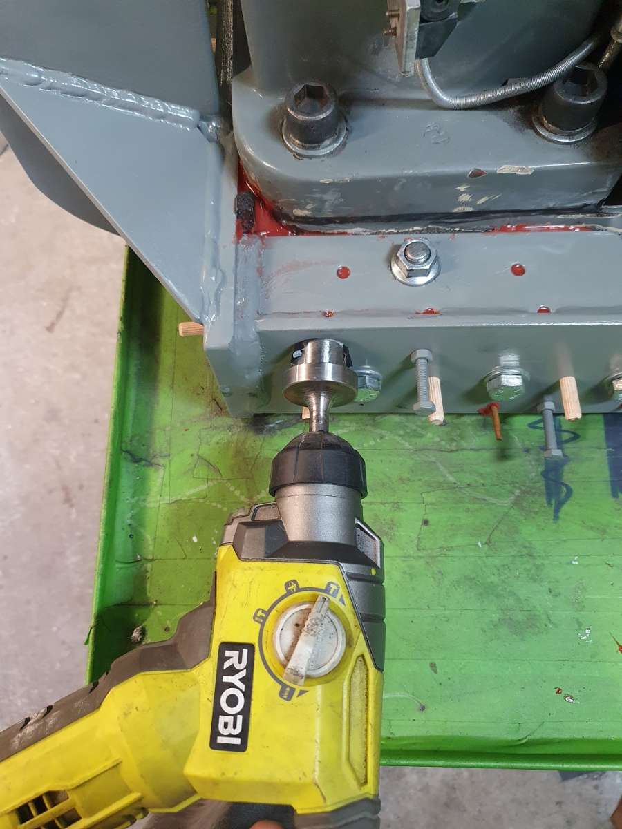

      Once I’d injected an area I broke out the ‘rattler’ 😁 The remains of a SDS socket boring tool turned down to a plunger type thing, bit of gafa tape over the end to prevent scratching and run in the SDS drill on hammer only. it will vibrate pretty much anything like this and certainly helped to get the epoxy to spread nicely.
      ExSkel_Fitting_3
      The holes were then just plugged up with those pre made flat pack furniture building wooden dowels .. well they fitted with a small tickle from a hammer and we’ve all got plenty lying about !
      Once everywhere was full to over flowing and well rattled it was time to leave for at least 24 hours but I ended up leaving it several days.

          Time to inject the top 2 mounting sections to the column. Same procedure although I didn’t use the SDS hammer to vibrate the thing, just some tapping to help the stuff settle.
          ExSkel_Fitting_6
          ExSkel_Fitting_7

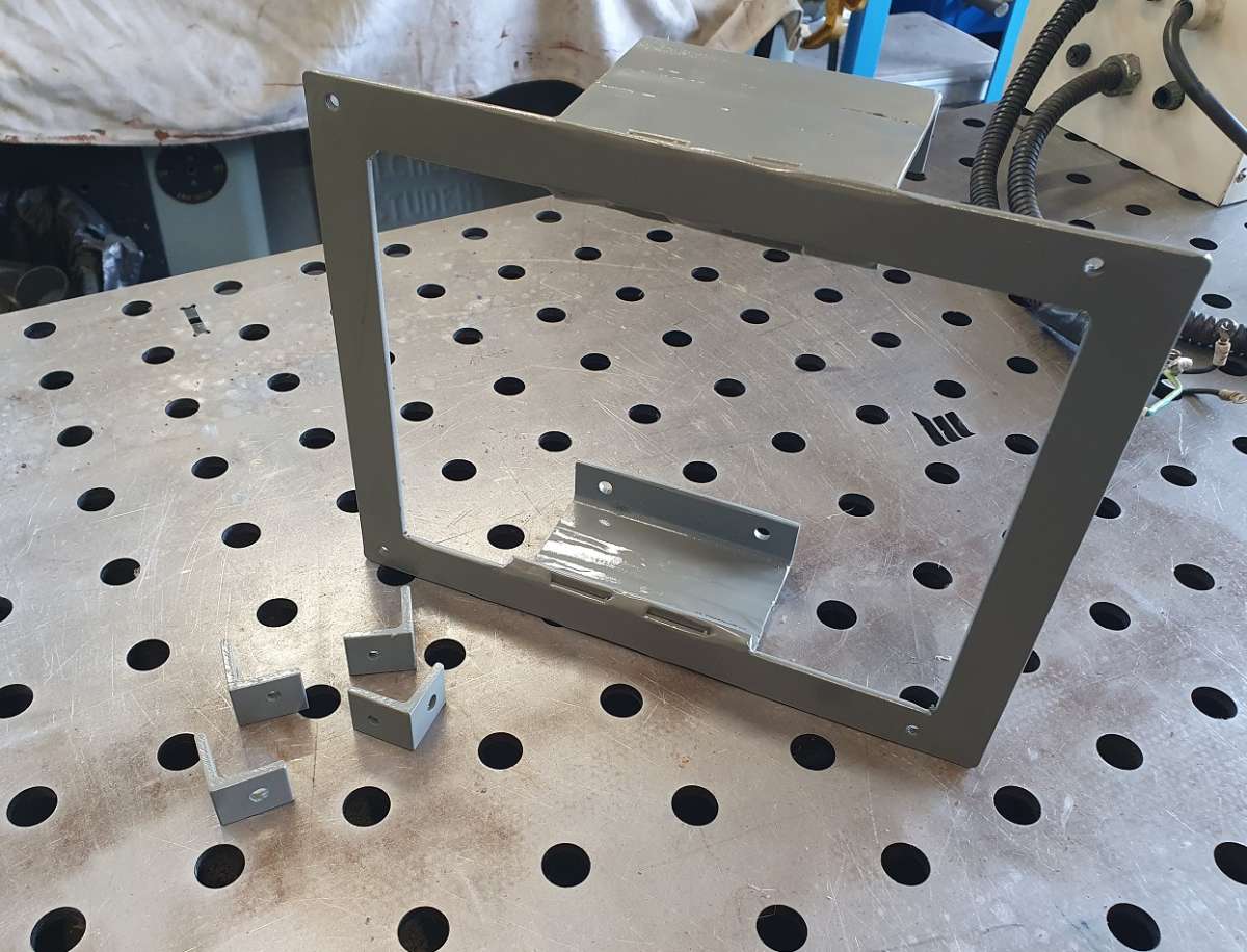

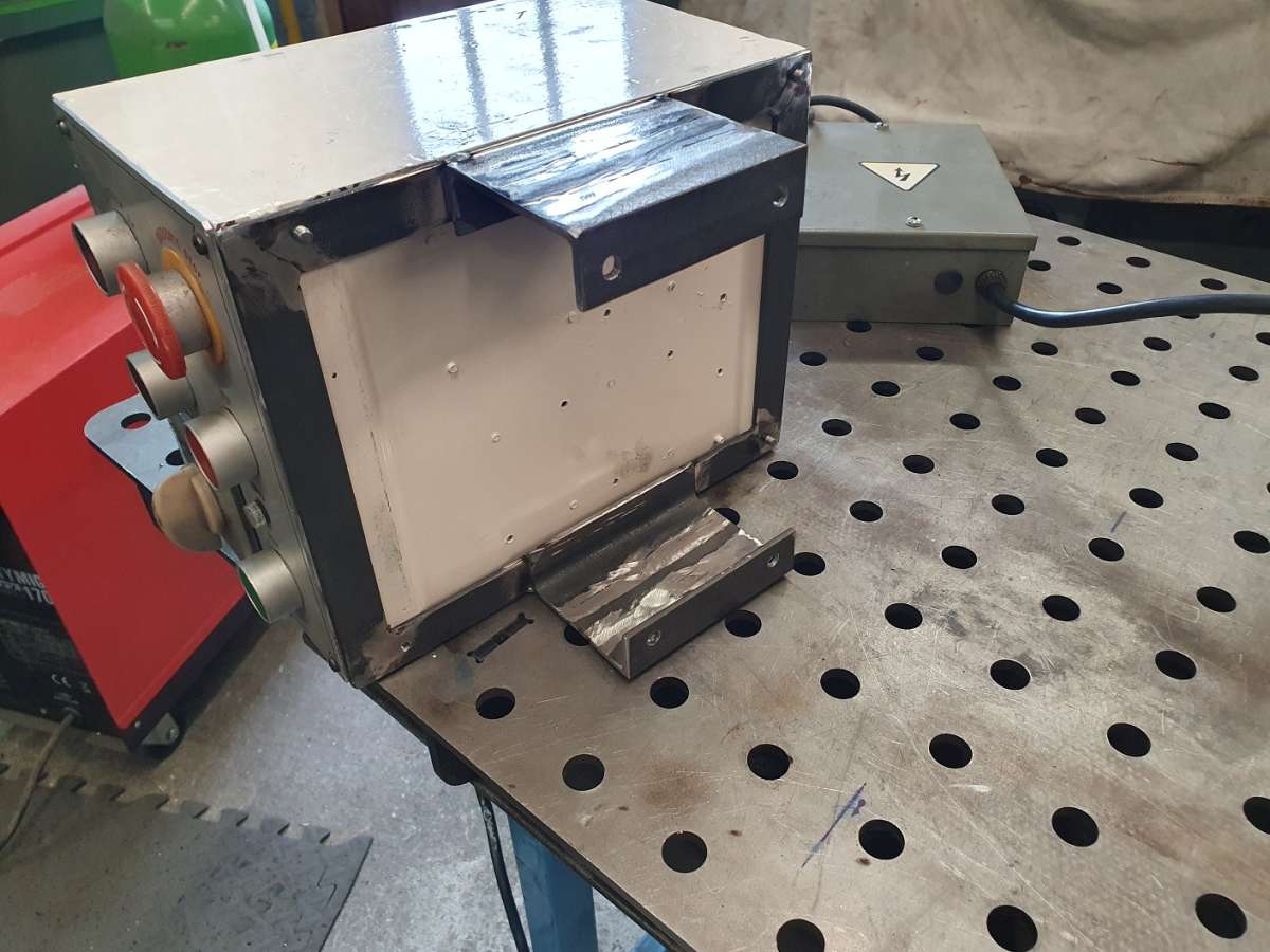

          Next job was to remount the control box and the junction box for the column motor / limit stops etc.
          I wanted to mount the control box on the column rather than the head, partly to save nearly 8KG from hanging on the head but also give better visibility & light around the work and just to keep it out of the way. The only issue would be the need to lengthen the wires to the motor and a longer conduit – easy job so no bother there.
          Time to dig out all the saved bits of scrap to make a mount (I throw nothing away!) .. a few bits of flat bar, some bits of small angle iron and some still poor welding later and I had this –
          Control_Box_Mount_1
          Control_Box_Mount_2
          As well as 4 little angle brackets to mount the rear junction box to the back of the column brace. not bad for the scrap bin.

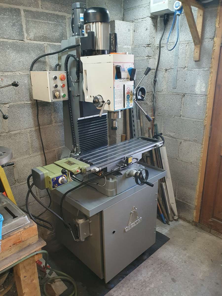

            Well that’s it just about finished …. again!
            I mounted the control box to the column and to be honest I much prefer it there, yes it’s a little further back but it just feels better being a little out of the way yet still with very easy access. I did have to shorten the column gib lock handles though, the previous owner made quite long T handles for easy access behind the control box which was great.
            Next job was to paint it all …. again … and refit the oiler manifolds, pump and pipework which other than 2 new tapped m6 holes in the side of the brace was the same as before.
            Anyway, here is the (almost) finished product –
            Finished_Pt_2
            I say almost as I still haven’t fitted the DRO!
            I’m quite chuffed that despite all the messing about with it, it doesn’t look that different to before.

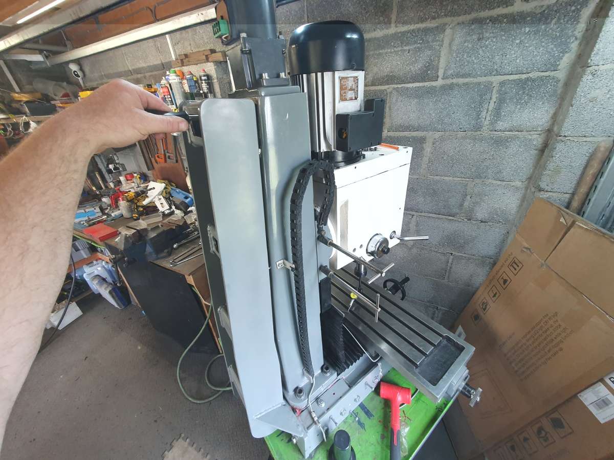

            I suppose the question is did it make any difference?
            The problem is I didn’t take a video of the movement before so unfortunately you will just have to take my word for it as to how much movement there was, sorry!
            I had to wait for a mate to come down my neck of the woods  again before I could get a video but here it is.
            https://youtu.be/dcUscyJs2iU
            With said mate (yes, I do have 1!) giving a fair push on the top of the motor so as far up as possible for best leverage the movement is down to 0.01mm. I’m sure with some more OOomph we could get it a little more but I would say that is plenty successful enough and I’m well chuffed !!
            The real proof is in the cutting though and I had actually done a fair bit of that before being able to take the measuring video.
            Re mount the 50mm 5 flute shell mill and give it some work to do on some mild steel as before. What a difference!! A 0.5mm depth of cut at 540rpm (Seemed to be it’s happiest speed but maybe 300 ish would be better) on a 45mm wide piece of steel so almost full cutter width, it ran no bother at all, no crazy noises from the top end (I swear some of it was the centrifugal switch rattling in the motor as well as gear chatter!), no sparks just decent cutting with a reasonably quick feed rate (Not sure what as I didn’t time handle turns / min).
            I’m pretty sure it could do a deeper cut but I wouldn’t like to run that on a full width cut, lets not be too cruel to it just yet.
            I will try to get a video of it cutting but it will look perfectly normal. I think somewhere I took a video of running the cutter at full speed (with plenty of sparks as it was slightly harder steel than EN1 but was the only way I could run it to get a cut) but not it running at a sensible speed with the resulting noise and surface finish etc as I never wanted to run it long enough to do that, the noise was horrific!
