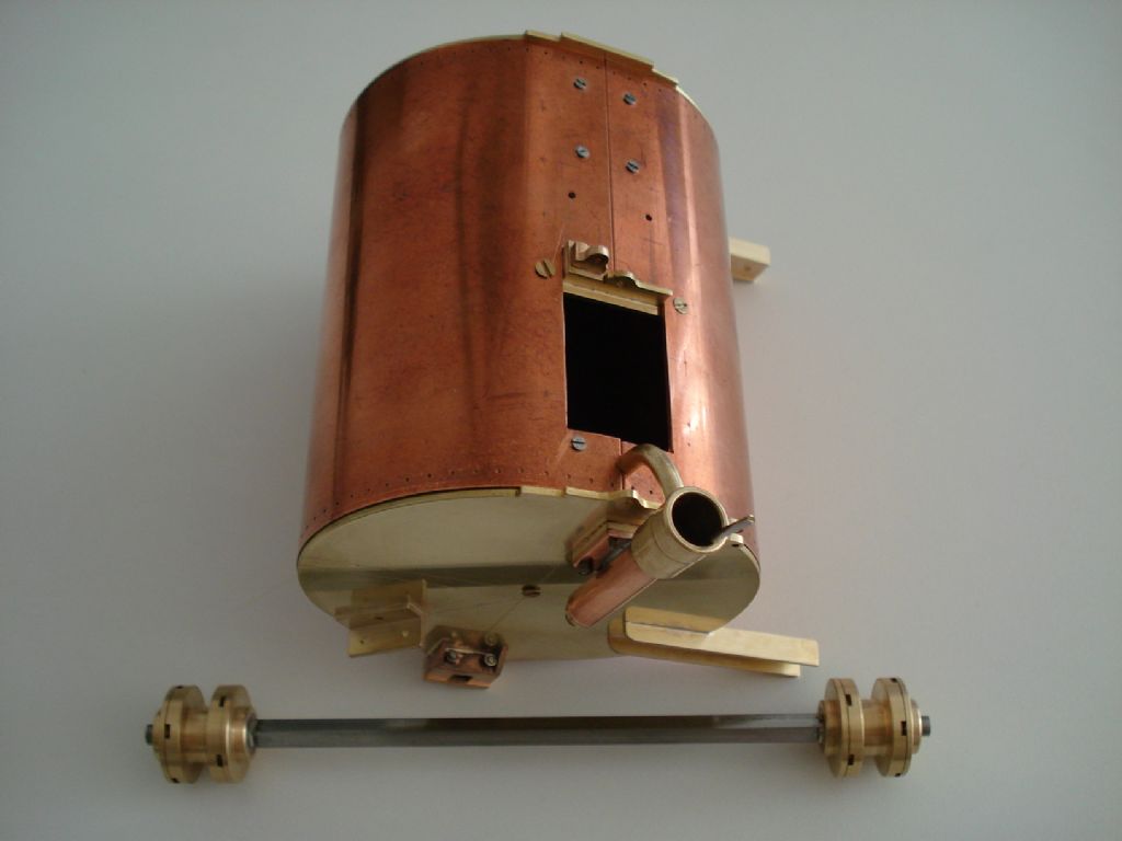

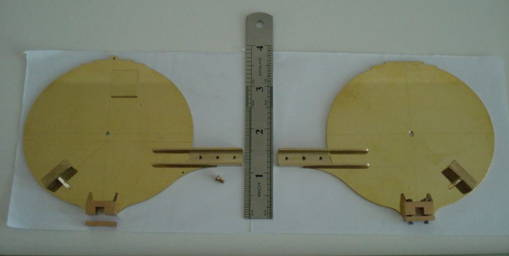

          Silver soldered the side plate parts and trial fitted the pump on my Wallis and Steevens Water Cart.
          Used my recently obtained Vortex V3 blow torch and very pleased-

            Is that a four inch ruler? First one I've seen! Nice work by the way.

              Great work Richard! it's coming along.

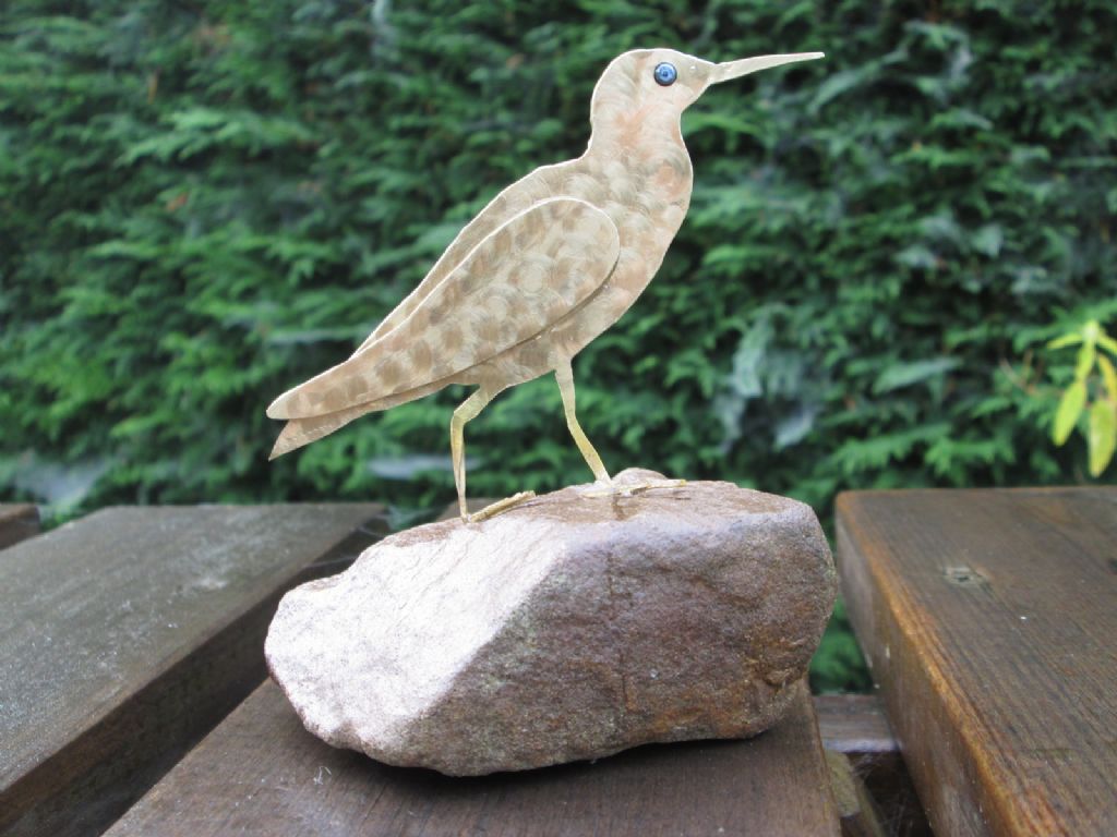

                  Finished off the sandpiper ornament I was making. It was cut on a scrollsaw from half-hard brass sandwiched between two bits of thin ply, 'feathered' with a bit of oak dowel in a bench drill chuck with a dab of slurry from the WD40/1500 grit wet&dry polishing and a smear of fine grinding paste. It looks a bit better in reality than in the photo.
                  It occurred to me that I should've represented the eye-bar that some sandpipers seem to show, but I'd already lacquered it before I thought of that.
                  The family like it, anyway…

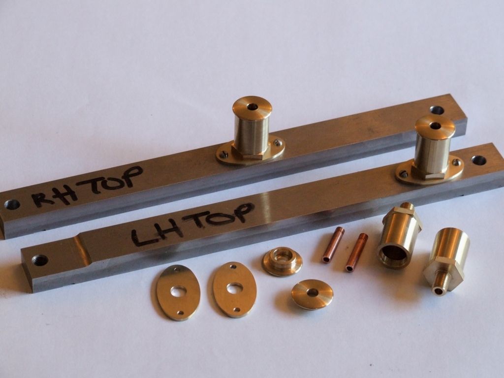

                          FInally finished the oilers for my traction engine slidebars:
                          Both the slidebars, machined from gauge plate, and the oilers have been redesigned to accord with pictures of a fullsize engine. The oilers are intended to be proper wick feed; time will tell if they work.
                          All external threads (32tpi and 40tpi ME) were screwcut; internal threads used taps. One would have thought that these were all simple parts – don't you believe it! I bought a set of 7/16" x 32 taps for an internal thread. I'm pretty sure the taps are screwcut carbon steel. The bottom tap takes out a few thou more compared to the taper tap. There is a model engineering saw that says this, although I've never seen it stated in the literature. Also never seen it with ground HSS taps. The thread size was off too. For the mating external thread, starting at nominal diameter, the internal thread was a rattling good fit nearly 5 thou before the theoretical thread depth of 20 thou was reached. Never seen that before either, normally have to go full thread depth plus a couple of thou to get a nice fit.
                          Given how simple it should be I had a lot of trouble with the elliptical base. Easy enough to draw in 3D CAD. But for some reason on import into my CAM program it fudged the model making it difficult to select features and causing my CAM program to fall over ever time I tried to generate a toolpath. I also discovered that the hole pocketing routine in my CAM program doesn't work. It claimed to generate a helical ramp down and then a clean up. But backplotting the G-code just gave a straight plunge, and PathPilot barfed at the code with all sorts of circular plane errors. Once I got working G-code it only took 50 seconds to pocket the central hole and profile the outside.
                          All I can say is I hope future parts go rather better, or I'm going to working on the engines for a loooooong time.

                                Andrew, your elipse problem may be down to Alibre, following the recent major update there were issues exporting elipses, I got a temorary fix from Jeff via support though the very latest smaller update may have fixed it now.
                                I've also had/got some sloppy ME taps and dies, I see you.

                                  More down to Geomagic. On my old computer I'm still using a 2014 version of Geomagic. In desperation I created a new part on my new computer which which runs Alibre 2019, and imported that into the CAM program. It still had the strange artifacts on the model, but circles and edges could be selected, unlike before.
                                  One of these days I'll move all the Burrell stuff over to the new computer.
                                  Andrew
                                  Edit: after I'd created the new part Alibre offered me an update. Big mistake, after a hiccup in the process it "helpfully" wiped Alibre from my computer. With some help from the UK agent I eventually got it all back again, including my custom text file that lets me explicitiy use English threads, such as BSF, BSP, BSW and BA in models.

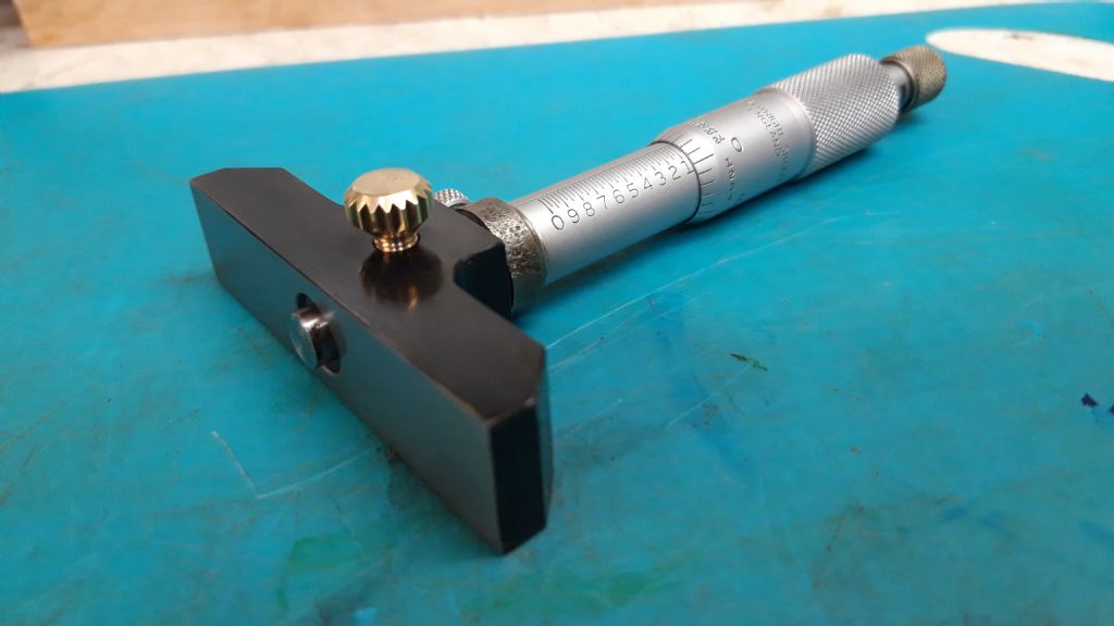

                                            Finally got round to making a base for my Moore & Wright upside down micrometer head, which I've had in the drawer for about thirty years, so it deserved a day out! Now I've got a 1 inch depth micrometer!
                                            The base is a piece of key steel which was tough stuff for my little machines. There is a small built in deliberate error, the height is a couple of thou small, but the little brass screw allows the head to be self calibrated easily enough, it then holds things nice and tight. Although thinking about it I might just try rotating the sleeve to take up the error doh! I checked for perpendicularity by rotating the head 90 / 120 degrees and was about 0.0002" out, which isn't too bad.
                                            The main reason I made it was because of restricted height on my small mills, I've been using a 6 inch digital caliper which is not ideal.
