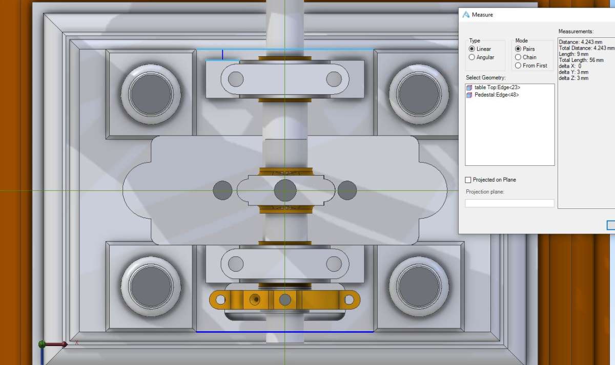

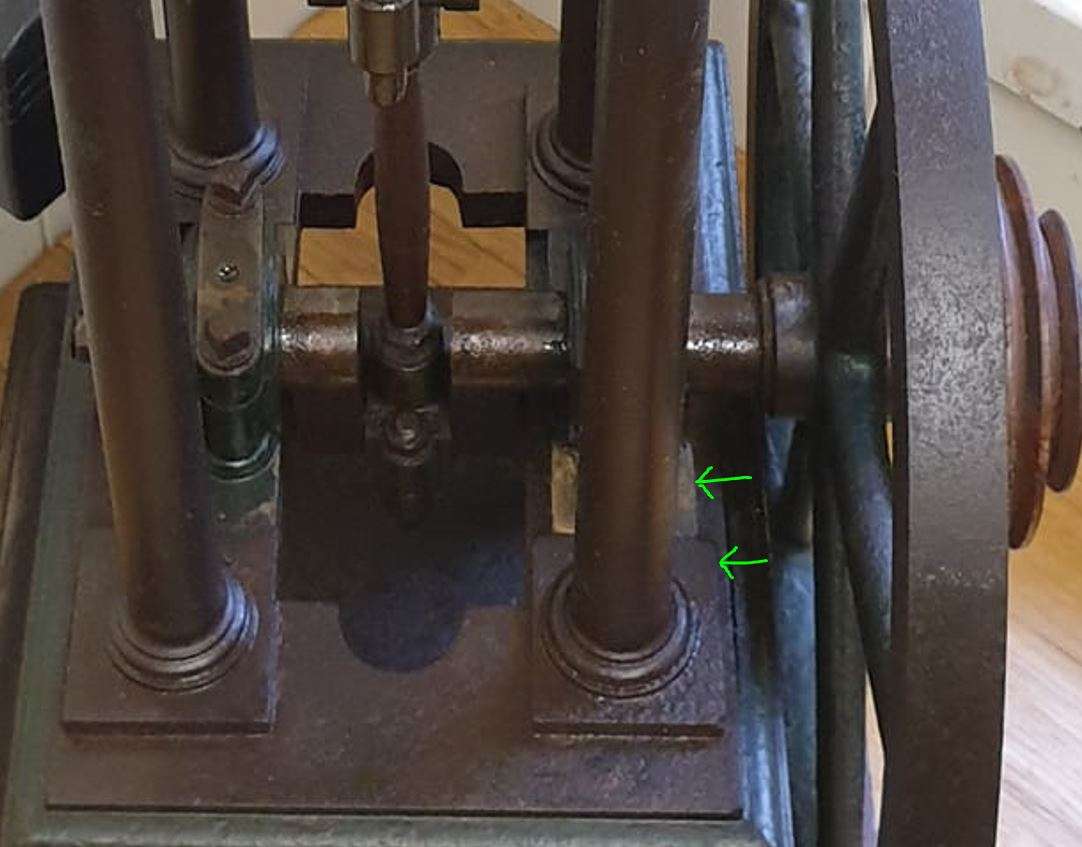

                                      Does the edge of the F/w-side pedestal sit flush with the outer face of the column base squares? ..😁..
                                      #797343
                                        No, 3mm in from the bases. You could move it out further to give a bit more support to the flywheel , just make that side of the crank wider to suit.
                                        vickers 3mm
                                        vickers original
                                        #797348
                                        Diogenes
                                          @diogenes
                                          Perfect – Thank you!

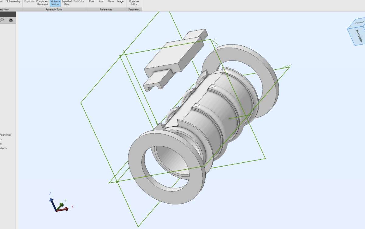

                                              Still in two minds whether to do this in CI and JBWeld, or hard-solder it (- just to see whether I can do it).
                                              The example below needs the valve ports / exh. outlet arranging, but is essentially ‘The Plan’ – bore is 30mm, O/A length 73mm.
                                              If I solder it, what kind of ‘clean-up’ allowance should I leave on the bore and flanges – I can see that it will go banana-shaped..
                                              In terms of ‘strategy’ I thought I might solder the one piece ‘passage insert / valve base’ block in first, and then cool / clean up and add the flanges one at a time either end – not likely to break the existing joints under the block in this case, the ends / rings will heat very quick?
                                              I’d use 55% with HT5..

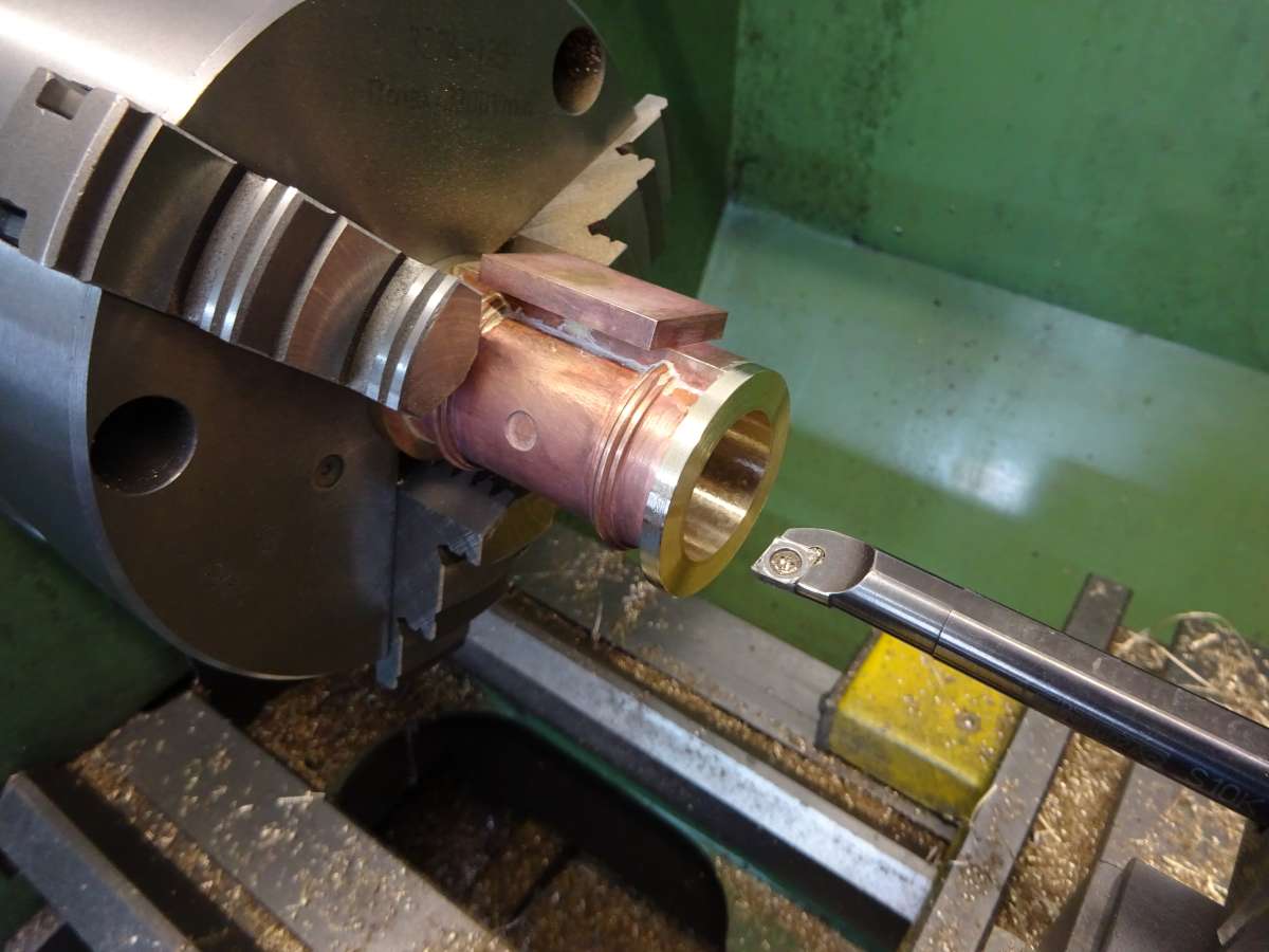

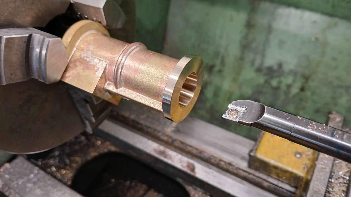

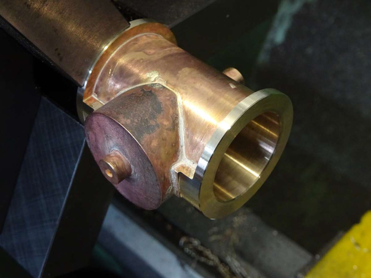

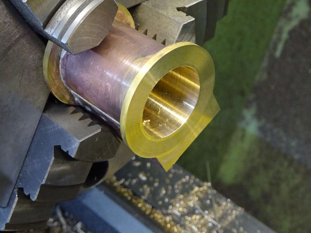

                                                    I’ll reply about the fabrication a bit later, hopefully it will give others a chance to chip in.
                                                    #812828
                                                      For a soldere dfabrication like that I would make the bore 28mm which gives enough for finish cuts but does not leave you with too large a mass of metal that is hard to bring upto temperature.
                                                      The flanges I would allow 0.5-1.0mm extra thickness and 1mm extra diameter. If you also make the spigots almost a slong as the thickness of the rough flanges then you will have sufficient to face right across. By keeping the spigots just short of the outer faces of the flanges you can put a bit of studding through and lightly hold it all together with penny washers or two flat bars.
                                                      I would also leave about 1mm extra on the port face for final finishing true to the bore. You are basically fabricating a casting so want a little metal where a casting would have it and that allows for any movement that may take place during soldering
                                                      You can mix and match materials a bit depending on whats available. Hollow bronze for the main cylinder and brass flat for the flanges is OK.
                                                      I’d do it all in one heat but if you are not used to it then working in stages may be safer.
