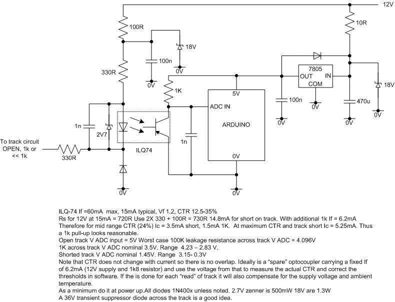

          All getting a bit complicated, but easy teaches you nothing and so is boring. Just in case others can’t see the schematic, here it is again

            Hi Duncan,
            Good spot! I used two 330R resistors rather than a single 680R for a couple of reasons. The first was so there is an impedance in series with the LED in the opto-coupler and it’s protective Zener for surges coming from either the 12V supply end or the track connection end. This is mostly for very fast pulses were the stray capacitance can make a difference.
            Secondly it divides the voltage across and power dissipated in the two resistors making them less likely to fail.
            If you want to try something across the tracks I have some new old stock 100W 47V stud mounted Zeners…

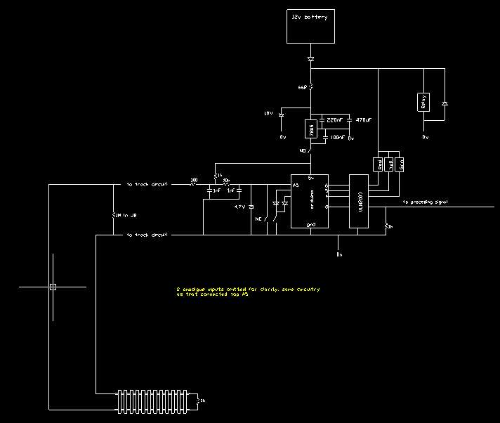

              I got all the signals fixed with the old design in time for the steam fair, so now I’m looking to the future. As the signals will not be operating when thunder is likely, I’m considering a combination of SOD and RobertA schemes, using a relay to ground the inputs when the power is off. I think a suitable one is HK19F dpdt, pcb mounted. I don’t understand the data sheet, in particular the coil resistance table, the max operating voltage of 9v for a typical 12v relay, and the minimum dropout. I suspect the latter 2 are mistranslations and max should be switched for min, but the table of coil resistance has me baffled. Anyone any ideas? What would be really neat is what I might call an untransistor, which conducts  when no external signal applied, but goes open circuit with a control signal. I’ve never come across such a device, but you clever chaps might know of something.
              Second issue which has come to light is that rodents are attacking the cable from the signal to the JB. As the signals were built in batches, we have 2 types of cable, one has grey outer cover and has stayed flexible for a long time, the other is black and has gone very stiff, no doubt due to exposure to UV. Anyone got suggestion for a type and source, I need 6 cores, braided screen, around 1/4″ OD, tastes bad to rodents. Current is trivial, 80mA max at present but would increase if relay fitted (which might rule that out)

                                      I got the system up and running in time for the steam fair, but it came back to bite me a couple of weeks ago. Not lightning this time, one of the ULN2003s failed and instead of being an open collector with a 1k pull up to 5v it started outputting the ~12v supply to the preceding signal. Arduinos don’t like 12v on their inputs, so yet more repairs, made considerably easier by having the Arduinos on sockets this time.
                                      I’ve tried my best to lay out a new board incorporating opto isolators but failed, there isn’t room in the box. I do have 3 inputs on one of the signals, so it’s a lot more complicated than the schematic shows. I have therefore dreamed up the attached, which I hope incorporates the best features. It now has 100 ohm at the input, capacitor to ground, 10k from the nominal 2.5v point to the actual input and a 4.7v Zenner and a cap from the input to earth. When the system is switched off, all the inputs are pulled to ground via a relay. To avoid having a 3 pole relay, in the case of 3 inputs 2 of them are grounded via diodes. In the normal 2 input scenario I’ll just leave out the diodes and put a link in place of one of them.Screenshot 2026-08-10 172016
