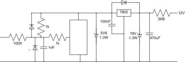

                    #851522
                    Robert Atkinson 2
                      @robertatkinson2
                      input protect

                        I could have sworn I’d responded to this last night, must not have hit submit.
                        Thanks for that, I’ve saved it and the next batch of boards will be modified in accordance, but as I said before, I need to get the damaged signals up and running quickly before next public running.
                        Just a couple of questions to aid my understanding (never stop learning).
                        According to interweb “The ADC is optimized for analog signals with an output impedance of approximately 10 kΩ or less”. Does this mean that the 1k you show connected to the Arduino could be 10k? Would it be better to move the 1nF to the Arduino end? Could it usefully be bigger?I’m not looking for blistering fast response.
                        The LEDs are fed direct from the 12v, so the current to the processor is very low, I’ll measure it, but guess a few 10s of mA. Why is the 5R6 resistor so low? Is it to allow excess voltage to go back into the 12v supply?
                        I don’t think this matters, but according the the 7805 data sheet there should be 0.1uF across the 470uF and 0.2uF across the output. Both of these seem to be optional
                        #851578
                        Robert Atkinson 2
                          @robertatkinson2
                          Hi,
                          You could use a higher series resistor at the ADC input pin but I’d add an additional 1nF capacitor to ground at the input pin. This is because the ADC tends to draw current in pulses de to the multiplexer and the capacitor improves accuracy.
                          I sized the 12V input resistor low as I wasn’t sure if you had other loads on the 5V. It should be sized to drop about 4-5V at the maximum load but it’s not critical.
                          A “7805” is a generic number for a wide range of devices. Requirements for input and output capacitors depend on the exact (make and full part number) device. Typically you need a 0.1 across the input if the device is more than a few inches from the filter capacitor typically found in a mins supply. The 470uF fulfils this requirement. A capacitor on the output helps with noise and stability.and is mandatory for some specific devices.

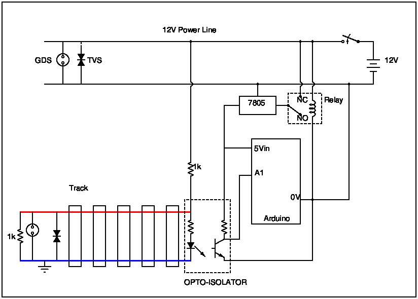

                                The main problem as I see it is that Duncan’s design connects a delicate high-impedance 5 volt microcontroller between two large antennae!  The set-up is as likely to pick up static electricity in a thunderstorm as Benjamin Franklin’s kite and key experiment.
                                I suggest isolating the Arduino (which is tried and tested functionally) from both the track and the 12v power line.
                                A Model Engineering signalling system is probably turned off until the track is needed.  Therefore, when the track isn’t being used, the Arduino signal units can all be physically disconnected from the power line.  Can be done automatically with a relay, and the miniature 5V types common in Arduino-land should provide about 1.5kV of isolation.   I also suggest bridging the 12V supply with a Gas Discharge Tube and a bi-directional Transient Voltage suppression diode.  These are specifically designed to protect against surges and cost less than 50p each.
                                The same devices should also be applied across each section of track, hopefully limiting the voltage it picks up.
                                The other major problem is connecting the track direct to the Arduino’s A1 pin.  A1 is fitted with an Analogue to Digital Converter with an input impedance of about 5MΩ, max input 5.1volts, so it stands no chance if a thunderstorm or sultry weather charges the track up with a few thousand volts of static electricity.  The counter-measure here is an opto-isolator with an analogue output, home-made if necessary. As per Duncan’s 3-level design, the LED burns more or less brightly.  It’s full on if the track develops a continuity fault.  Normally half brightness by the potential divider when no train is on the track, and off when a train shorts the rails.   Duncan’s code stays the same, the difference being there is no electrical connection between the track and the Arduino’s delicate ADC.
                                isolatedRail
                                None of the suggestions, including mine, would protect against a direct lightning strike, but that’s very unlikely – Duncan would have noticed more violence.  A house in the village was struck last year, and the damage was very obvious – half the chimney stack disintegrated, and about a quarter of the tiles blown off.    Duncan’s signals were probably destroyed as described by Macolm due to being inside the voltage gradient between ground and a charged storm cloud.   Playing amateur radio, I’ve seen sparks jump 5mm to earth from a 10 metre long wire antenna. No lightning, just static electricity.  Takes about 3kV to jump a millimetre, easily generated by rubbing a rubber balloon against a woolly jumper…

                                  Michael Faraday reckoned he learned more from failed experiments that successful ones. I’ve just spent all afternoon failing, bt have finally learned something.
                                  Those of you who have been following this thread will know that I’m building 7 off replacement control boards. Rather than using Arduino minis, I’ve decided to use Nanos, as they are much the same price nowadays, and I’ve been having problems programming Minis since changing computer and upgrading to W11. The pins fit in the same holes, the only difference is that instead of A1,2,3 on the Mini, the corresponding pins on Nano are A4,5,6. No problem think I, just change the pin allocations.
                                  It’s taken me all afternoon to discover that A5 & 6 are analog only on a Nano, and INPUT_PULLUP, DigitalRead and DigitalWrite simply don’t work. Putting in a physical pullup, and using analogRead/Write solved all the problems.
                                  I’ll have to have a good cogitate about SOD’s suggestions, the idea of a 3 level opto-isolator is new to me. Is such a thing available as a chip?

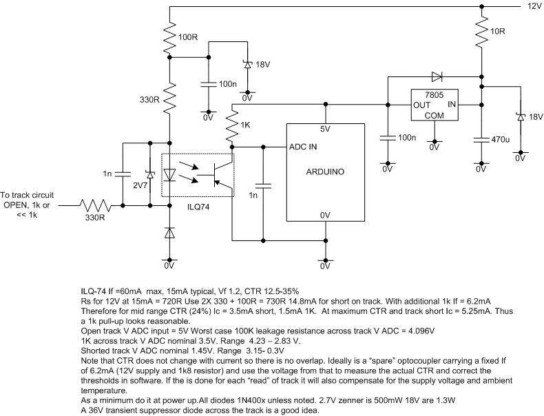

                                          Robert Atkinson 2
                                            @robertatkinson2
                                            EDIT:
                                            sorry, I somehow missed SOD’s post (are we still suffering from disappearing posts?). Sorry Dave. Dave’s scheme is basically the same as I was thinking of. I think there is an issue with the relay circuit on the power supply but Dave has much more pressing issues at the moments than model engineering.
                                            I had not seen his post when I wrote the following:
                                            OK so your 3 states are:
                                            Open (leakage current only) = fault or open points
                                            1k = Track not occupied
                                            Short (train resistance) = Track occupied
                                            Is that correct?
                                            I assume you have a 1k resistor across the end of the track.
                                            I think I can make a reasonable opto isolator design with that.
                                            The ULN2003s are surviving because A. They have relatively large semiconductor junctions being power devices and B. they have protective diodes from output to supply.
                                            I’ll knock up a detailed design.
                                            Robert
                                            #851950
                                            Robert Atkinson 2
                                              @robertatkinson2
                                              My design:
                                              Track monitor scheme
                                              The ILQ74 is a quad device so only one needed per board. The nodes marked 0V should be a low impedance ground plane, single earth point or similar.
                                              If not using automatic compensation, you should measure the current transfer ratio (or output voltage for each of the three states and adjust your thresholds to suit.
                                              Robert.

                                                Thanks, I’ve ordered a couple of ILQ74s to play with. Hopefully the Nanos should have come from China by the time I get home,  so I should have a batch ready for tomorrow.
                                                I’m still smitten with SOD’S relay, but altered so that when power is off it shorts the inputs to ground. Its simplicity appeals.
