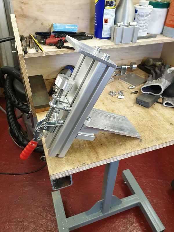

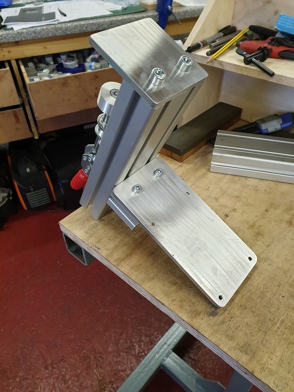

            Now that winter is approaching and I`ll be spending less time in the workshop and more time in X4 Foundations space sim I decided its time to make the HOTAS desk clamps that are far too expensive to buy.
            Joystick one above more or less finished, just need to get some 8mm countersunk screws to replace the hex head ones. Need to do this on both clamps.

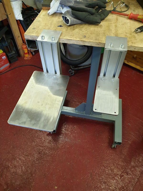

            Both clamps fitted to my workshop table. The throttle one on the left needs the holes drilling and tapping to fit the throttle base when it arrives. Hopefully Virpil will get round to dispatching my order soon.

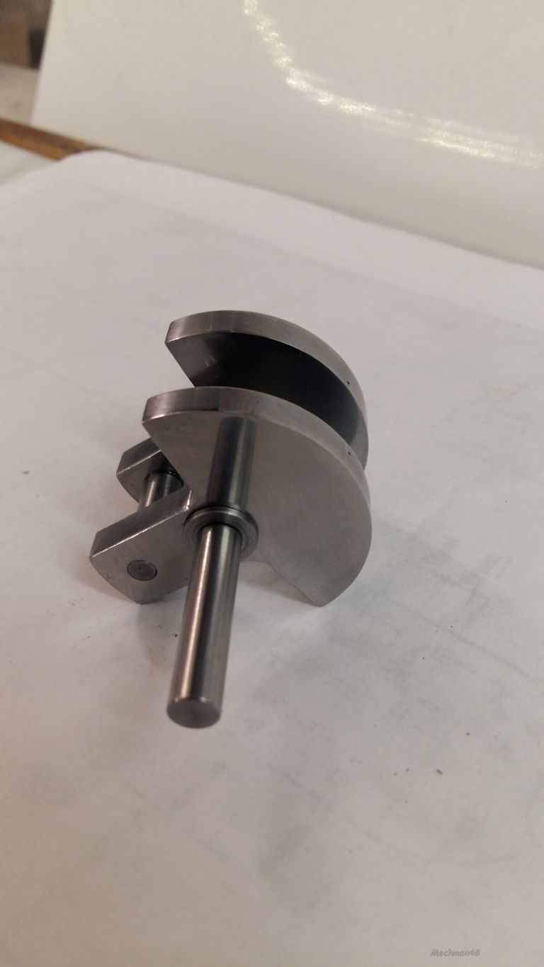

                                        Got back to work on my latest project; beam engine, machined up the crankshaft / webs. Remembered to polish up at this stage as it makes it easier in assembly stage. All the shafts are press fit into webs with a touch of Loctite 603. Maybe I should drill & pin the bottom end shaft… thinking
                                        George.
                                        #432363
                                        geoff walker 1
                                          @geoffwalker1
                                          Well if you were asking me George, pin them. Belt and braces job!!!!
                                          I have some 1/16" panel pins which mike up at 0.061" perfect with a 1/16" drill and drop of loctite.
                                          Nice work George
                                          Geoff
                                          #432365
                                          mechman48
                                            @mechman48
                                            Geoff… thanks, have got panel pins similar size to yours so will drill & pin cool

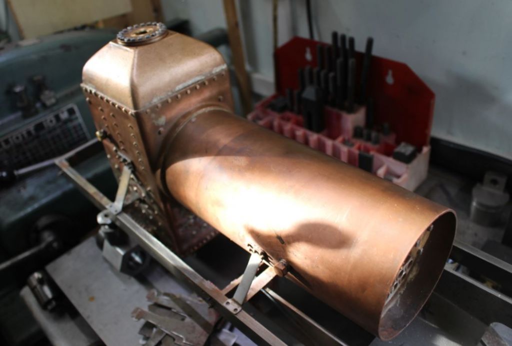

                                              I've occasionally posted on here my progress building my Lion boiler, I had taken lots of video and have decided to have a bash at building a video series of my build.
                                              Today I uploaded my second video, for any one interested here's a link: Lion Boiler Build pt2
                                              Part 1 is an introduction which is here :Lion Boiler Build pt 1
                                              Here it is finished, now I'm busy with the frames, horn plates and wheels.
                                              I hope my videos help anyone thinking of building a model of this historic loco.
                                              BTW, Very nice work George on that crank.
                                              Nigel

                                                  Thanks Nigel; boiler lookin' gooood, very nice boiler work.
