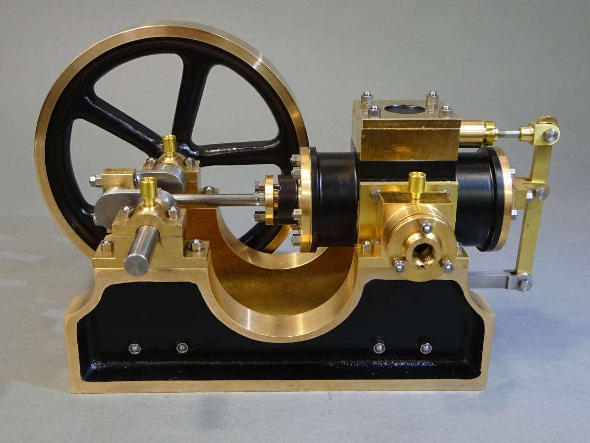

                  GM needs good sharp tools, can me soft so watch out for chuck jaws marking it or excessive clamping force on the mill. It can also grab drills.
                  You are unlikely to get hard chilled areas like you do with iron but it can have blow holes or oxide inclusions which are very abrasive and will take the edge off a tool.
                  Otherwise it machines easily, I tend to use the **GT inserts and carbide on the mill too. This one was all GM castings
                  DSC04700

                      Having not machined castings and being self taught with bad habits I will check out a few you tube videos . Any small parts I usually mill it still on the bar so haven’t tried to machine a small part like these castings .
                      Nice looking Horizontal engine.
