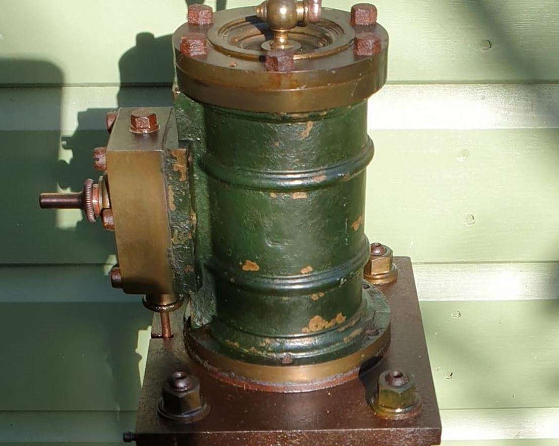

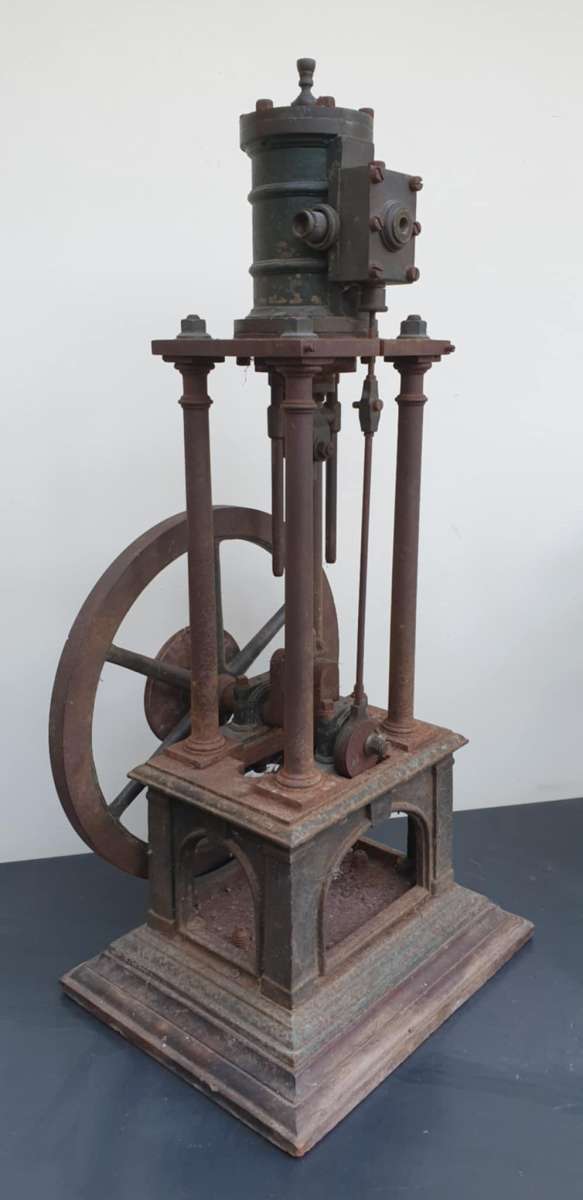

      One of the collectors on The Stuart Models FB page posted an image of his new addition a few months ago and I thought it would make a good model.
      Vickers Table
      No idea if it is based on any specific full size engine or was ever offered as plans or castings but the cylinder and valve chest do have the look of Stevens Model Dockyard about them so it may have been built using one of their sets of cylinder castings. I’ve named it after the guy who now owns it.

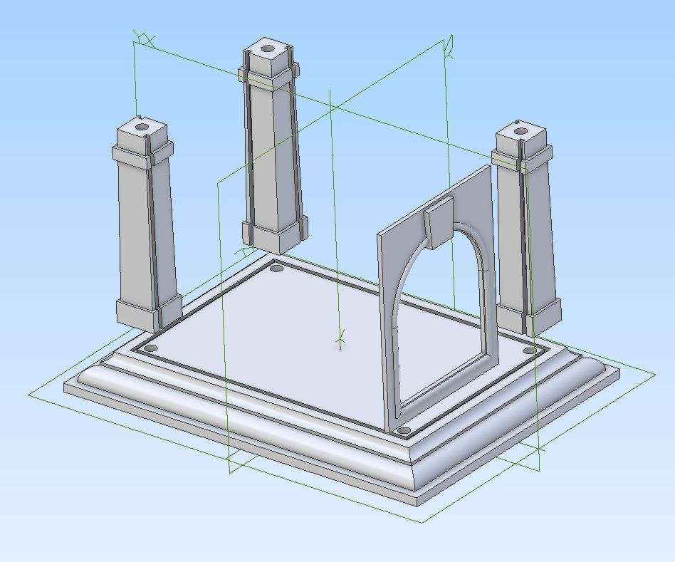

      As it was on the Stuart Group and there was some interest from others who may want to build it I thought I should at least include one Stuart casting. The proportions are not quite right to use both a 7″ flywheel and their 2″ x 1″ cylinder as this engine has a larger cylinder so I drew it around the flywheel as that would probably be the harder part for people to make. First job was to put an image into Alibre and once scaled to suit the flywheel pull a few dimensions off it. This image also shows it stood against an early Stuat No10 for an idea of size, mine will be smaller. I’ve changed a couple of bits I did not like the look of but it is basically the same.

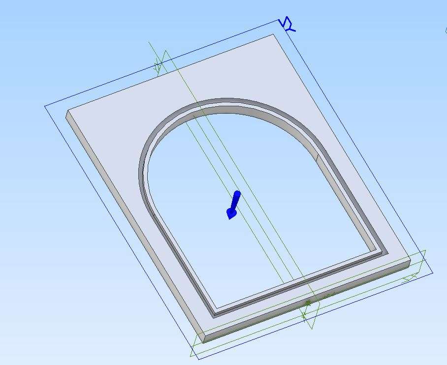

      Over a couple of evenings the various parts were drawn up and assembled, had to spend quite awhile playing with conrod length and cross head guide spacing to make sure the two did not clash but I’m quite happy with the way it looks. I will probably make my own flywheel but the image is with a Stuart one. All metric as is now my norm.
      I made a start on the four panels for the base. The usual practice would be to bend up half round beading and fix around the openings. However 1mm radius beading is not available although not hard to make your own and it also has a tendancy to curl up when you want to to lay flat around a curve. Also the beading was set back only 0.5mm from the edge of the openings. After a bit of thought I came up with a cunning plan. Rather than use half round beading I thought I would try milling a 2mm wide x 1mm deep slot and simply solder some 2mm dia brass wire into the slot.
      The four plates were sized on the manual mill and then over to the Cuts Nice Curves machine to do the slots and cut out the arched hole.
      I use 4 or 5 tabs to retain the waste material rather than risk it coming loose and damaging the cutter or work, they are only 0.75mm high at the peaks so easily sawn through and tidied up with a file.
      After straightening a length of the 2mm brass wire I filed one end to 45deg for the miter joint, clamped that end into the slot and it was then easy to push the wire down into the slot with one hand as the other guided it around the arch and back down the other side. Marke and miter the end then just a straight length for the bottom.
      A bit of flux and some soft solder fixed it all together then a quick cleanup of the small amount of excess solder and they are ready for the “key stones”

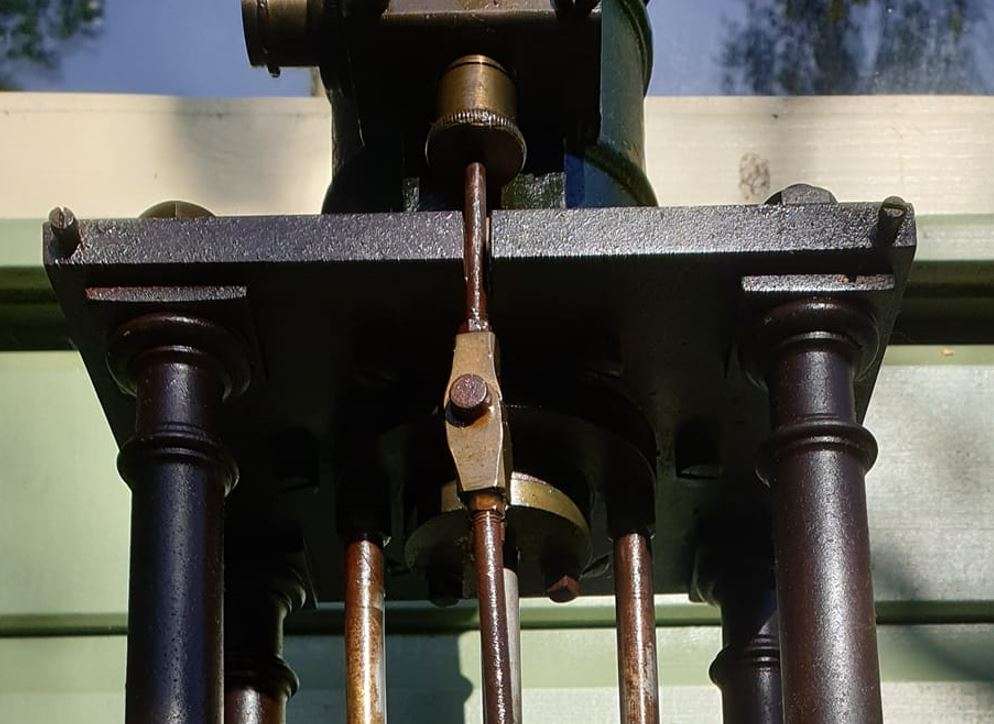

            He is likely to just give it a sympathetic clean rather than the full bling restore. It runs quite nicely so does not really need any major repair.
            Quick capture of the parts moving about, you can see the rod gets quite close to the bottom of the guide bars. There are a few small parts that I have not detailed yet but enough to get going. Oneday Nigel this could be your wagon.

              It’s a really nice engine – do you think the ‘architecture’ and detailing has that ‘Great Exhibition’ look about it?
              It has grandeur and presence.
              #774396
                Certainly does, The owner thinks it is from about 1850 though I suppose it could have been modeled later than that but in the style.

                                Early engines tended to have the heavy cylinder at the bottom so as this one has the cylinder at the top it is referred to as inverted.

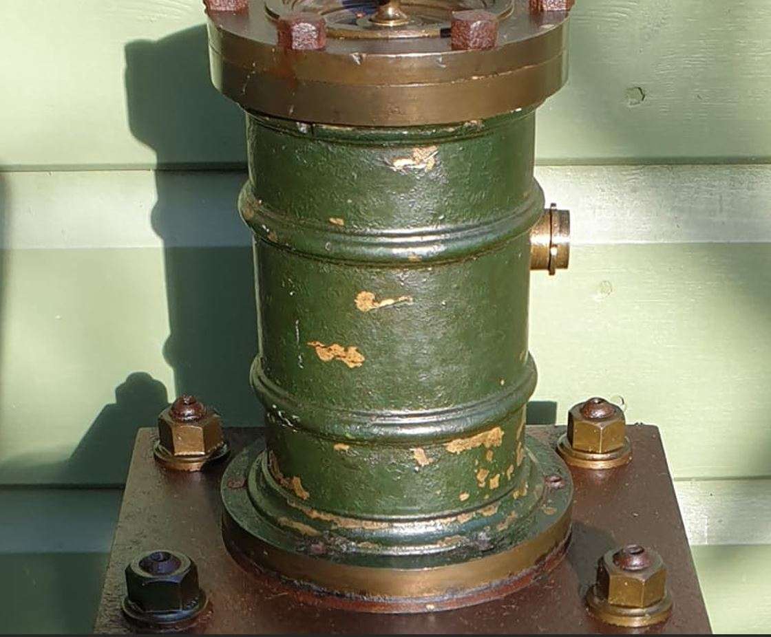

                                              What do you make of the entablature on the prototype – d’you think it originally had a cover over the cylinder?
                                              #781971
                                                The edge of the entablature looks a bit out of place being so plain compared with the more decorative base, I added some detail around it to tie things together a bit more. The only thing I have not been able to work out is what the two studs in the edge of the entablature were for?
                                                vickers studs
                                                As for the cylinder I don’t think it had any metal or wood cladding as there are no signs of fixing holes for any banding. Also the top flange of the cylinder is the same diameter as the cover where as it is usual to have the cover larger so it covers the end of any cladding. At the bottom as the cylinder flange is larger than the top flange that would also have made it hard to fit cladding as there is nothing for it to bear against.
                                                The cylinder is also painted green like several other parts of the engine and you may not have painted something out of sight.
                                                vickers cyl 1
                                                vickers cyl 2
                                                #782015
                                                Diogenes
                                                  @diogenes
                                                  Yes, it was those two studs (and the slabby sides) which made me ask the question – but you are right, the cylinder looks like it was meant to be seen – it’s all very nicely done right down to the fillets on the nut flanges.
                                                  Maybe the studs supported a kind of cornice or ‘trim strip’ to cover the gap for the valve rod..
                                                  Thanks very much for the extra pics 👍

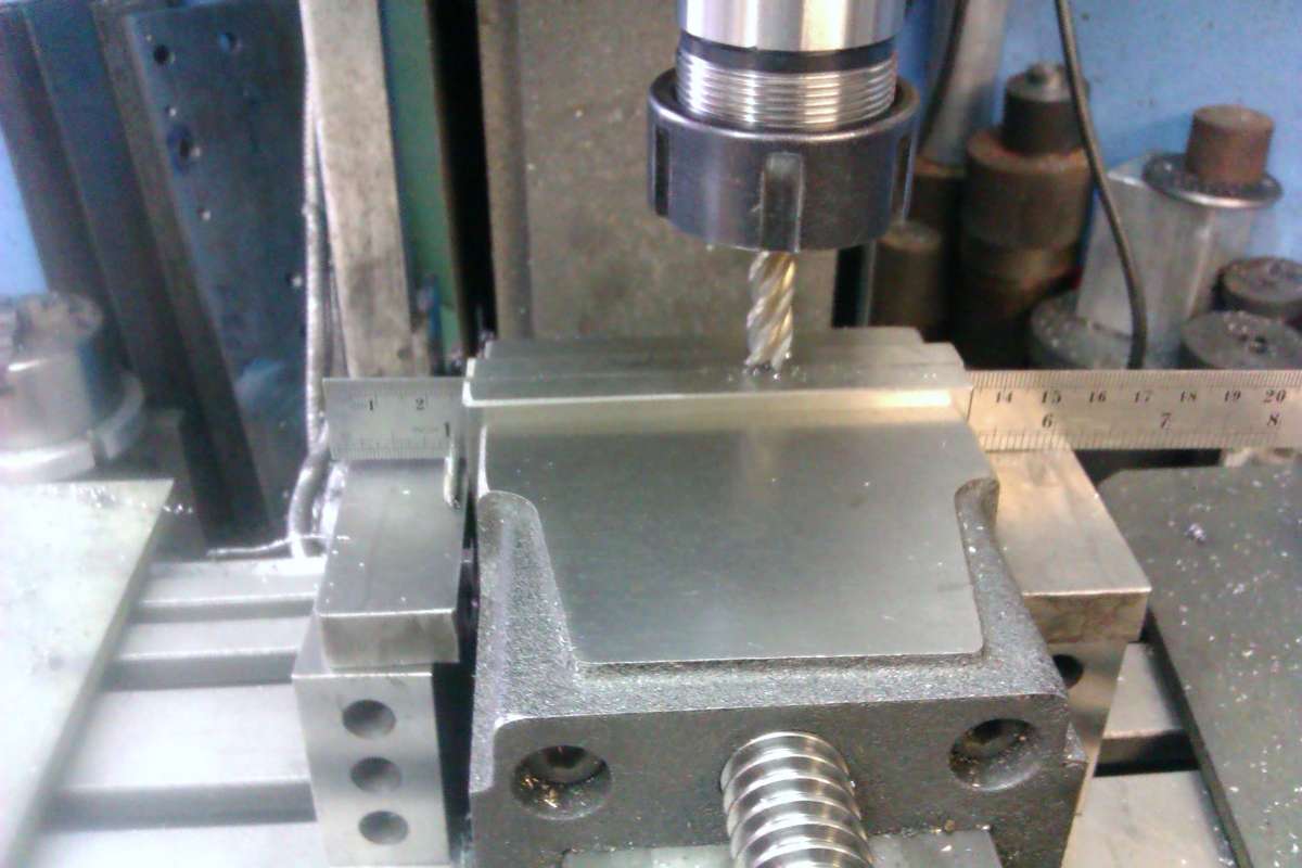

                                                  #782049
                                                  Nigel Graham 2
                                                    @nigelgraham2
                                                    Lovely work!
                                                    Re setting over the vice to mill a shallow taper ( as you described a wee way back up-thread):
                                                    I used a slightly different approach a few days ago for the 1:100 taper on a gib-headed key blade about 1.5″ long.
                                                    On the steel bar stock, I marked a line close to the end, and another 300mmm from that. I clamped the bar to a long angle-plate, with the inner mark on the edge of a parallel, and the end mark raised on a 3mm diameter drill shank on a second parallel.
                                                    A key taper to lock in a parallel keyway is not critical within the last 0.001″ or so, as an adjustable slide gib would need. BSI says 1:100; an ancient text-book advised the range 1:96 (1/8″ : 1 ft) to 1:104. So the method is accurate enough for purpose and avoids setting and re-setting a vice.
                                                    The same book also gave the key’s head proportions: this little component will show on the finished (when…?) project so has to look vaguely right as well as work.
                                                    Incidentally the “angle-plate” used is actually a length of thick-walled aluminium angle machined all over, once a high-precision machine part, and with a rebate on one face just deep enough to locate against the Tee-slot wall.
                                                    #782075
                                                      I do gib head keys in a similar way, just pack up one end of  a parallel or even a ruler. 1/16″ drill bit over 6″ for imperial 1:96 or 1.5mm drill bit over 150mm if doing a metric 1:100 key. I also make my own broach guides with a matching taper so I get full contact.
                                                      This was for a wedge and cotter so a bit steeper.
