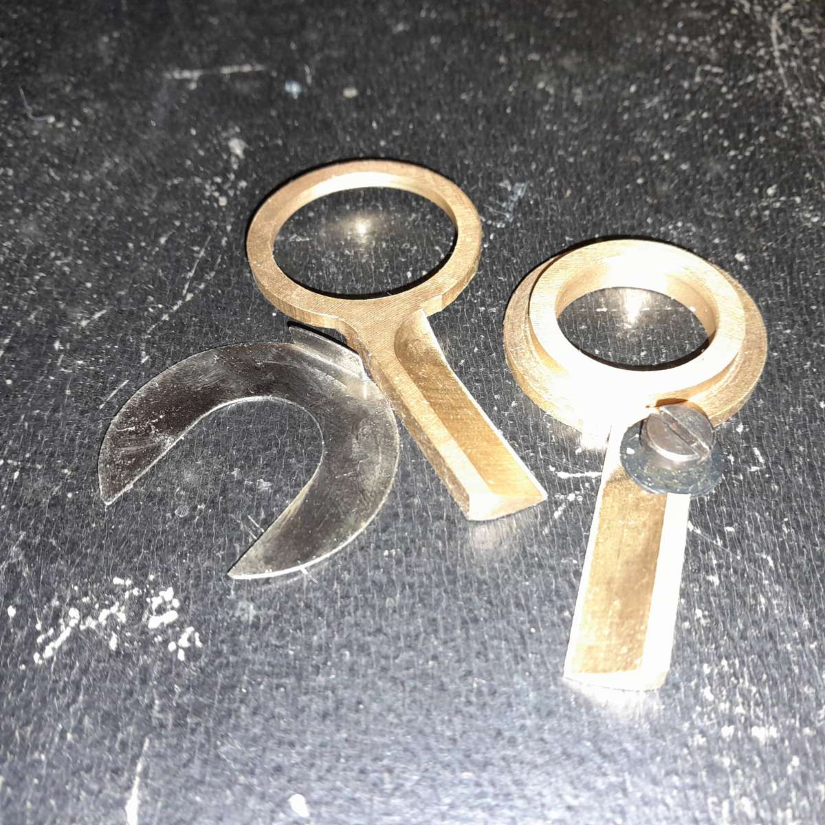

                The OP seems to have a problem with movement of the sector arms, not needing to make them. It is not clear exactly what he has got on his particular setup but lets look at a the picture for a BS0 head fingers.
                20260224_144804
                The left one fits over and rotates on a small spigot on the right one. The black screw is used to lock them relative to one another. Note the washer on the black screw which must overlap the top finger. This washer could do with being bigger and is crucial to the locking. The screw does go out the back and can lock the rotation of the assembly if the washer is not in place but it is not meant to. A replacement screw might be too long.
                The spring clip can be bent for added friction but it is only meant to resist movement of the finger pair assembly between operations not to lock anything.
                The correct procedure when advancing is to use two hands. After advancing the sector arm pair one thumb is used to hold the arm next to the plunger while the other hand is used to pull and move the plunger. On old industrial heads you can sometimes see the effect of bad practice where the operator  lands the plunger on the slope of the finger to let it slid down into place to avoid clunking against the arm and risking moving it.

                  Re-read the first post and see he does want to make arms. Yes, brass is fine and looks nice or aluminium less pretty but both easy to work. 1/8 thick. The black screw is probably 1/8BSF (or UNF) but I haven’t measured it. Otherwise use a BA screw as you want a fine thread.
