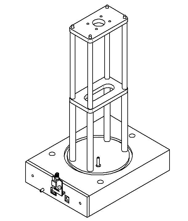

                                        If you used metal pipe then would it not be best to also use it as the support as it must be more rigid than your “tower”?  Obviously gets complicated assembling the beast but technically better.
                                        It would, and it’s in the “Potential Improvements” Annex.  Latest version of the Design Overview here on Dropbox if anyone has insomnia!
                                        I rejected PVC as a support because it’s too bendy.  A length of Noel’s 6″ diameter, 10mm thick Aluminium pipe would do a super job.

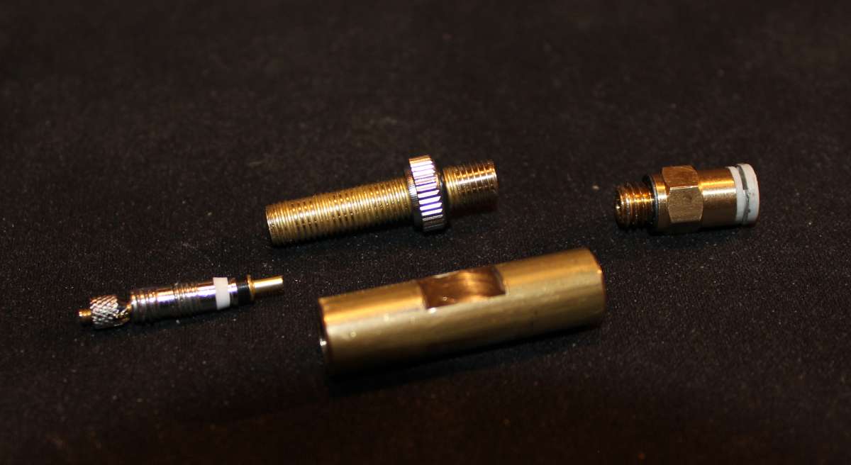

                                          As a taster of innocence abroad here’s the valve I made today.
                                          IMG_5384
                                          It’s modified Presta bicycle valve, inverted, with an adaptor to fit a 4mm diameter PTFE pipe.   If it doesn’t hold the vacuum, Michael has identified a commercial source of vacuum valves, so they’re Plan B.  Unless someone has a better suggestion! (I’ve noted Wade’s advice, ta.)
                                          Fans of unusual threads will notice  the valve. It’s a DIN7756 (Metric 6.0mm 0.8 pitch)  I’m confused: some sources say it’s compatible with M6 × 1.0 and has the usual 60° V form. I had to make an adaptor and thread it with a special tap…

                                                What about the rubber inside the bicycle valve? Might it be better to make a metal to metal valve, like a model boiler safety valve but with a lighter spring?
                                                But will the low pressure in the chamber be enough to push the valve open against even a light spring? Perhaps a springless check valve would work better once the vacuum is getting down a bit?
                                                Or a very light reed valve from a workshop air compressor etc. You could then have a larger area for the very low pressure to push on and open the valve?
                                                    I don’t know.  Rubber, being squishy should seal better.
                                                    There is no spring in a Presta.  Fitted to a tyre, its held closed by pressure in the tyre.  I’ve reversed it so it’s held closed by atmospheric pressure.  I hope!  Untested.
                                                    Wrong way round, but I know what you mean.  A larger valve has a bigger leak area which is counterbalanced by more force on the seal.  More sums!  Gut feel is the force on the seat area is much the same.  Have to draw it to be sure.  A problem with a small valve and exhaust pipe is it will take a long time to remove all the air through them.  The tiny orifice may not matter provided the pump gets there eventually and the vacuum holds.
                                                    Worth trying even though it might not work.  Not expensive in time or money.
                                                    Making a good vacuum valve is quite difficult I think, as is making a good vacuum pump.  The slightest leak reduces performance dramatically.
