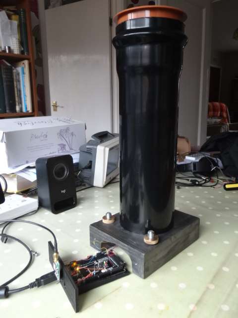

      I’m building a clock in which the pendulum swings inside a vacuum chamber.  Results in many problems akin to boiler design, except the cylinder is an evacuated PVC pipe being crushed rather than ballooned, plus sealing problems.
      My first attempt is based on a 4.5″ (114mm) diameter PVC Soil pipe, 350mm long, not much different from some model loco boilers.
      DSC06955
      Ideally the pipe will be evacuated to a hard vacuum, less than 100mb, but this is very difficult. I have an ancient Edwards EB3A roughing pump, specified to reach 133mb in brand-new condition. On test, it managed about 500mb, but the set-up was slightly leaky, and it might do better.
      Other factors suggest a practical working pressure of between 300 and 800mb, say 500mb (half an atmosphere or -7.25psi).
      H&S.  I assess impact of an implosion on human health to be LOW.   However, impact of a crush failure on the clock is  HIGH – the delicate internal structure will be damaged by the equivalent of a 12 stone (75kg) man standing on it.
      Answers confirming or improving on my existing design are most welcome.  However, I recognise that the PVC pipe approach may be flawed, making it necessary to switch to metal, or something else.  Alternative suggestions welcome.  To reduce leaks it is important to avoid penetrating the chamber with extra holes, so nut and bolt answers should be avoided!
      Is the pipe strong enough? First raised by blowlamp in a related Topic.  My unverified calculation suggests a 3.7mm thick PVC will fail by buckling. Estimates for a 3.7mm thick PVC pipe at 300mB: Axial 8.16bar; Hoop 3.7bar; Buckling 2.97bar.  That is air-pressure would have to rise to 3x atmospheric to buckle the pipe.  Same calculation applied to a 3.2mm thick walled pipe would buckle at about 170mb. FAIL! a safety factor of 3 is recommended for vacuum containers.  I am famously bad at maths, so grateful for independent verification.
      Next problem.  The calculation assumes the ends are as strong as the walls. True of the cast-iron base, not of the end-cap. This is a brown PVC plastic cap to BS EN 1401, intended to prevent stink escapes rather than resist pressure. The end is 3.25mm thick, weaker than the pipe. I intend reinforcing it on the outside with a 5mm thick Aluminium disc super-glued to the PVC. Concern is that air-pressure will break the joint by bowing – glued joints do not resist delaminating forces well.
      Is there a better way of reinforcing the end?
      More questions queuing.
      Thanks,

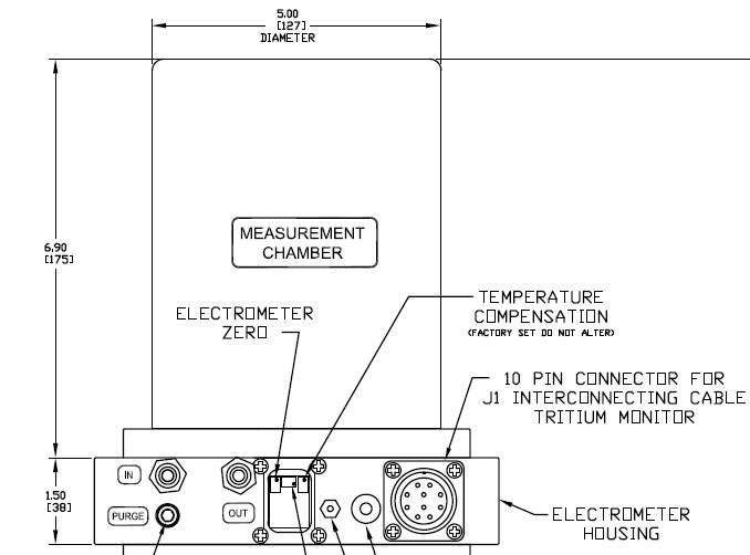

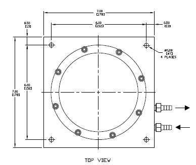

        Further to my offer of a hermetic connector I could provide it still attached to it’s orginal strucure. That’s a 7″ square by 1.5″ aluminium block. It has fixings and seals for a 5″ diameter cylindrical cover, space for electronics and comes with air fittings. black anodised Looks almost made for the job..h31H32
        I have the “chamber” cover too made from stainless steel.
        h33
        The aluminium block has a mostly solid flat top with  couple of holes. below that ss a cavity sealed by a flush cover and O ring about 4″ dia. on the bottom of the block.

          On strengthing the plasitic cap with a metal disk. Stick the metal disk to the cap with a flexible sealant like Sikaflex EBT+ or RTV silcone. Then there will be no air presssure on the cap to make it bow…
          If the disk is at least as big as the pipe OD and the plastic cap is fully seated forces will go vertically into the pipe wall.

                          If you use a piece of pipe with no collar you could replicate the bottom flange at the top, thick ally plate with a groove in it for location and o ring, 4 external tie bars to clamp it down.
                          Buckling due to external pressure can be prevented by attaching hoops either internal or external, I’ll need to dig out some text books to find out how close pitched, watch this space
                          Thd pipe used fir underground water and gas mains is a lot thicker, but I’ve no idea where you’d get short lengths.

                            I agree with Duncans suggestion but, I would leave out the tie bars and let the vacuum do the work. The higher the vacuum the better the seal.

                                  The tie bars are to get an initial nip on the orings, in an ideal world you don’t need them, but with a weedy pump it might never get a seal without them

                                    Whatever design you eventually choose, I think it would make sense to incorporate substantial external mounting points attached to and close to the pendulum suspension point, so as to reduce the possiblity of the structure rocking.
                                    My child-like maths gives me a surface area of about 196 square inches (14″ X 14″) of your PVC pipe, so when evacuated to -7.25 PSI, it seems that it is subject to 1421 pounds of pressure over the area. I’m not saying the pipe will implode, but if it’s not quite circular in cross section, then it might be vulnerable to further distortion over time or with a change in temperature.
                                    From the above, I think it follows that if you mount your clock purely on its base and some distortion does take place, it’s going to adversely affect performance.

                                          So whilst waiting for the doctor to ring I’ve done some sums. external pressure of 0.7 bar as per SOD, I get hoop=1.08MPa, axial 0.54MPa.
                                          It then gets complicated, as the tube is subject to external radial and longitudinal pressure. The equation is very long
                                          I’ve just ignored the longitudinal. If it were a long pipe it would collapse at 2.77 bar, but Roark suggests that as it can be treated as a short tube, and so it would withstand 5.47 bar. Again, if anyone wants the sums just shout

                                            Short tube with ends held circular
                                            #824488
                                              That seems a comfortable margin over atmospheric pressure, Duncan.

                                                I used values for PVC from Wikepedia, E=3.4 GPa. Another source (engineers toolbox) I’ve just found suggests 2.4-4.1 GPa and ABS 1.4-3.1 GPa. For comparison steel is 207 GPa, aluminium is 69 GPa
                                                lower value of E reduces safety margin pro rata. I doubt the tube manufacturer will even understand the question, as most customers won’t care.

                                                      I like the idea, but how big is the connector?   As there’s not much space inside the vacuum chamber I’m working to an 8mm diameter hole carrying 6 wires and a 4mm diameter pipe.
                                                      The hole leads to an open cavity under the block that’s occupied by the microcontroller, so the MIL-STD socket has to fit inside the chamber.
                                                      I may have to build a bigger clock!  And the existing tube is on the large side for my lathe.
