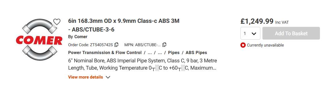

          There is a another worry plastics – it will gas under a vacuum.
          Ta, Dave

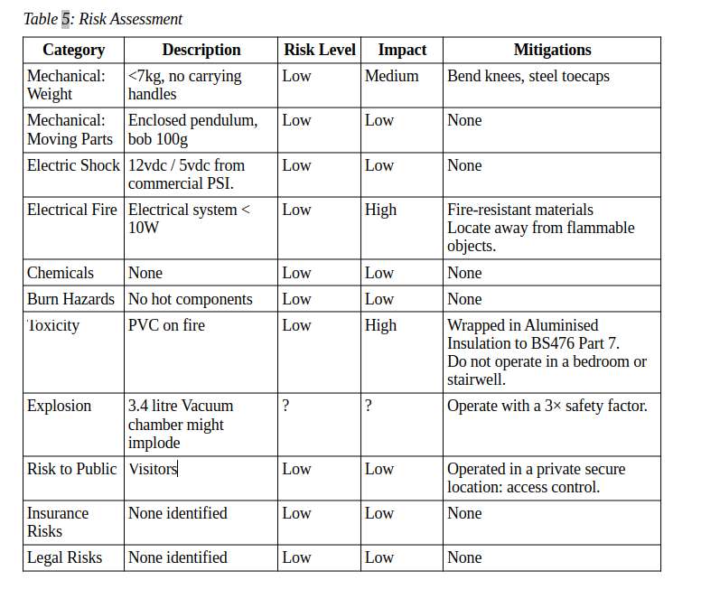

                  For completeness, here’s the project’s risk assessment.  The vacuum chamber is a work in progress other than I’ve specified a 3× Safety Factor.  If necessary that can be achieved by running at a higher pressure.  A partial 800mb vacuum comfortably isolates the pendulum from atmospheric pressure and humidity change, and reduces friction.
                  Screenshot From 2025-11-15 19-54-11
                  Friction reduces linearly down to zero at 0mb, so 500mb reduces air resistance by half compared with atmospheric pressure.  A 400mb vacuum reduces air-resistance by 60%.    Lower vacuums are better, but there’s value in any reduction.
