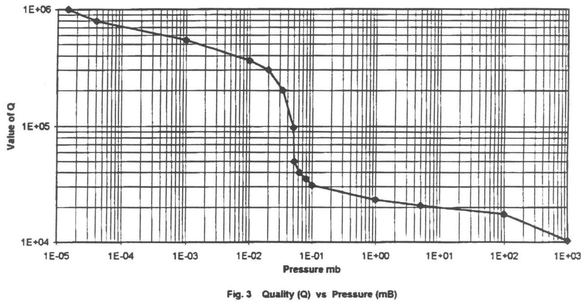

          Fig-3-webOn John Haine Said:
          Dave, I posted a link to Hall’s description of the Littlemore clock on the other thread.  I suggest you look at figure 3 in that article regarding the dependence of Q on pressure.
          I repeat…here’s a copy
            Is the graph inconsistent with my summary?  I thought not in big handful terms.
            My feeling:
            • Useful to reduce pressure to below the lowest natural air-pressure mainly because doing insulates the pendulum from barometric change.  Also reduces friction, so I expect a slight improvement in Q.  800mb is worth having.
            • Thereafter I expect Q to improve gently as removing air reduces drag, so getting down to 300mb is worthwhile too.
            • The big Q gains are made in a hard vacuum, which I’m unlikely to achieve.
            Am I missing something?  (I often do!)

                  Well, it looks like getting down to 300 mbar would roughly double the Q, but at a considerable cost in complexity – pump, enclosure, sealing, pump vibration affecting the penddulum etc.  But you could double the Q more easily by doubling the bob mass.  Only a slight vacuum should in principle eliminate barometric effects, though I do wonder about just how much a thin envelope would attenuate external pressure variations.  An interesting experiment would be to put a BMP280 inside your thinnish walled tube, slightly evacuate it and compare internal and external pressure.  Or even just seal without evacuating.
                  #826445
                    Agreed
                    Not easy for other reasons, like the small size of the Mk2 clock.   More evidence suggesting the Mark 3 should be bigger!
                    Added to the list!
                    Another example of me discovering compromises I’d missed or optimistically skipped over.  Which is best:  a deep vacuum or a big clock with a massive bob?
                    So in addition to high Q doesn’t matter (Clock B) we have, what improves Q, and are the various options worth the effort.  Any advance on my list:

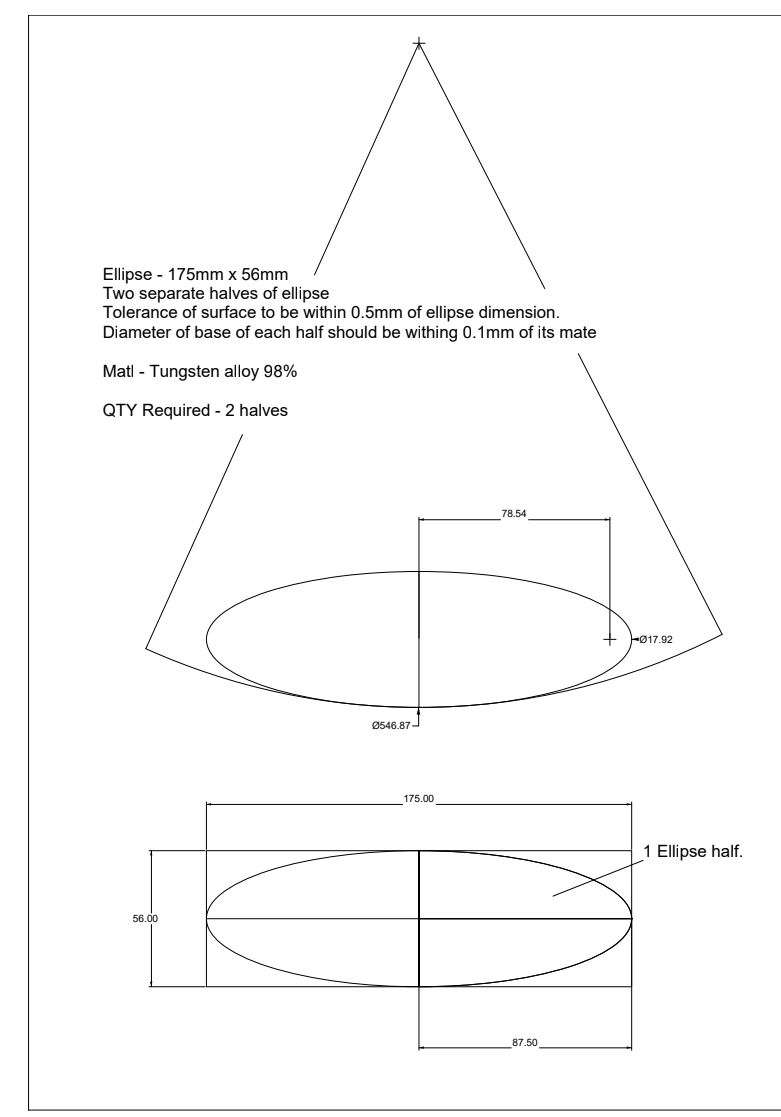

                      This was the description of a tungsten bob I wanted made in the US.
                      BoB
                      This was the quote:
                      Capture2
                      If it was the Magic Bullet, I would buy it, but it ain’t and will never be.

                              Ah, but Joe needs a large aerodynamic football shaped lump of Tungsten, not a sphere.  His pendulum swings in air.
                              John suggested it would be more economic for me to improve Q with a large heavy bob in air instead of the vacuum system I’m struggling with.   Joe’s quote shows a large heavy bob ain’t cheap either.  Not when chasing high-precision time.
                              My clock is small and replacing it’s 100g mild-steel bob with Tungsten is intimidating – the stuff is extremely difficult to machine.  So my design was nudged towards vacuum containment.  Joe went the other way, and encountered a host of other challenges.  Seems there’s no easy answer – one compromise after another, with a high risk of failure.
                                        It’s probably down to my naivety , John … but I find that plot astonishing [as in barely credible], and the explanatory caption does little to help !
                                        I suppose it’s because the vacuum levels extend to incomprehensibly low values … nothing that most of us could ever hope to achieve …
                                        Grateful for any enlightenment you can offer !

                                          What is not credible about it Michael?
                                          #826532
                                            Did Prof. Hall actually physically do this … or is it hypothetical extrapolation ?

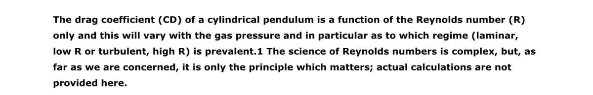

                                              It appers to be related to the Reynolds number of the bob shape. See https://www1.grc.nasa.gov/beginners-guide-to-aeronautics/drag-of-a-sphere/
                                              The dynamic viscosity of air varies a lot with pressure.
                                              Robert.

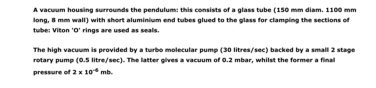

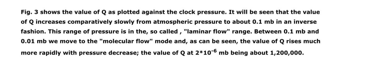

                                                  The graph I showed comes from an article on the clock in HSN 1996-4 by Prof. Hall.  The implication of the article is that the Q was measured as he had all the necessary means at his disposal in the clock.
                                                  #826567
                                                    I am aware of the article, John, and have read it several times.
                                                    My remark was prompted by the fact that I still don’t understand that graph.
                                                    Ref. https://www.model-engineer.co.uk/forums/topic/vacuum-chamber-design-and-build-advice/page/5/#post-826517
