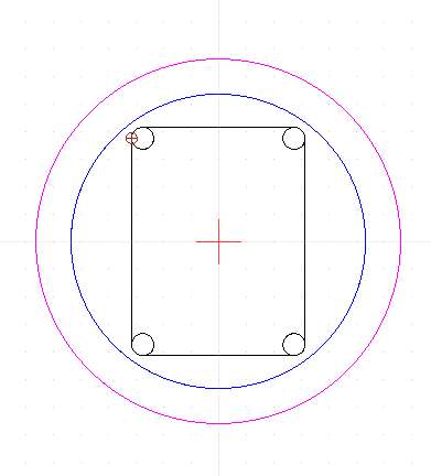

                                  I hope my lathe is big enough, but it may not be.  Did 4½” PVC OK.  6″ will be a tight-fit faceplate job, with the tool-post on the end-stops.   Your kind offer might well be accepted!
                                  Ian P
                                  How does the 6″ tube give more space for the mil-std connector, is it ?
                                  Here’s the floor plan.  PVC interior is the blue circle,  Aluminium in purple. Current tower shown in black:
                                  Screenshot From 2025-11-21 10-38-53
                                  The tower is a tight fit because a large base is more stable than a narrow.   However, that leaves less space for feedthroughs.  A 6″ tube increases the floor plan, but there’s still not much room for a MIL-STD socket.  Makes it easier though.
