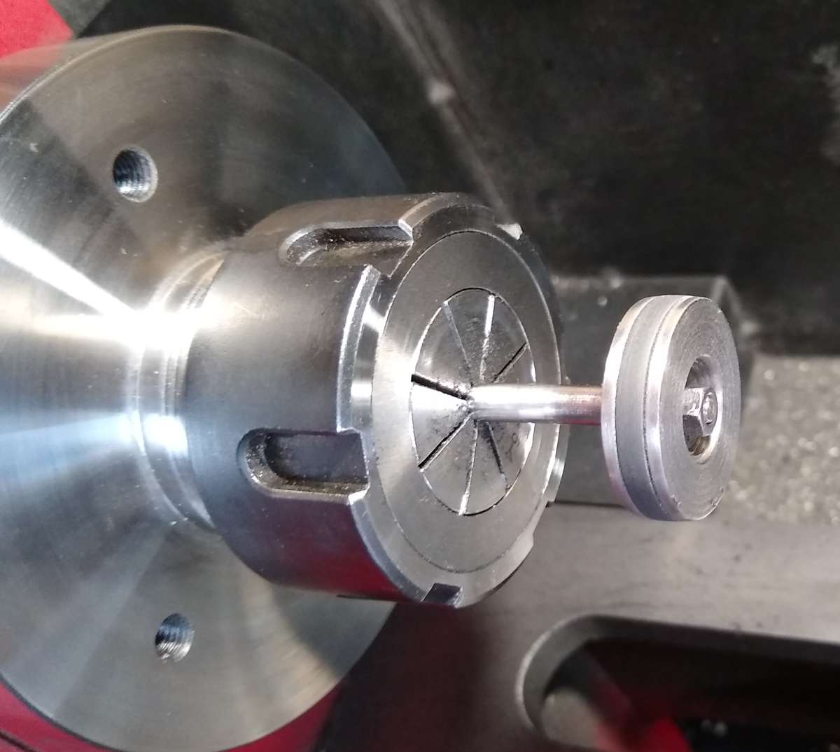

                          I have built the Stuart Beam and faced the same puzzle. There was no way the supplied O Ring would silde in the cylinder when fitted to the piston…it would be an extreme interference fit!
                          3 Cylinder 6g O ring piston 1
                          So It fitted the O Ring to the Piston and then ground off the O Ring till it was a sliding fit in the Cylinder.
                          The engine ran fine when assembled.
                          Ches

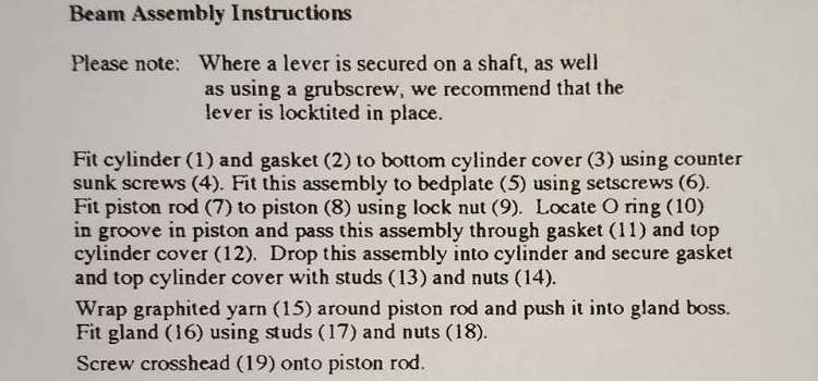

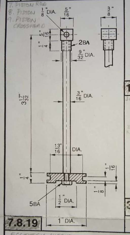

                                  Ches & Chris can you let me know what the drawing shows for the O ring groove depth and widith as well as the section of the ring?
                                  Paul the original design was for cast iron rings, not an O ring
                                  If the drawing has not been altered or they have simply used commercial tables to get the groove depth and width to put on a revised drawing then that is why things will be tight.
                                  Looking at the spares list they say a 1/16″ nominal O ring. This will actually have a cross section in the region of 0.070″ so a suitable groove for that would be 0.065″ deep and 0.090″ wide.
                                  Ches looks to be trying to fit a nominal 1/8″ ring into the 1/8 wide groove intended for two 1/16″ wide iron rings that is never going to work. That size ring is actually 0.0139″ cross section so groove needs to be 0.132″ deep x 0.160″ wide
                                  Howard, that is not agreeing with Noel, his gap would be 12thou (3thou per inch) but you say 3thou total?
                                  I’d gap a 1″ stuart ring at no more than 2 thou

                                        Here are 3x extracts from the Beam drawings.
                                        The O Ring is marked as Pt 10, although it is not listed or dimensioned in the parts list.
                                        o ring 1
                                        Piston assy details.
                                        o ring 2
                                        Piston assy instructions.
                                        o ring 3
                                        Ches

                                          Thanks for those.
                                          The drawing shows the groove for the two iron rings which were noninally 1/16 wide x 3/64 thick. This allowed a bit of space behind the rings so that the gasses would expand them against the cylinder wall.
                                          For your ring see the sizes I gave above. For the 1/8′ nominal. Luckily the groove needs to be both deeper and wider so the existing piston can be modified. Small ctr drill and tailstock support if you have a wide parting tool
                                          Chrus if you can give detail of ehat you have then I will confirm what groove size is needed

                                            Yes, the groove should be 3/32″ deep and 1/8″ wide, I’ve measured the O ring and the section diameter is 0.135″ (3.43mm) give or take a squeeze and the OD of the ring is 1″. A deeper groove would seem to be the answer, but having now fitted the rings I will defer that decision, or possibly make an alternate piston to suit.
