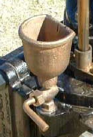

      I need to make a tundish for my present project. Basically it is a truncated cone, but it has a flat side to it.
      The top is about 1-5/16" diameter and the hex at the bottom is 5/16".
      I thought about initially turning the round shape from a piece of brass bar and then slicing off a section and soldering on a piece of flat plate to give the required shape. It would be quite wasteful of the brass bar, but I do have a suitable piece that has been waiting to be used.
      Another thought was to roll the tube from brass sheet after soldering on the top lip then solder in the bottom. Finally slice off a part and solder on the flat. My main worry with this method is trying to roll the tube with the bead pre-soldered on. If I leave the bead off, I doubt my silver soldering skills are good enough to roll the bead afterwards and silver solder it on before cutting out a section for the flat part.
      Any other ideas would be welcome.

            CAST IT ? The picture looks as though it may be a casting ? Noel.

              Noel. The original may well have been cast, but at the scale I'm using the use of something like coarse Scotchbrite to take away the shine will probably not look too different. Besides, I have no casting facilities or experience nor is there anyone locally with such knowledge. I suppose I did ask for other ideas!

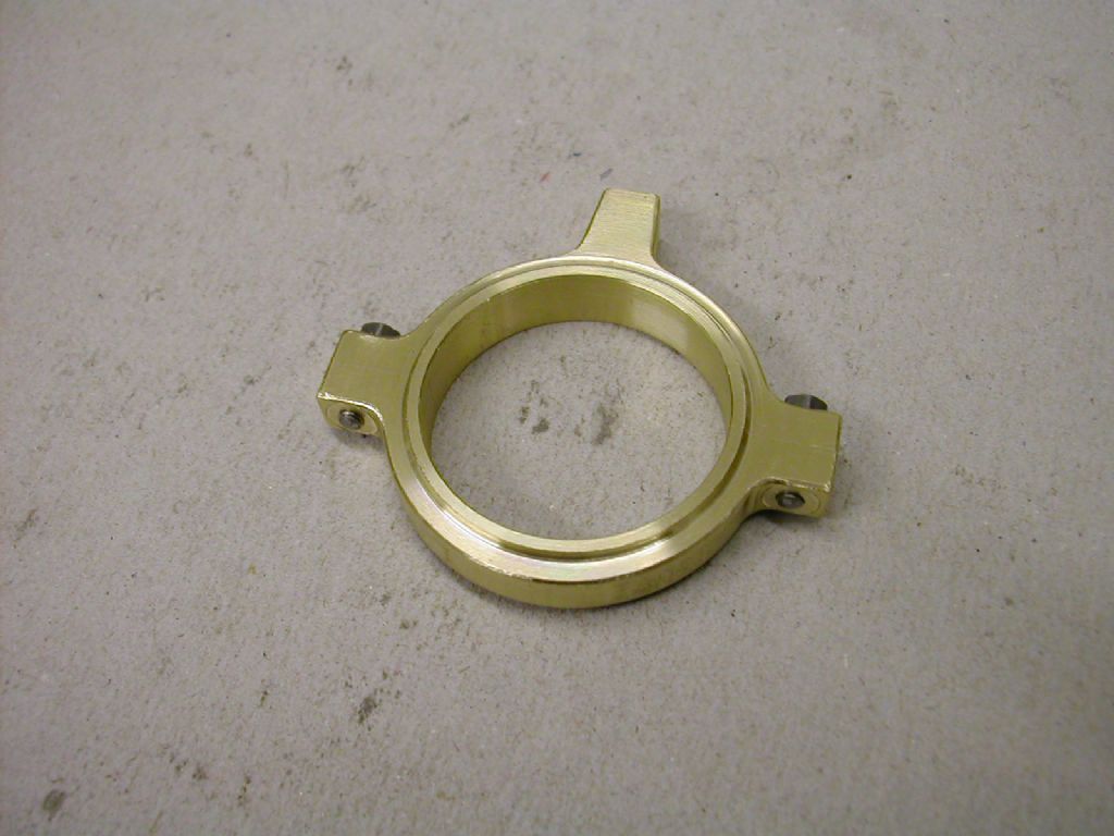

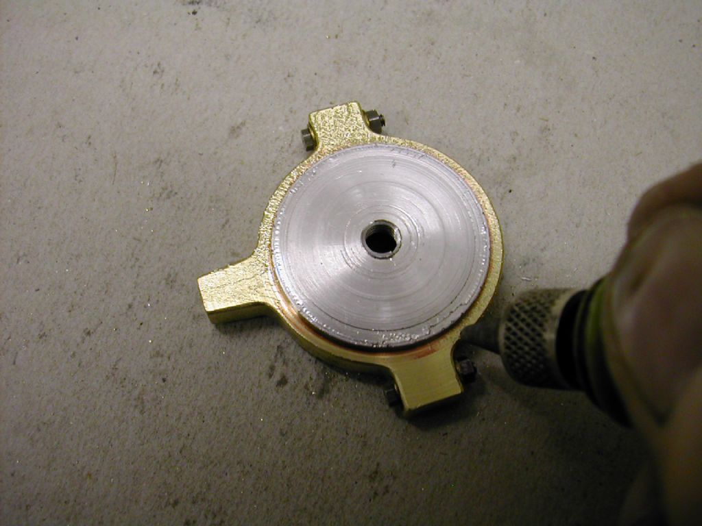

                          Dave, Making it from brass or bronze from two or more parts silver soldered together seems to be the best option – if you want to achieve a reasonable rendition of a cast surface you could use an elecric engraver but make certain you protect areas that you want to remain smooth/mmachined.
                          Heres an eccentric strap I did for a Waller engine as an example
                          Hope that's of use to you
