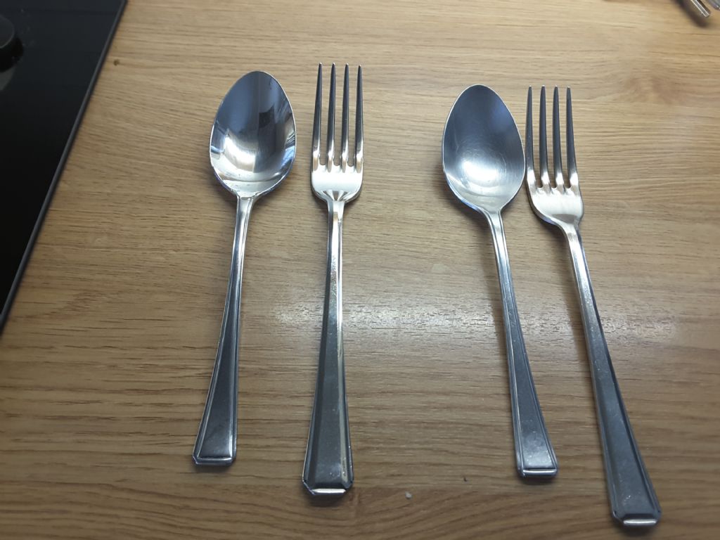

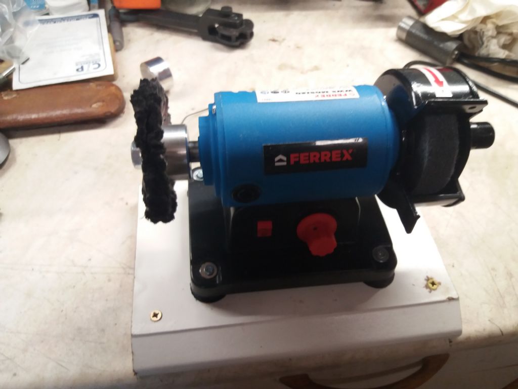

                            I had a similar problem with spoons but they had been cleaned with a scouring pad to remove staining. Do I had a great idea when I saw a small bench grinder in Aldy with the guards removed and a polishing mop from Cromwell tools it pleased SWMBO and they looked like new.
                            Note the before and after.
                            David

                                            The blue-black staining on our 'stainless' cutlery didn't respond to chemical treatment, so I did like David George and used a buffing wheel. They polished up beautifully and two years later are still bright. The only problem I encountered was that the wheel was too big to get into the teaspoon bowls, so I did them by hand with Autosol polish.
