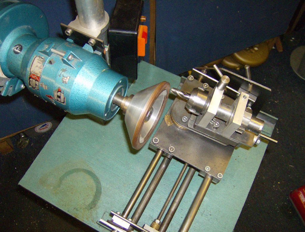

                    I used the spindle of a small 6" bench grinder. I fitted and aluminium hub and used the existing centres to finish turn it in place. It spins the diamond wheel so smoothly you can put your finger on it and barely feel it moving.
                        Tea stains optional…
                        This is so simple and beautifull that I am going to make one straigth away.Put a VFD on and it is perfect

                          Posted by Niels Abildgaard on 25/12/2016 17:10:56:
                          Thanks Although I'm not sure 'beautiful' is the right word!
                          The slide fits to a stepped disk in a hole in the plate, exactly the same as the top-slide mounting on a mini-lathe so you can use the mini-lathe topslide to grind lathe tools.
                          The table pivots up and down and the whole assembly moves back and forth on angle-iron 'rails'.
