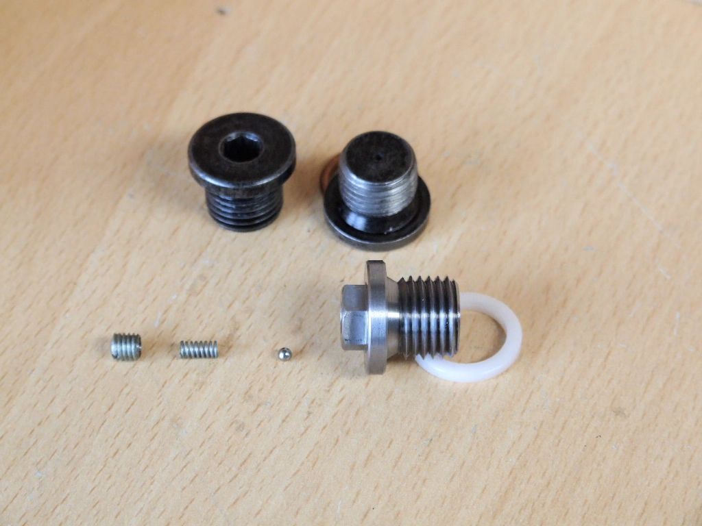

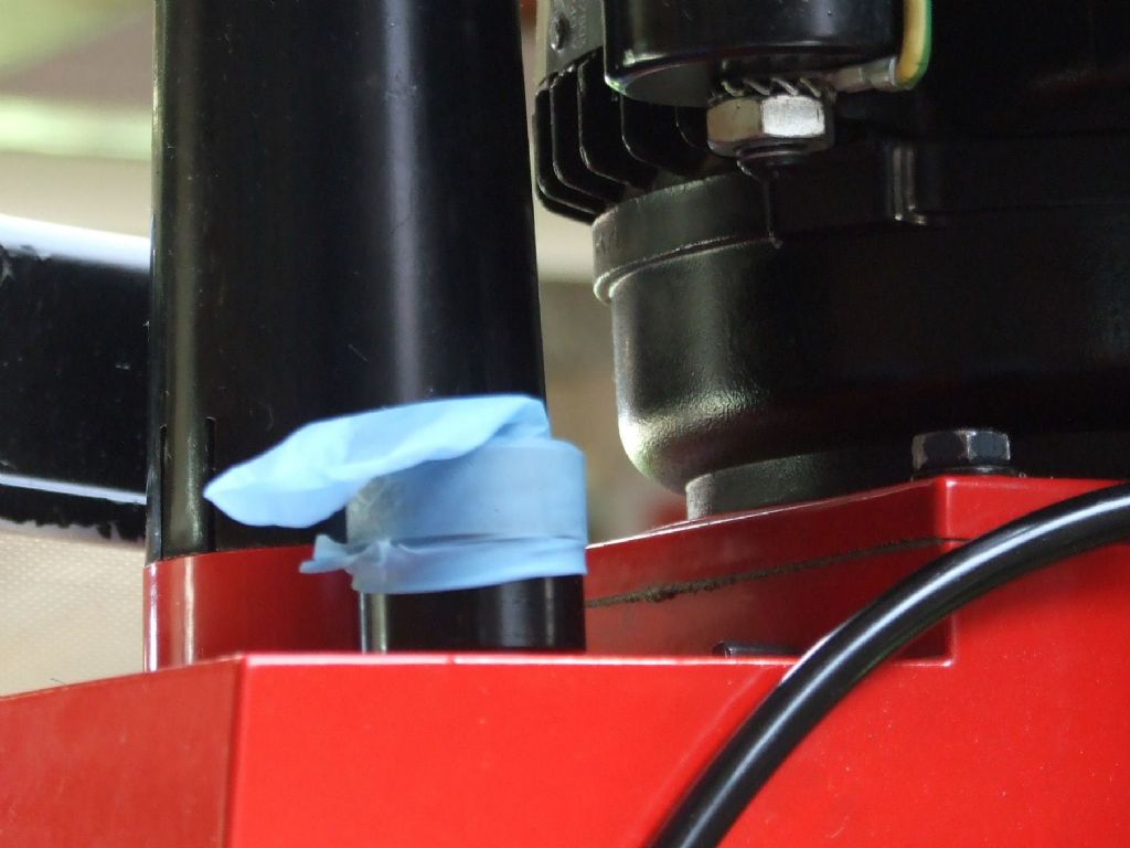

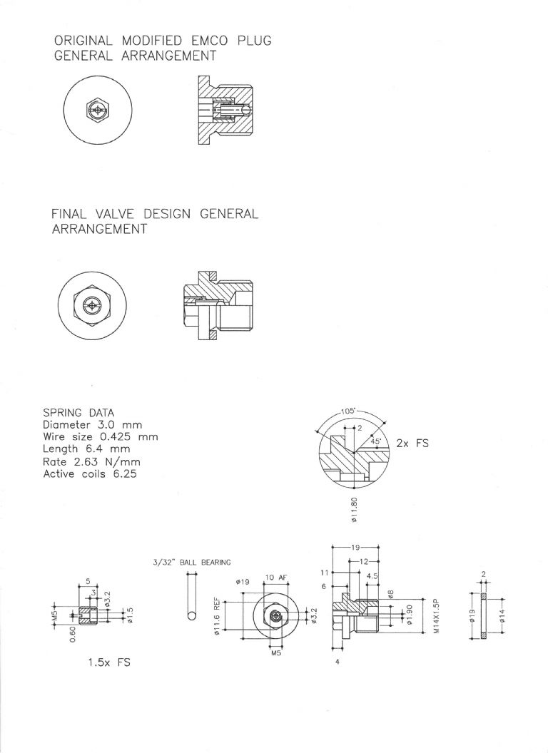

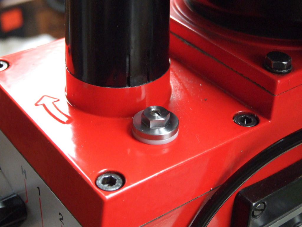

      One recurring quirk or problem with the FB2 is that of Oil leakage from the Milling head. Many who have purchased a used machine automatically think it is due to a failed Oil Seal or O-ring. Of the latter there are 5 on the FB2, one large one on the Quill and two each on the shafts of the Speed change levers.
      Two running seals made by INA are fitted, one to the top cover and one is recessed within the Quill assembly.
      In the 34 years I have owned these machines I have yet to have any of these seals fail, despite near constant usage.
      By far the biggest culprit for oil leakage is pressurisation of the gearbox. I first noticed this when one morning after receiving the above mill. A small pool of oil appeared over night on the milling table. As the machine was only a few days old it could not be a failed seal.
      Leaving the filler plug slightly open cured this leak. Leaving this plug open to the atmosphere allowed the pressure inside to escape. Not being happy with the open filler I modified the standard Emco plug, then designed and fitted the plug shown below, which is basically a snifter valve.
      fig 2 component parts of the valve with a standard & modified emco plug to the rear..jpg
      Since fitting this valve I have not suffered any further oil leaks on either of my machines. There are however some who doubt that the head does pressurise. To this end I recently carried out a simple experiment using the finger from a Nitrile glove. This is slipped over a modified sealing washer.

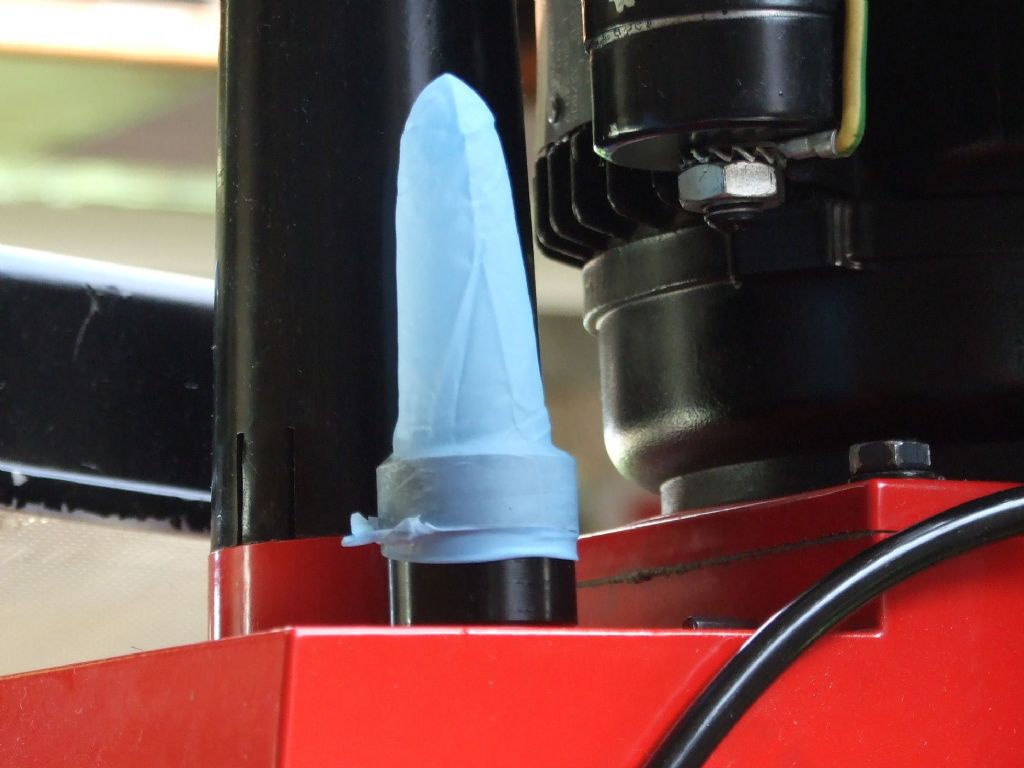

      The next photograph was taken 1 minute later after running light at 2000 RPM
      Leaving the "indicator" in-situ while carrying on working saw the finger disappear to the far corner of the workshop. Those who have not successfully tied up a Party Balloon will know the score here.

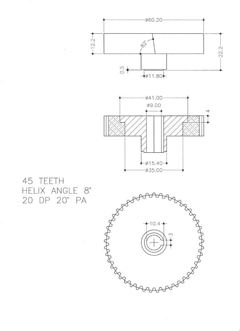

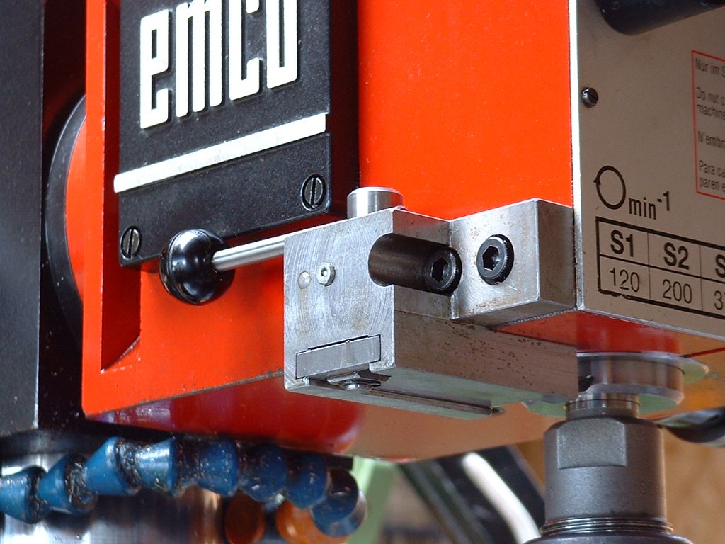

              The only Achilles heel with the FB2 from what I have read about is the Tufnol Gear (Gear 47 in the parts List), which some people have had some teeth stripped off.
              I have seen these gears up for auction with the asking price double what a new spare part costs. As many of the parts are no longer being made by the factory. It is just a matter of time before these too will no longer be available. The last time I took the gearbox apart I took the measurements of the gear and have made a drawing.
              It is interesting to note that the gear is a DP, and not a Module form. Having originated in Austria I did assume the latter, until the sums just did not add up for a 45 Tooth Helical gear.

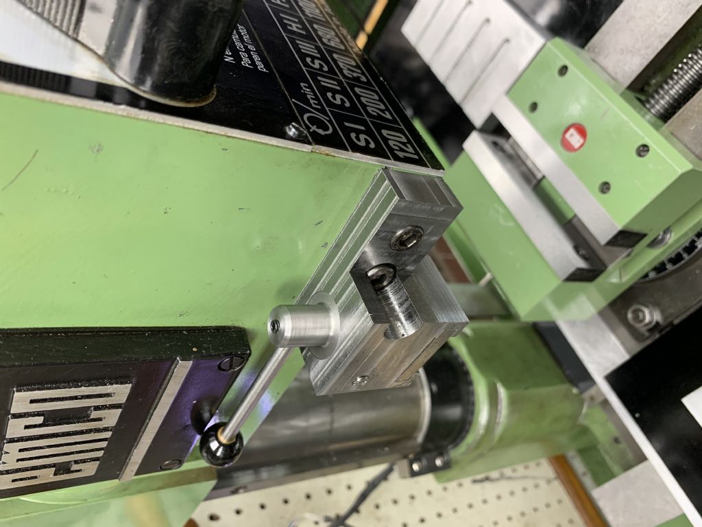

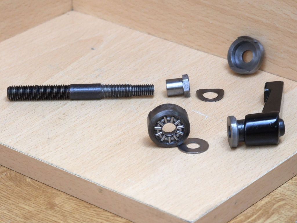

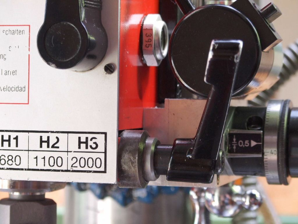

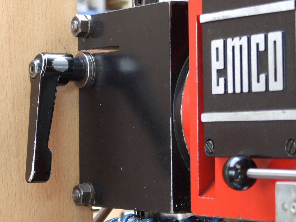

              One of the reasons I think these gears fail is due to owners using the lowest gear to lock the spindle to remove any Morse tooling. If one tries to turn the spindle backwards by hand in the lower range there is a feeling that something is binding, just prior to the gearbox locking up. I think it is the Tufnol gear crowding the smaller steel motor pinion.
              Removing a stubborn Morse taper using this method is going to put things under stress at one point on the Tufnol gear. Unlike when the machine is running and several of the teeth are sharing the load.
              To make the changing of tooling much easier and to remove any risk of premature breakage. I designed and fitted the spindle lock below. This makes locking the spindle dead easy and with no risk of damage to any part of the gearbox.
              Over the coming months I hope to try cutting a new 45T gear by simply gashing at 8 degrees. It will not be a true helix but given the gear is 12 mm wide and the Lead is well over a metre, I don't think it will matter. It is certainly worth a try and if it works I shall have a spare to hand.

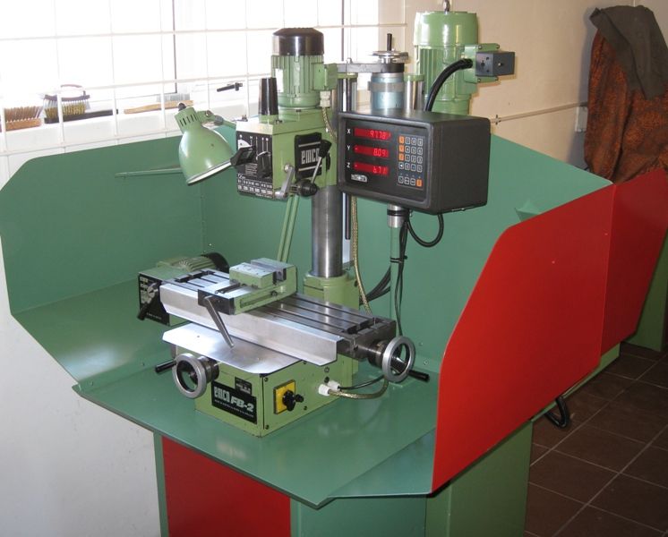

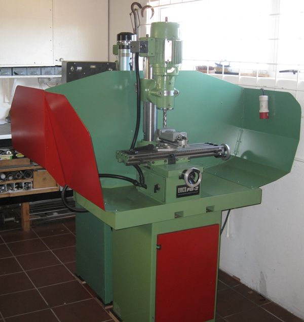

                  Joseph Noci 1
                    @josephnoci1

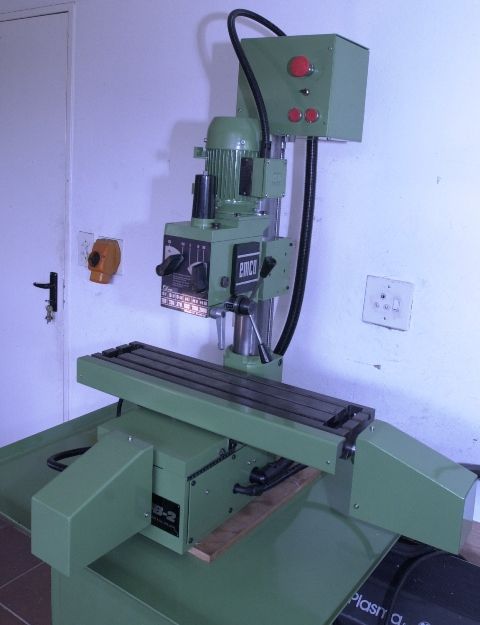

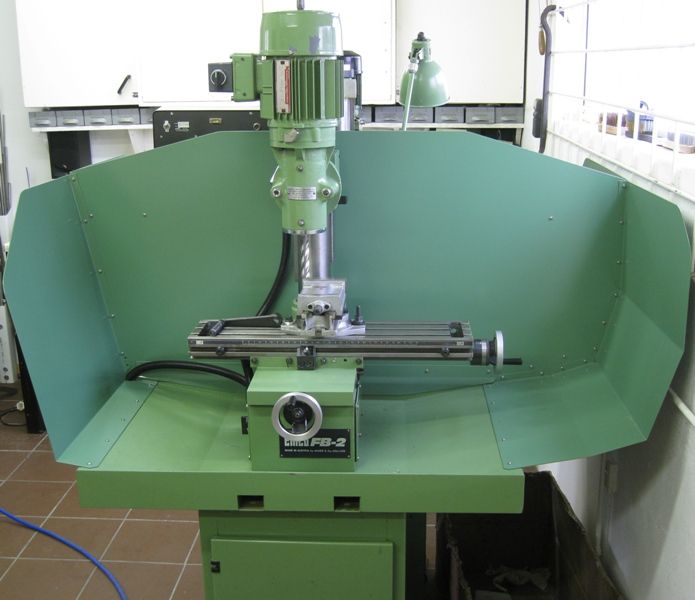

                    Nice to see your FB2 again Graham. The FB2's may be a little light, and scorned by some for their Round Column, but they are such a pleasure to use – smooth, and very easily set up for close to zero slide play and screw backlash. I have 3 of them , in various forms, and have used them for very fine work, through to 20mm endmills  and 60mm face mills hogging away in aluminium.
                    My 'true' FB2 ;
                    Fitted with DRO and motorized Z axis. Also some useful swarf/splash guards.
                    Behind it is another 'FB2' – sort of..
                    This is an FB2, save for the actual mill spindle head. – A sturdy old British (Jones & Shipman) direct drive mill head, MT3. A 2 speed three phase motor, now driven with a VFD. This one is quite comfortable with a 60mm diameter 6 carbide toothed face mill, and will take a 2mm full width slice happily..
                    And the third one – converted to CNC from an old, very hammered imperial machine – replaced almost everything – all gibs, gears, bearings, quill and then fitted ball screws and a CNC setup. Works nicely..- needs splash guards though!

                      Hi Jim,
                      Please find below the drawing of the Breather/Snifter Valve. I am not familiar with the Rishton as regards the filler plug thread details so you may need to check this. The 8 mm counterbore is there to stop oil that makes on the face of the standard plug making its way out of the machine. Something I learnt with the modified Std Emco plug.
                      To size the thread I used a micrometer over 3 drill shanks on the original plug and made my new plug to that dimension.

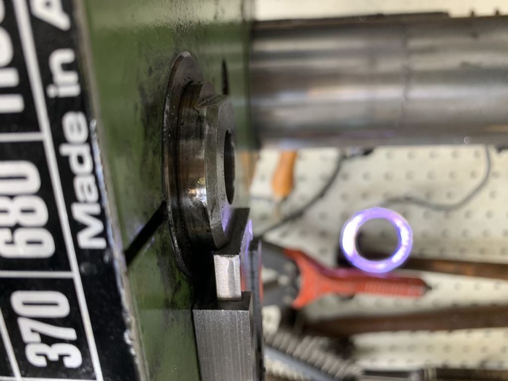

                      As regards the tooling getting stuck. It may be better if I detail what I do and how the FB2 is configured.
                      The Top of the Spindle is threaded M18x1. Onto this is threaded a Cap Nut, which accepts the head of the M10 Capscrew drawbar. This cap nut is locked onto the spindle using a 17 A/F spanner, this does not need to be excessively tight. I have introduce a washer above the the head of the Capscrew to limit how far I have to turn the Allen Key to undo the drawbar, before it contacts the cap nut. Plus this washer introduces another face for the capscrew to slide over, rather than directly on the cap nut itself. An EP grease is good at this point.
                      I keep on the shelf behind the mill a clean lint free wipe, every tool change the new piece of tooling gets a wipe. The Morse Socket gets a clean about every 6 months with Isopropyl and another wipe.
                      The dry surfaces of the Morse taper should be enough to hold that item of tooling during use. The drawbar is there merely to stop the tooling coming out during use from cutting forces, Helix on an endmill or slot drill, etc. I have a long series 8 mm A/F Allen Key and this is used to tighten the drawbar, but the pressure on the Allen Key is the Second Finger of my Rt Hand, nothing more.
                      A quarter of a turn with the Allen Key is all that is required to undo and remove the tooling. Occasionally my Shell Mill holder will turn slightly under heavy cutting and tighten itself up further, but the long series Allen Key undoes the cutter with a sharp crack.

                                  I have sold my Emco mill, but know the buyer. For an easy solution to the oil problem, would it be possible to drill a say 1 mm hole through the hex key opening, and then fill that opening with a piece of foam or plastic sponge. Air can escape, and dirt cannot go in.
                                  Kind regards,
                                  Hans
                                  #488444
                                  Graham Meek
                                    @grahammeek88282
                                    Hi Hans,
                                    The modified Emco plug in my drawing above, started out in exactly the same way as you describe, before I added the spring loaded valve. The problem with the Emco plug is two fold. The end of the plug is flush with the inside of the gearbox cover. Oil accumulates on this surface during use. When the quill is lowered and then raised droplets of oil from the end of the plug are carried into the foam.
                                    The second problem is with continued usage this oil builds up in the foam and starts to leak over the outer surface of the cover. This returns the Status Quo, and there is another oil leakage. Even using the spring loaded version of the Emco plug, this allowed the oil to accumulate in the hex socket. Every so often when using the quill I used to get this spray over my safety glasses, the small hole makes an ideal spray nozzle arrangement. This usually occurred immediately after I had just cleaned the safety glasses.
                                    This is why in the final design there is an 8 mm counterbore in the end of the new plug to stop the initial oil accumulation. As with all designs, the Devil is in the detail.

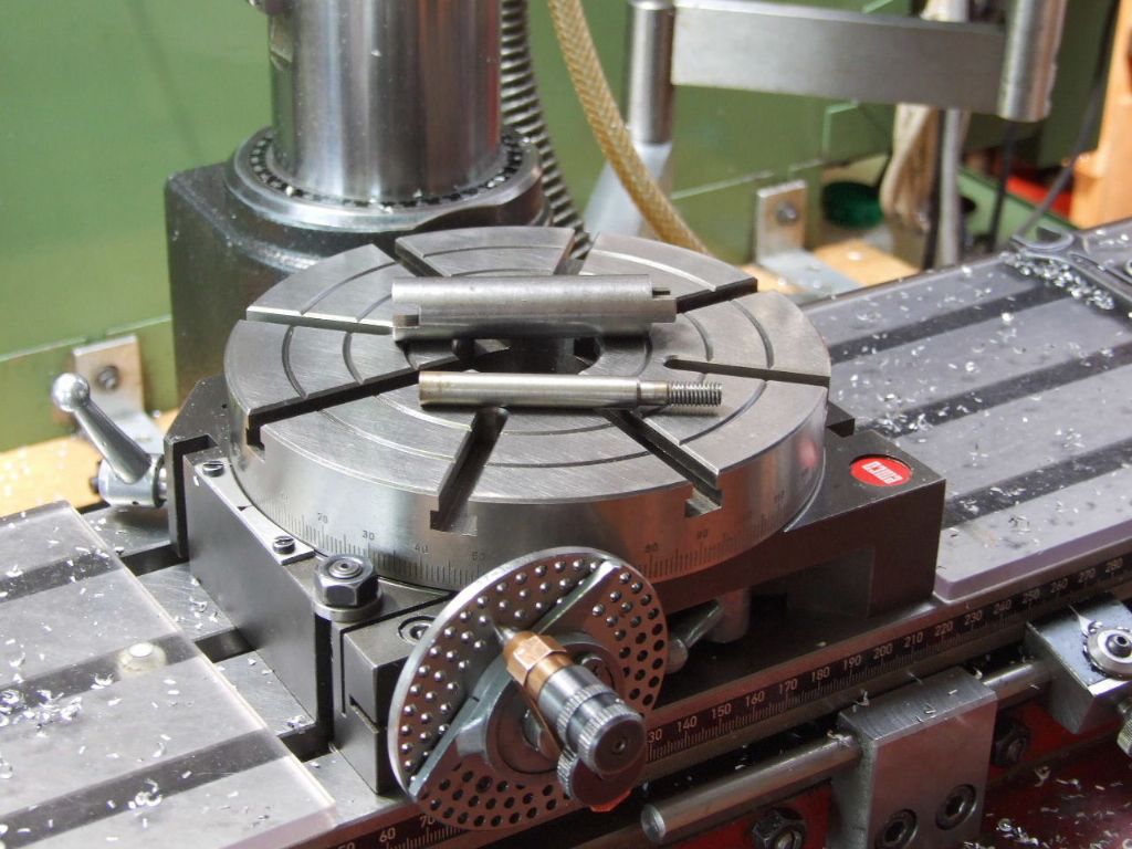

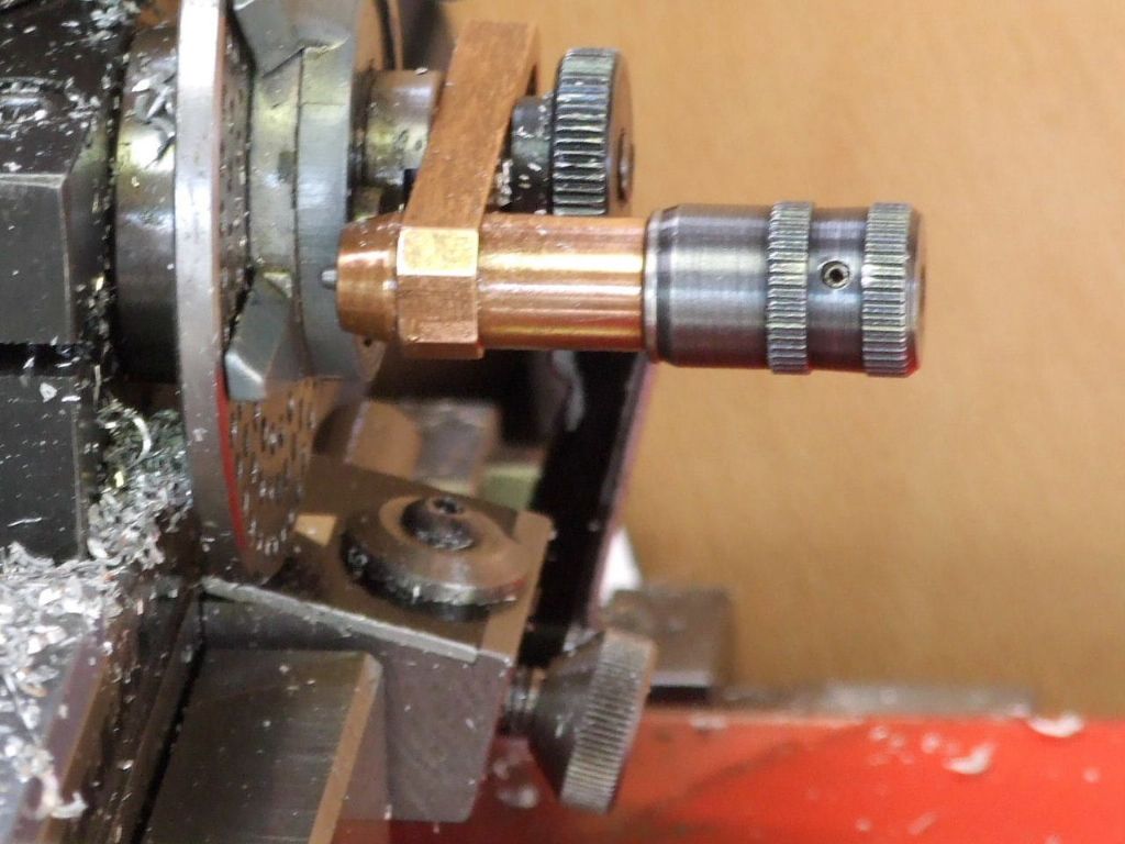

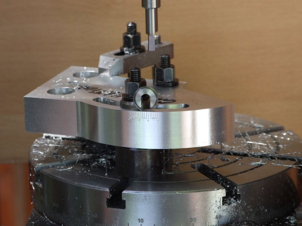

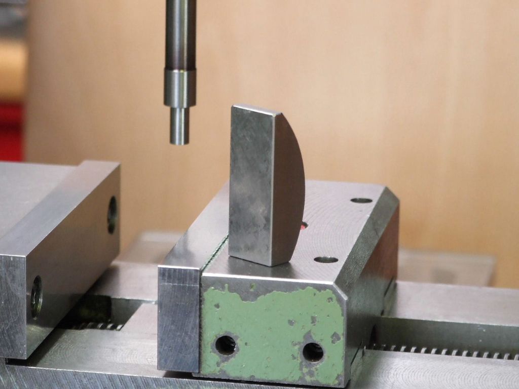

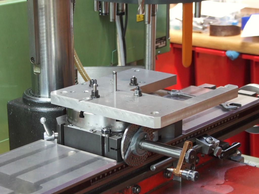

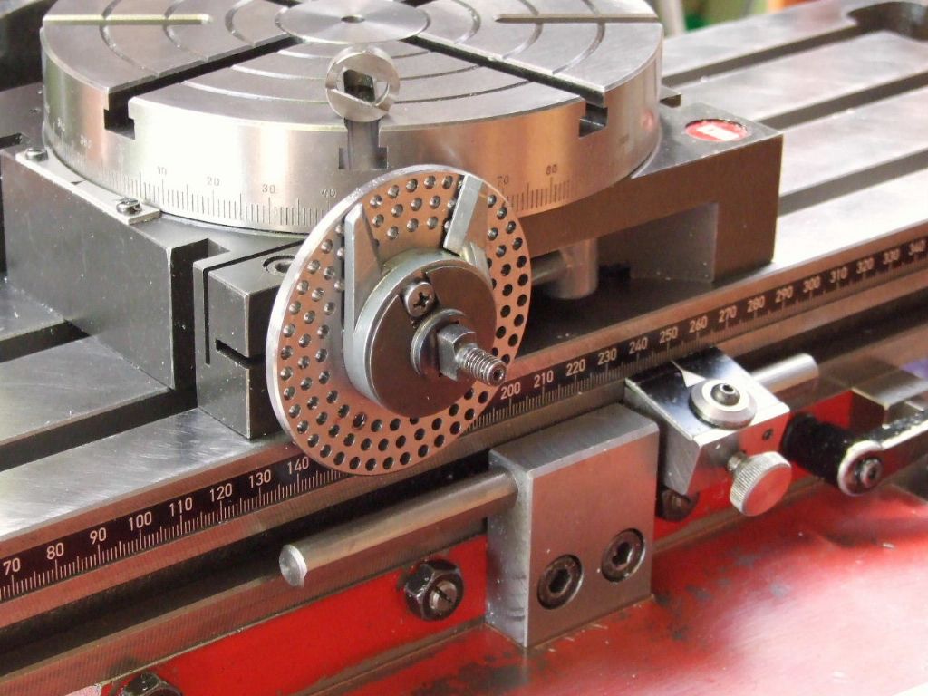

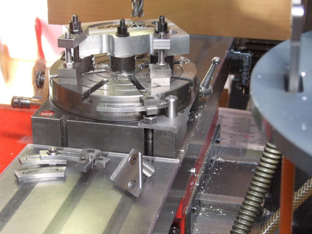

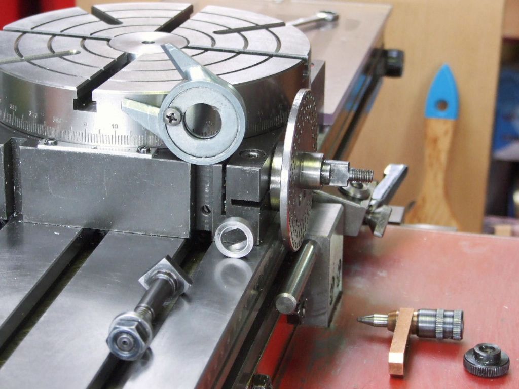

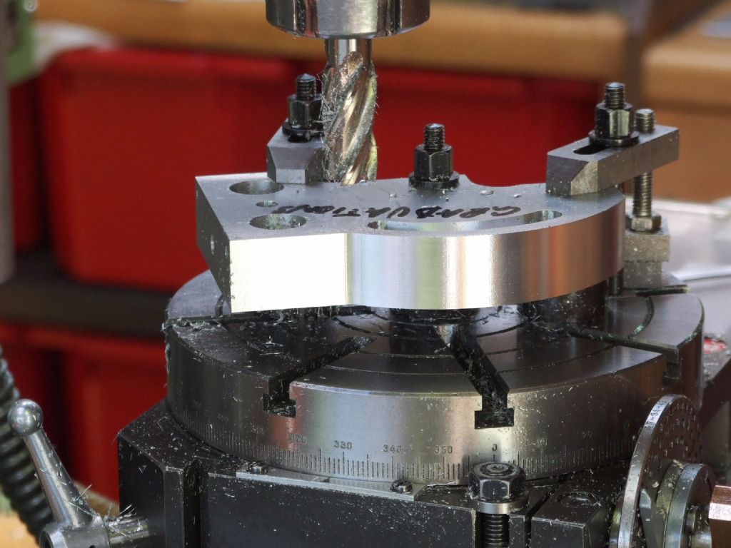

                                      An item I have had on trial for a while is a set of Adjustable Stops for the Emco Rotary Table. These are in-valuable when two radii have to meet, or intersect. As the Stop takes away any chance of an over-run with the table, or turning the handle in the wrong direction.
                                      I was using this today on the Main Support for the Lathe Tool Honing machine I am building and described on a separate post.

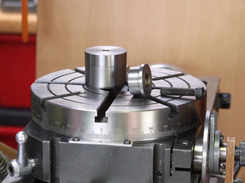

                                      Also in use is something I made over 30 years ago, and shown above the graduations in the next photograph. It is a simple stepped and slotted Hold-out Washer.
                                      This sits beneath the indexing pin handle on the Rotary Table, there-by keeping the pin out of engagement with the Dividing Plate. This is a real boon when circular milling. It takes minutes to make but saves hours of frustration.
                                      Also in the shot is my revised X-Axis Stop and move-able cursor holder. More on that another time.
                                      Regards
                                      Gray,
                                      Edited By Graham Meek on 31/07/2020 15:18:48

                                        Gray, it looks as though you are entirely successfully using your (modified) Emco 'Indexing Unit' as a rotary table, for machining slots and other curved surfaces. One would have thought that Emco intended it to be used this way, as well as for angular positioning and indexing, but the FB-2 manual states unambiguously that the table locks should be tightened before any machining. This would explain their decision not to name the thing an indexing rotary table, I suppose. But why make something that is almost a rotary table, and then instruct users not to use it as a rotary table? Strange.
                                        Several years ago, when I looked at my unit, I was surprised to see that the worm's axial constraint effectively depended upon on the nut securing the handle, and there was no provision for end-float adjustment. Also, even with the eccentric worm carrier turned to maximum worm engagement, there was significant angular backlash at the table (as far as I remember, the worm was not moving axially). I wasn't impressed, and supposed that the unit really wasn't designed to be used for anything other than angular positioning. I had other rotary tables to use for arcuate machining, so I didn't pursue it any further.
                                        What are your thoughts? Have you modified the wormshaft's location arrangement?
                                        Another possibility for adding stops to rotary tables is one or a pair of bands, incorporating tightening scews, which clamp to the table's periphery. A radial projection from each band can then contact a stop fixed to the unit's body. (Think glorified Jubilee clip, if my description isn't clear).
                                        #488628
                                        Graham Meek
                                          @grahammeek88282
                                          Hi Jerry,

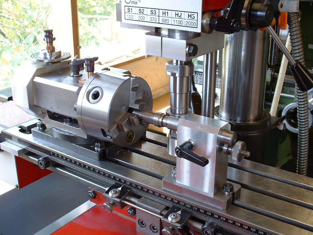

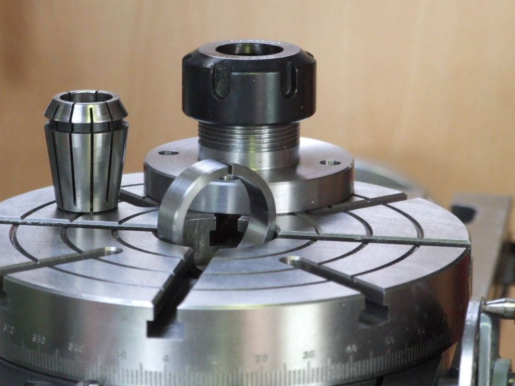

                                          I understand the confusion with the Emco Rotary Table, given the Manual only describes an indexing function. As far as I was concerned the attachment was both from the start of owning Emco products. It would have been better if Emco had chosen a 60:1 ratio as regards using the attachment as a Rotary Table. The 40:1 ratio is a bit fast for circular milling but you get used to it, although somewhere in my drawing files I have a 60:1 worm and wheel conversion drawn up.
                                          I used the attachment as both Dividing Head and Rotary Table until I had a chance to design my own Dividing Head.
                                          This is a marriage of GHT's Versatile Head, the Emco Rotary Table, the Emco machine Vice swivel base and a bit of Meekising.
                                          As regards the end float on the Worm Shaft. In the normal Emco design all float is taken up by a special Bellvue Washer with a cut-out in it to clear the locking screw of the sector arms on the indexing plates. This serves two functions in that it provides friction to make sure the sector arms stay put, but also to take up the play in the worm shaft bearing. This is fine for indexing, but when it comes to circular milling it has an Achilles Heel. Provided the cutter rotation and rotary motion of the table are in sink, everything is fine. If however the rotary motion is using the Bellvue washer as its resistance to the cutting forces things can get a little hairy with a tendency for the cutter to snatch.
                                          To this end I have done away with the Bellvue washer arrangement and fitted a special spacer to take up the backlash. I use the same arrangement on my Dividing head, and feel I had better take some photographs of that. One photograph saves a thousand words, the special spacer can just be made out in the last photograph of my last post.
                                          As regards the depthing of the worm in the worm wheel. In the M8 Tee Bolt slot for holding the Rotary Table down to the cross-slide or milling table there is a Slotted Grub Screw that acts as a stop. This is screwed in or out to get the desired adjustment, but you will need just a little play.
                                          Hope this helps,
                                          Regards
                                          Gray,
                                          Edited By Graham Meek on 01/08/2020 11:29:12
                                              Above is a view of the mods done to the rotary table Worm shaft to eliminate backlash, or the spring effects of the Emco standard set-up shown below, and mentioned above. Thirty years of wear can just be made out on the end face of the slotted distance piece.
                                              The slotted Grub screw for adjusting Worm to Worm wheel engagement can be seen at the bottom of the M8 hold down slot. This needs to be removed from the tapped hole if ever the eccentric sleeve needs to be removed completely.
                                              Also in the shot is the O-Ring in the Sector Arms used to provide the friction that the original Emco Bellvue washer was providing to make the Sector Arms stay put during Indexing moves.
                                              On the Table of the RT is a view of the other side of the slotted distance piece.

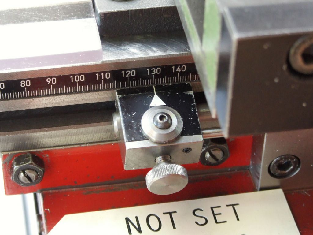

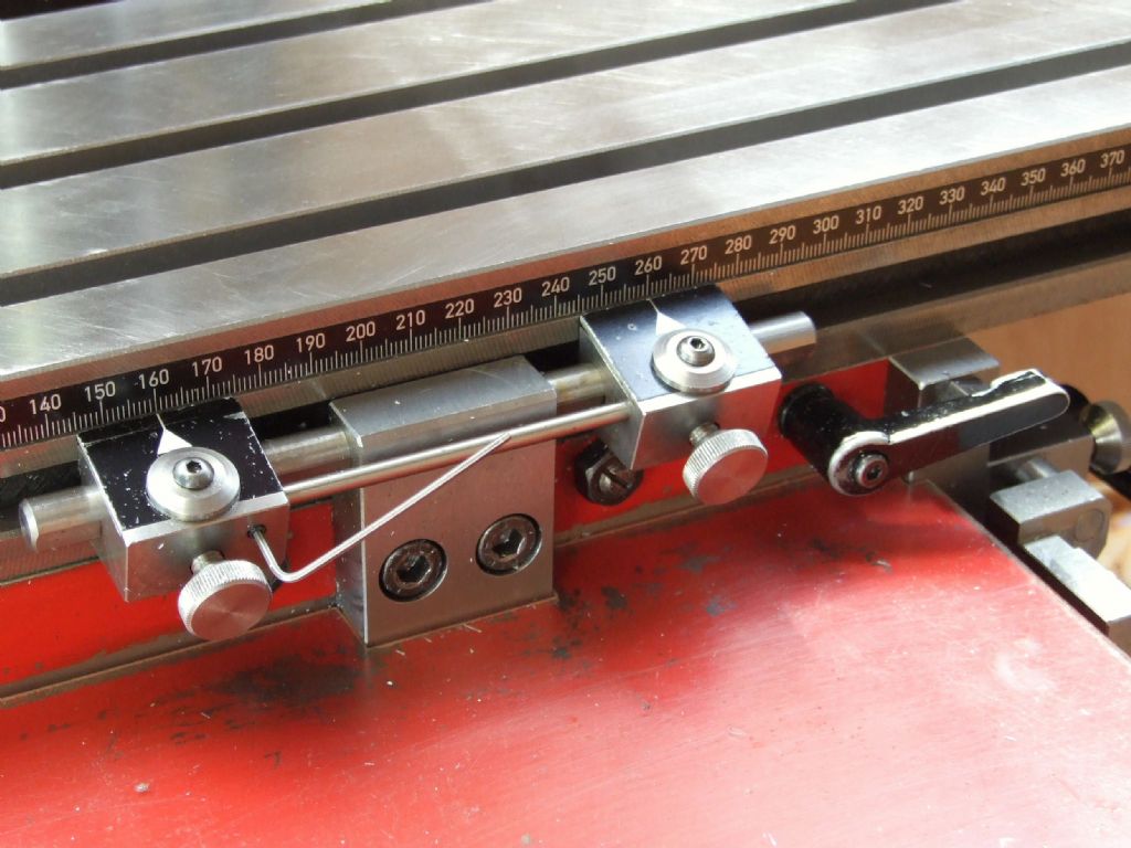

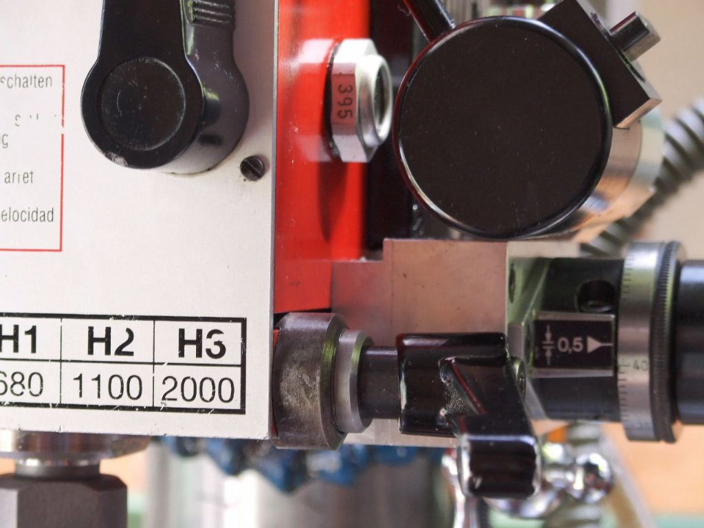

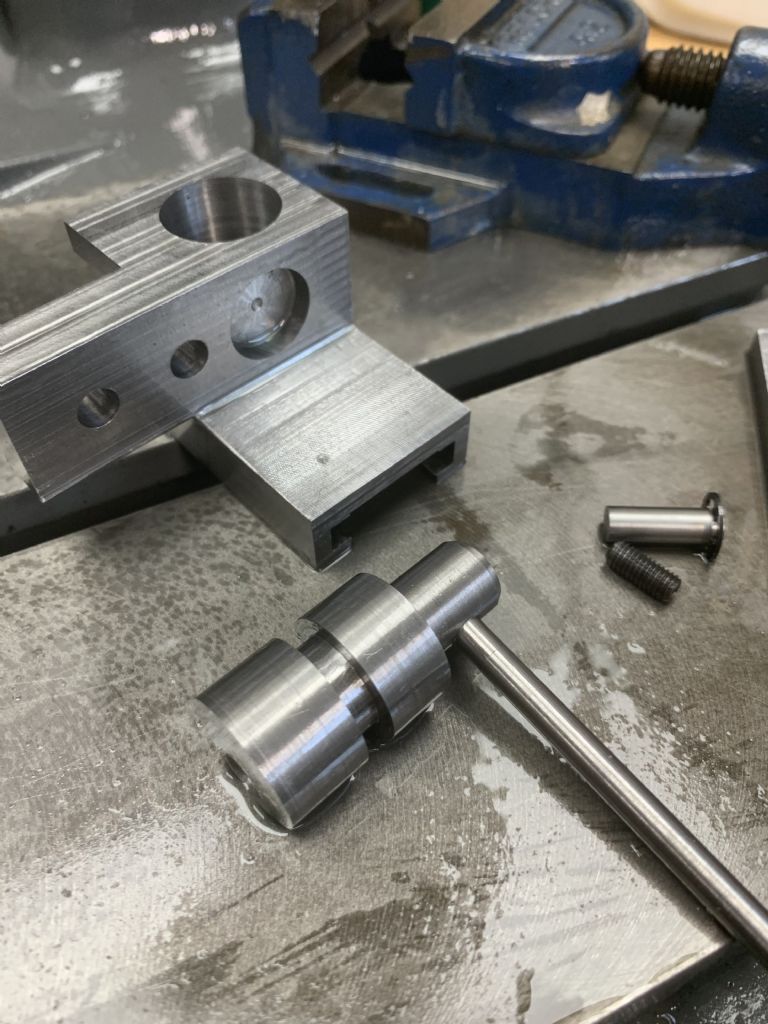

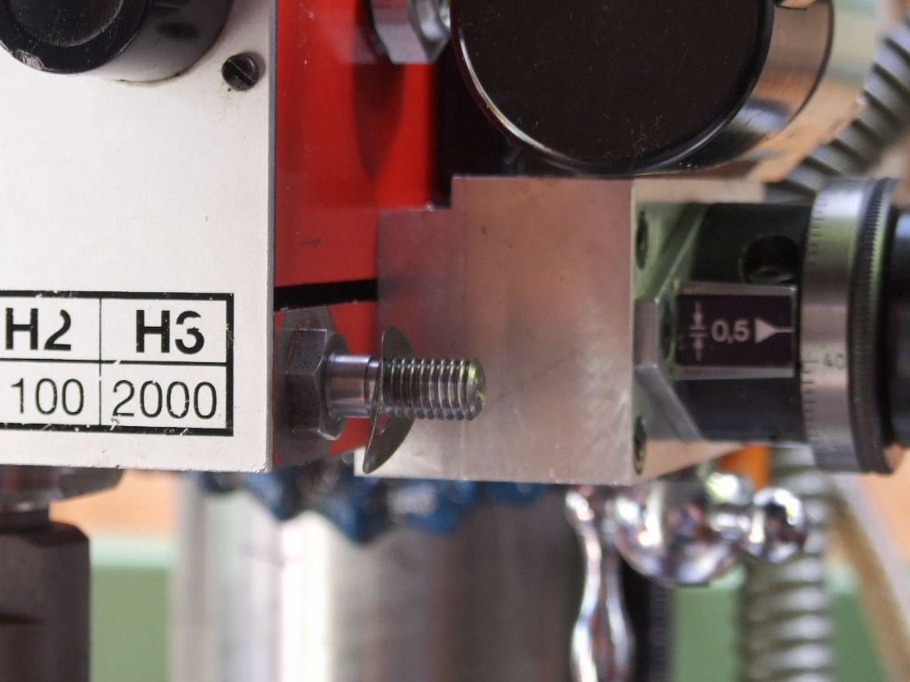

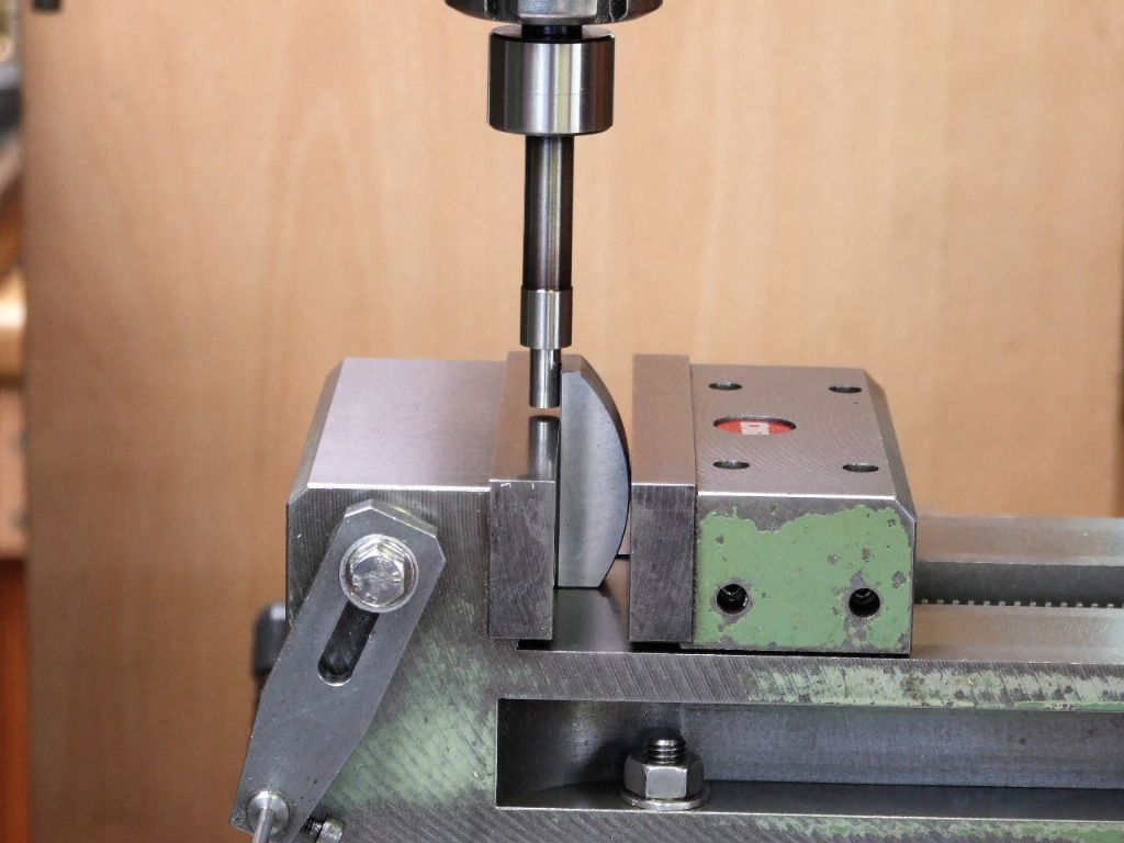

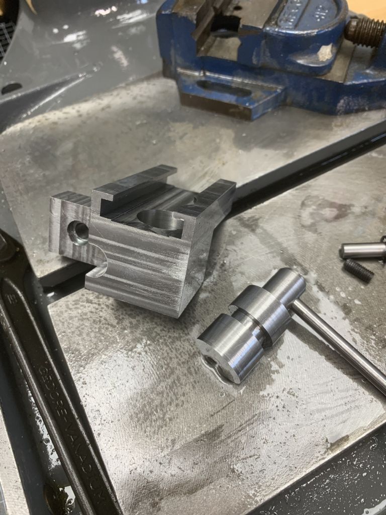

                                              As promised earlier here is a photograph of the Adjustable X-Axis Cursor holders. The Original one was obscured by the machine vice when in use. In all fairness to Emco this is I think due to the fixed jaw of the vice being parallel to the X-Axis movement. I have noticed the fixed jaw is often shown at 90 degrees to the X-Axis on the Continent. With the vice in this position it does not obscure the cursor.
                                              The reason for the two cursors is for visibility down each side of the vice. When one is covered the other is always exposed. When using the RT the Rt Hand cursor is removable so that the Lt Hand cursor can be transferred to the Rt Hand station. The Indexing plate of the RT fouls the cursor in the Rt Hand station and from memory It can mark the original Emco cursor set-up.

                                                While on the Rotary Table here are a couple of items I have made and which have proved useful over the years.
                                                The first is a Location Plug for the centre of the Table. This reduces the locating diameter from, (I think), 36 mm to 6 mm diameter.
                                                It also allows for an M6 hold down bolt in the centre of the table, (see set-up a few posts above). It needs careful construction as the table top surface and the Plug top surface want to be coincidental.
                                                The part was first roughed out and the M6 tapped hole put in from the bottom, about 2/3rds the depth. Otherwise the tap will ruin any 6 mm bored hole. As the outside diameter of an M6 tap is always plus on nominal size. The 6 mm bored hole, the finish turning of the location diameter, and finishing to length being done from the other side during the same operation.
                                                This is something I have been meaning to make for some time, but was only completed recently. While I have the Emco Collet attachment and Adaptor plate the setting up time can be protracted. There is one drawback with the Emco standard set-up which has cropped up in my career a couple of times and that is it is difficult to offset the standard set-up in order to machine a radius on a part which has an integral spigot.
                                                To this end the new attachment has a split location ring that can be removed should the need to offset the Collet holder arise again. It is also much quicker to set-up initially.
                                                Regards
                                                Gray,

                                                  One other thing relating to the Rotary Table, which I posted under my "Emco FB2 Earning its keep" post, last year, but something some of those following this post may not have seen. This is an extension handle for the Worm drive handle.
                                                  As can be seen from the first photograph the extension makes turning the worm drive handle much easier when the job or workpiece is overhanging the table. Note the 6 mm dowel locating the radius centre from the Location Plug.
                                                  Regards
                                                  Gray,

                                                    One annoyance I had with the Emco Quill clamping lever was its tendency to drop down without warning once the quill was released. This meant the carefully adjusted clearance for drilling was then lost. This combined with a dislike of using tapped holes in Cast Iron as part of the clamping regime.
                                                    Far better to have a stud in the tapped hole and some form of lever clamp on the open end of the stud or even a nut. The stud is far easier to replace than the tapped hole in the machine.
                                                    To this end I added the following modification. The stud with its fine thread for the tube nut allows the clearance to be preset and this is not disturbed once set. The clamping washer has a disc spring beneath it so that the lever stays put once released.
                                                    The first picture shows the simple version in the background with a De-Luxe needle roller thrust race version in the foreground. This has been the current set-up for some while.
                                                    The Vertical clamping Lever has also been changed to my preferred stud and lever system to which I have added another roller thrust race. Note that the thrust washer nearest the handle is the 2 mm thick option. Also in the photograph is the revised vertical clearance adjustment with nuts and studs, instead of bolts. These studs are a good fit in the stud hole so that they maintain alignment of the slider casting when any adjustment is made. The adjustment is made by the two shouldered nuts which have a 1 mm pitch thread and thus give the chance of a finer adjustment. All threads are screwcut to maintain concentricity and alignment.
                                                    Regards
                                                    Gray

                                                      I have been asked over the years about my way of working. That is do I mark-out components then centre popping and drilling any holes from this. For me, this is going the long way around, but I will readily admit some jobs do not warrant my way of working, or are just too big or complicated to mount on the mill.
                                                      All my work is done by co-ordinate location, the fixed vice jaw of the machine vice being set to Zero for the Y-axis. The Vice End Stop being the X-axis Zero. This way of working has other benefits when milling a component. Knowing the size of the cutter being used I can mill any up-stand or step to size without reference to my Vernier, simply by using my dials and scales on the machine.
                                                      Locating the fixed jaw face is done with the following little item I made many years ago from an mild steel off-cut.
                                                      The curved rear face of the bar stock ensures the flat face is up against the fixed jaw. A tipping moving jaw combined with a rectangular block could give a false reading. Due to the tipping moving jaw making the rectangular block cant over to towards the moving jaw.
                                                      Three for the price of one here, first the edgefinder set-up, the edge-finder is again home made.
                                                      Secondly the two holes in the moving vice jaw are M5 tapped holes. A Delrin plug and M5 grubscrew lock the moving jaw slide adjustment screws. The moving jaw adjustment lasts a lot longer with this modification.
                                                      Thirdly is my vice stop for locating similar components in the vice with reference to the X-axis. To locate longer components I have an extender stud which screws into the same location and the stop screws into this in the same way as it does the vice.
                                                      Under the head of the M6 hex-headed bolt is a Disc spring washer which allows the stop to be un-clamped and adjusted without fear of the stop dropping due to gravity, while I locate the M6 spanner. The disc spring also keeps swarf out from the interfaces by keeping them in contact. The 3 mm diameter silver steel rod is housed in a split bush which is retained in the stop by a circlip. The fit is extremely good and the head of the split bush is on the thrust side of the stop. The locking screw is an M4 capscrew which means the same 3 mm Allen key used to adjust the machines Quill depth stop can be used to lock the vice stop. One less item to have to locate, (had I used an M4 grubscrew this would need a 2 mm key).
                                                      Regards
