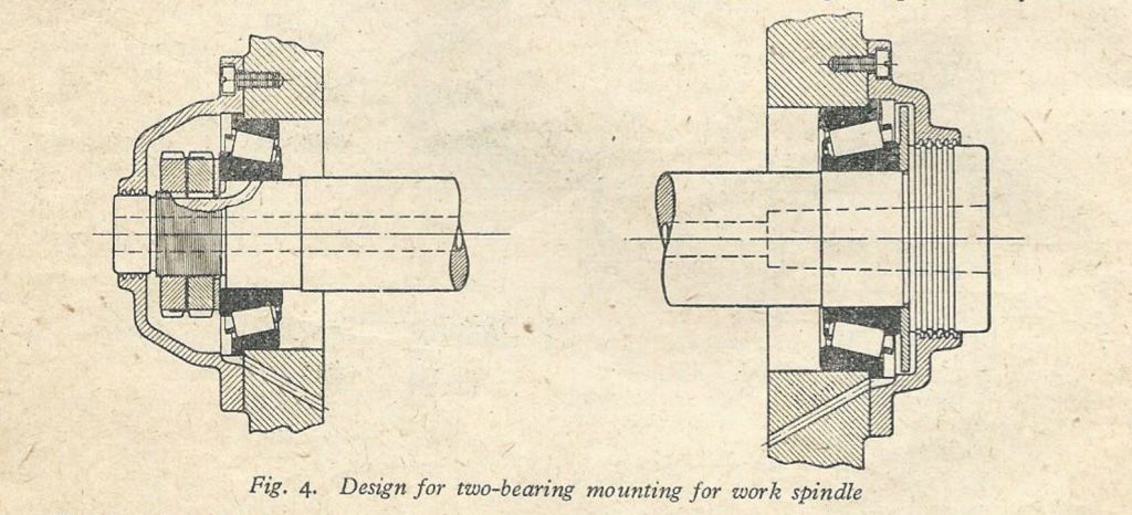

                      #317988
                        This doesn't seem right at all.
                        The bearing arrangement is essentially that drawn on page 2 of the document you can download here:
                        http://www.model-engineer.co.uk/news/article/lathe-bearings/19136
                        If you have longitudinal movement, then you should be able to push the spindle to the left and take up the slack with the c-spanner.
                        If you can't take up play by adjusting the bearing then either the bearing is stuck OR have assembled it incorrectly so the c-nuts are not contacting the bearing.
                        Leather mallets should not be needed.
                        If the bearings are not seated properly, they will move as soon as you use the lathe in anger., Stop, readjust the preload and continue…
                        The hard plastic spacer is more than man enough to apply preload to the roller bearings, I think they actually need rather less than the original ball races. Shortening it is not a big issue, it needs to be about 1cm shorter to make sure the bull wheel is correctly aligned. At a push you could cut it with a junior hacksaw and finish it by hand.

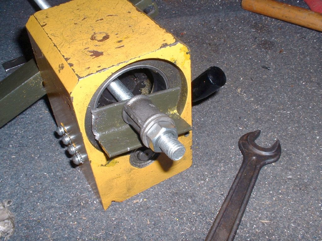

                          #317992
                            How to press the bearing into place without a press. Run some allthread through the headstock with a bar right across thee headstock at one end and a shorter bar across the bearing. Tighten carefully making sure you keep the bearing dead square. This is a roller bearing outer but it works with ball races as well. The bar needs to be long enough to put the load on the outer race.

                                                  #318084
                                                    Or see the link I posted earlier which has plain advice from Timken aimed at machine tools with beautiful drawings.
                                                    smiley
                                                    #318087
                                                      Posted by Neil Wyatt on 22/09/2017 07:20:31:
                                                      smiley
                                                      Indeed … and here, for quick reference is the relevant one:
